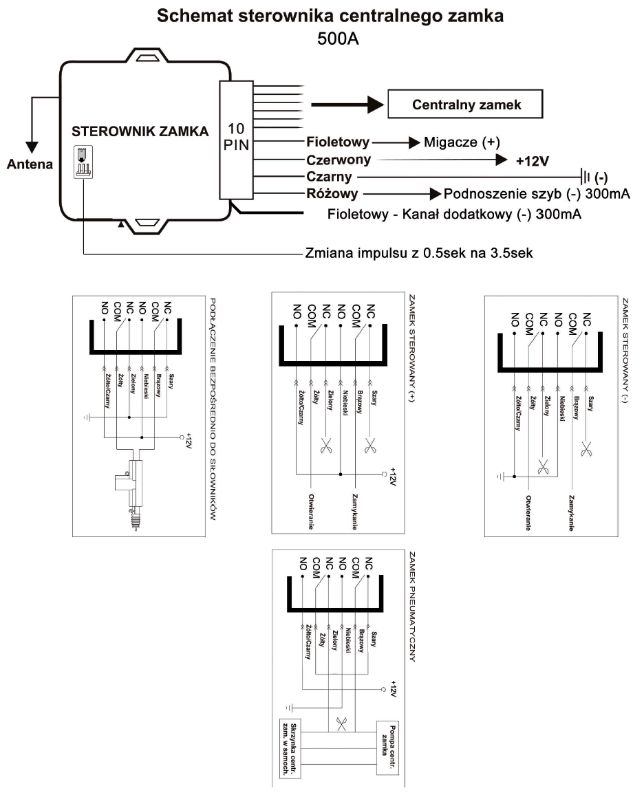

    Hello. I want to connect a universal central locking controller. For those who write that there is a search option, I found a lot of topics and I know where the plus and minus is in the cube, as well as not one downloaded the scheme. But I am looking for such a pathological description under which pin or color to sign opening, closing and turn signals in the ankles from the original central lock astra g year 98 combo. And can I also sign for closing the windows? If so, also where? I would rather write a topic than bad solder and write over time.

    I have a universal scheme that wants to mount, only needs information in which I have to plug into closing, opening, directions and possibly windows to which knives I am sure because the original Astra control panel is without alarm. The original diagram in the attachment

    Now I'm at work but I found the same diagram in Google. Why do you need a universal controller scheme? As I'm interested where is what's in the original
    • Connecting a Universal Central Locking Controller to Astra G '98 Combo: Pin & Color Guide 9748700400_1489832588.png (256.94 KB) You must be logged in to download this attachment.

    Connecting an additional controller to the original:
    The additional controller should be connected according to the "controlled lock (-)" scheme, and then the brown wire should be connected to the red and white wire in connector X61 of the original controller and the yellow wire to red and white in connector X61.
    Connecting instead of the original driver:
    The additional controller should be connected according to the "direct connection to actuators" scheme and the brown wire should be connected to the black and red wire in the connector X62 of the original controller and the yellow wire to the black and yellow in the connector X62 and the black and blue in the connector X61 (in the case of reverse operation, change places brown and yellow wires).
    To close the windows you need to make an inverter on the relay changing the signal (-) to (+), and then connect it to the red-yellow wire in the connector X61 of the original controller.

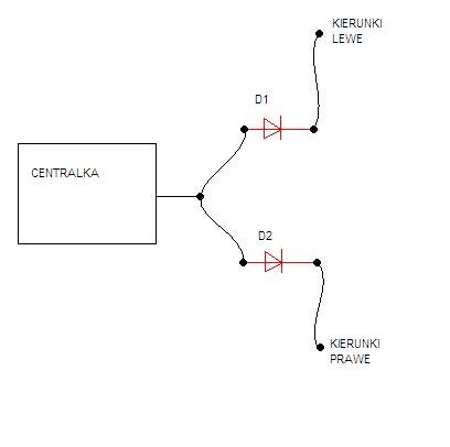

    The flashers should be found in the main bundle black and white and black and green wires with a cross section of 0.75 mm2 and connect to them using rectifier diodes.
    Power can be supplied from brown (-) and red (+) 2.5 mm2 wires in connector X62.

    Unfortunately, because connecting the universal controller instead of the original one does not work closing and opening.
  • #9 17261467
    bubu1769
    Posts: 8063
    Help: 1177
    Rate: 2374
    Have you connected the yellow wire to both black and yellow wires in connector X62 and black and blue wires in connector X61?
  • #10 17263490
    czkawka2012
    Posts: 19
    Rate: 7
    So I added a lead so that both were fastened to yellow and I also tried without anything
