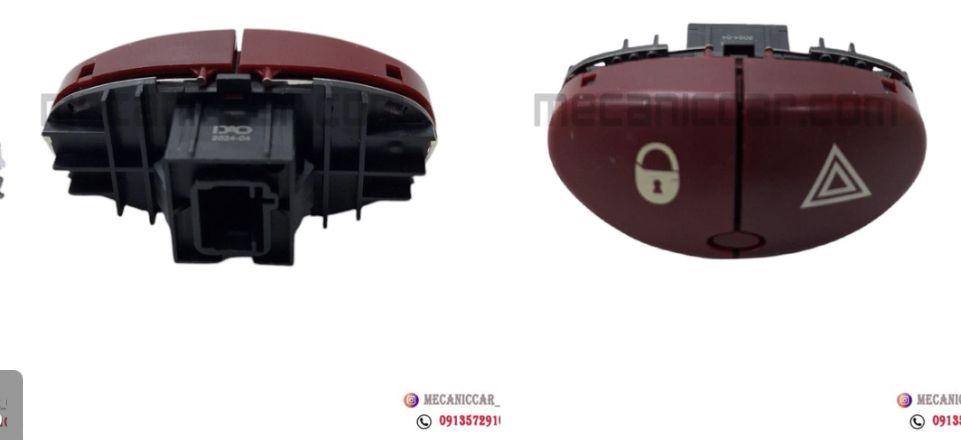

  • #9 21433732
    faredza1444
    Car switch with lock and warning triangle icons.
    hi I want to install this thing to on my 206 2000
    how can I do it?
