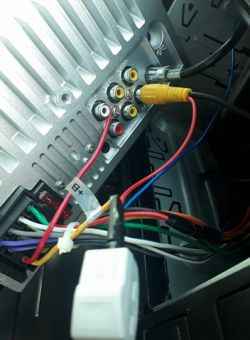

    I bought a 2din 7010B radio 2din 7010B Radio Backlight Fluctuations: Brightness Inconsistency & Microphone Connection Queries
    Everything is obviously well connected but there is one problem.
    At a standstill once it lights up brighter and once it lights up dimly, and when I drive a car the same situation once it fades once more strongly. I heard that it depends on the dimmer in the car on the left side of the steering wheel but I do not know how to do it and which is the cable from the backlight at all.
    And one more question if it is possible to connect another microphone to it because the one on the radio is too weak: /
    I put a photo of the radio from the back regarding the connection of the microphone.

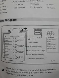

    The cubes are not described but I add a picture: 2din 7010B Radio Backlight Fluctuations: Brightness Inconsistency & Microphone Connection Queries
    It is fitted to the first generation Skoda SuperB.
    - yellow cable is for reversing camera (B +)
    -Red is connected to the mass of the radio, so that you can watch MP4 while driving (without Video Warning)
  • #6 17254265

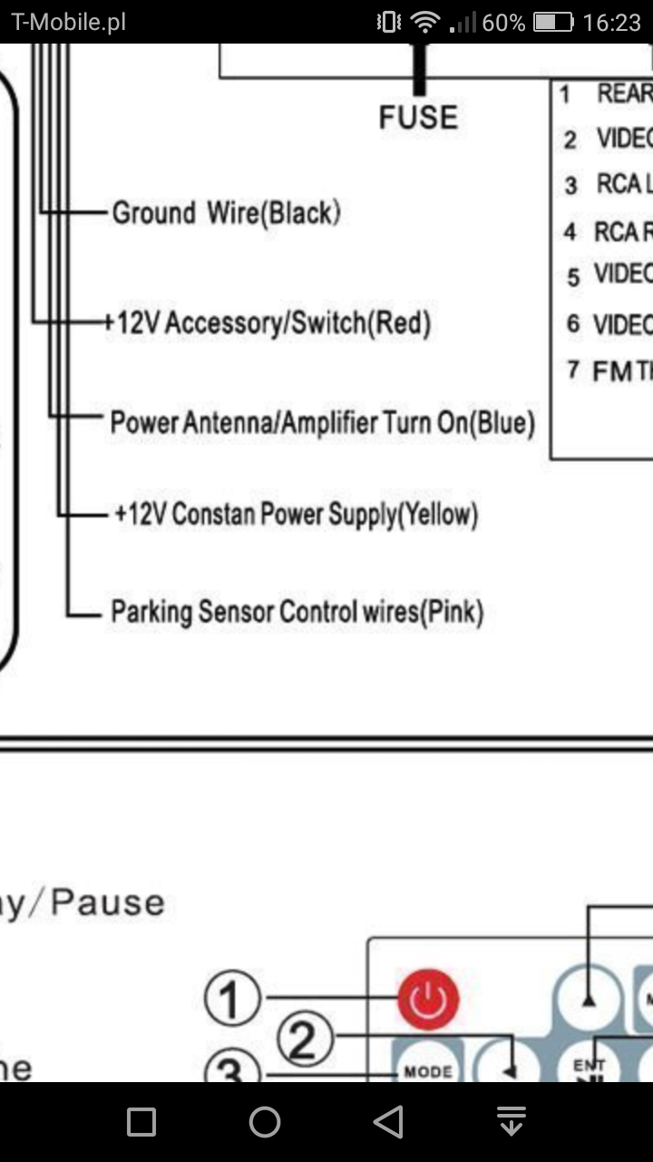

    Here is the cube diagram: 2din 7010B Radio Backlight Fluctuations: Brightness Inconsistency & Microphone Connection Queries
  • #12 17254324
    piotrek22101
    Posts: 3323
    Help: 695
    Rate: 1411
    Board Language: polish
    Where is the backlight in this description? There is only weight with manual and reverse, and steering from the steering wheel.
    Anyway, this red one should be connected to the ground cable from the car installation, not to the screw. According to the ISO standard, this is the main mass.

    Supply voltage drops after switching on the lights or radio defective.
    Good point. Probably now the radio is taking ground power on the antenna cable which is unacceptable and may cause the described symptoms.

    I will connect as you wrote this cable, not under the screw, but under the ground and we will see what will happen :)
    Of course I will share the information.
    Ed. I did as you said, i.e. this cable with a screw to ground and certainly improved the quality of FM and the issue with backlight I will see at night what will happen now, thank you for now :)
    Added after 19 [hours] 7 [minutes]:
    The backlight at night keeps flashing or does anyone know how to solve it?
