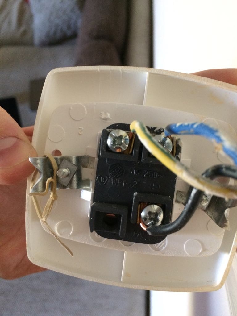

    Currently, I have a double switch in the living room, which supports two chandeliers, one bulb.
    It has 4 terminals: PA (black), B (empty),? (blue), 2 (yellow-green):
    Installation of the light switch - MI Aqara Wall Switch Xiaomi
    Here is my question. Is it possible to connect it or did I purchase the wrong switch model and it does not fit my installation?

    The switch needs a phase and neutral wire and only the phase probably reaches the box and two wires go to the chandelier
