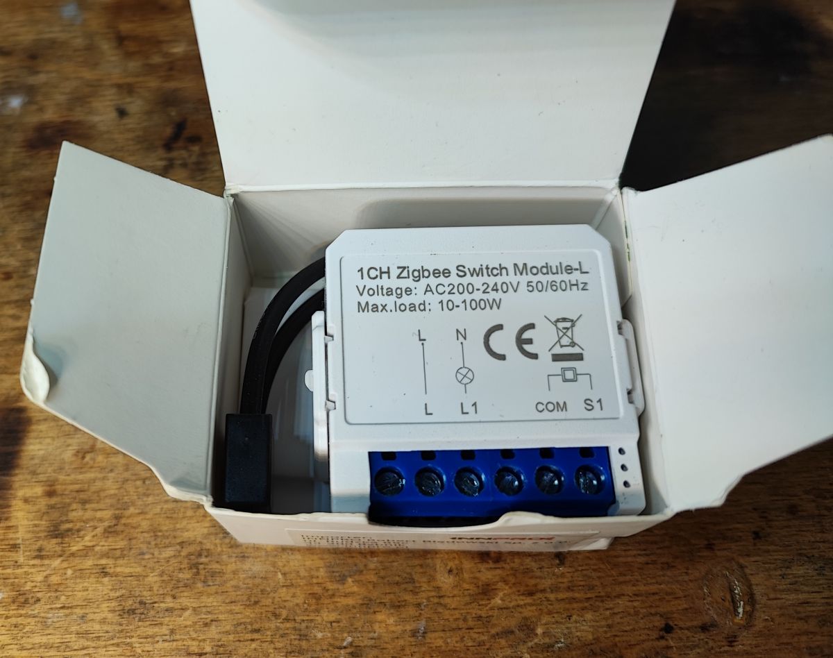

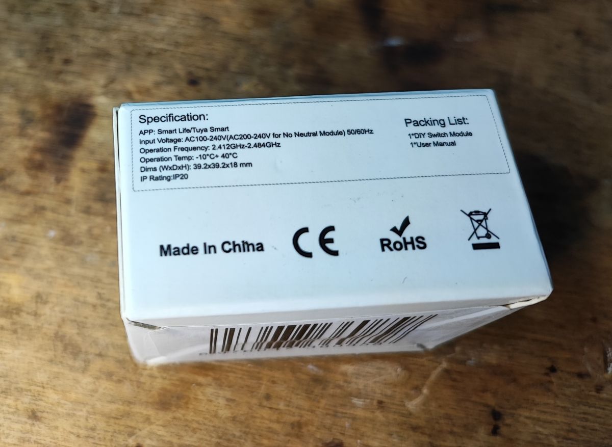

    The LZWSM16-1 is a single Zigbee-controlled 'relay' module measuring 39x39x20mm, it works with a classic switch and does not require a neutral wire to operate, so it will probably find its place in many a box. The whole thing normally works with the manufacturer's gateway, but it is also supported by Zigbee2MQTT, so you can pair it with Home Assistant.
    In our country, this gadget costs around PLN50.
    We receive a box like this:
    Box of Avatto LZWSM16-1 product on wooden background Back of the LZWSM16-1 relay module box with technical specifications. A box with a printed barcode lying on a wooden surface. Zigbee switch module LZWSM16-1 in a white box. .

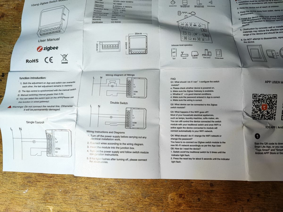

    This black component is a capacitor, also referred to as an "adapter" by vendors - I don't know why, I don't like this name. The instructions explain where it is fitted:
    User manual for Zigbee relay module LZWSM16-1. Zigbee switch module LZWSM16-1 user manual on a table. User manual for Zigbee module LZWSM16-1 with wiring diagrams. User manual for Zigbee switch module. .
    So, we connect according to the instructions and pair.

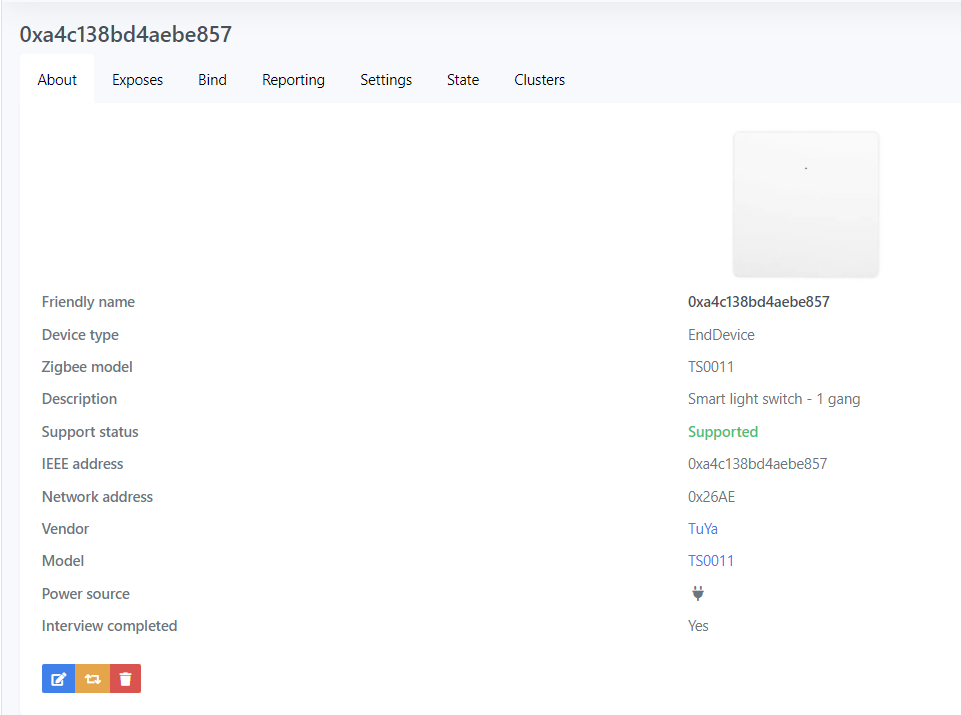

    From this point on, we can already see its data:
    Configuration page of Zigbee device TS0011 in software. .

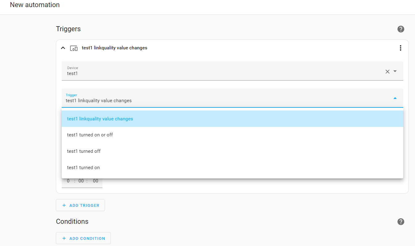

    Of course, automation can also be based on this - e.g. switching this switch triggers another switch.
    Configuration interface for automation in Home Assistant. .
    HA sees this product as TS0011.

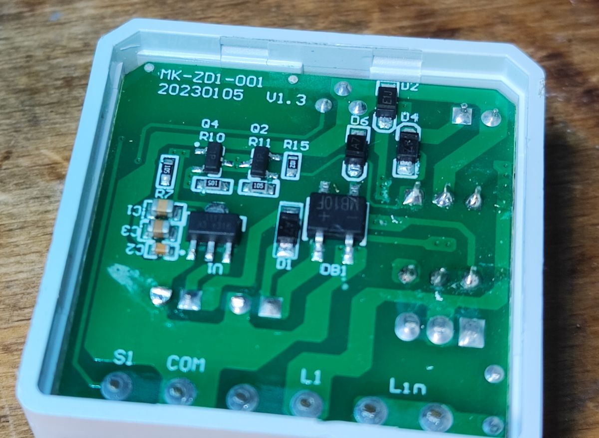

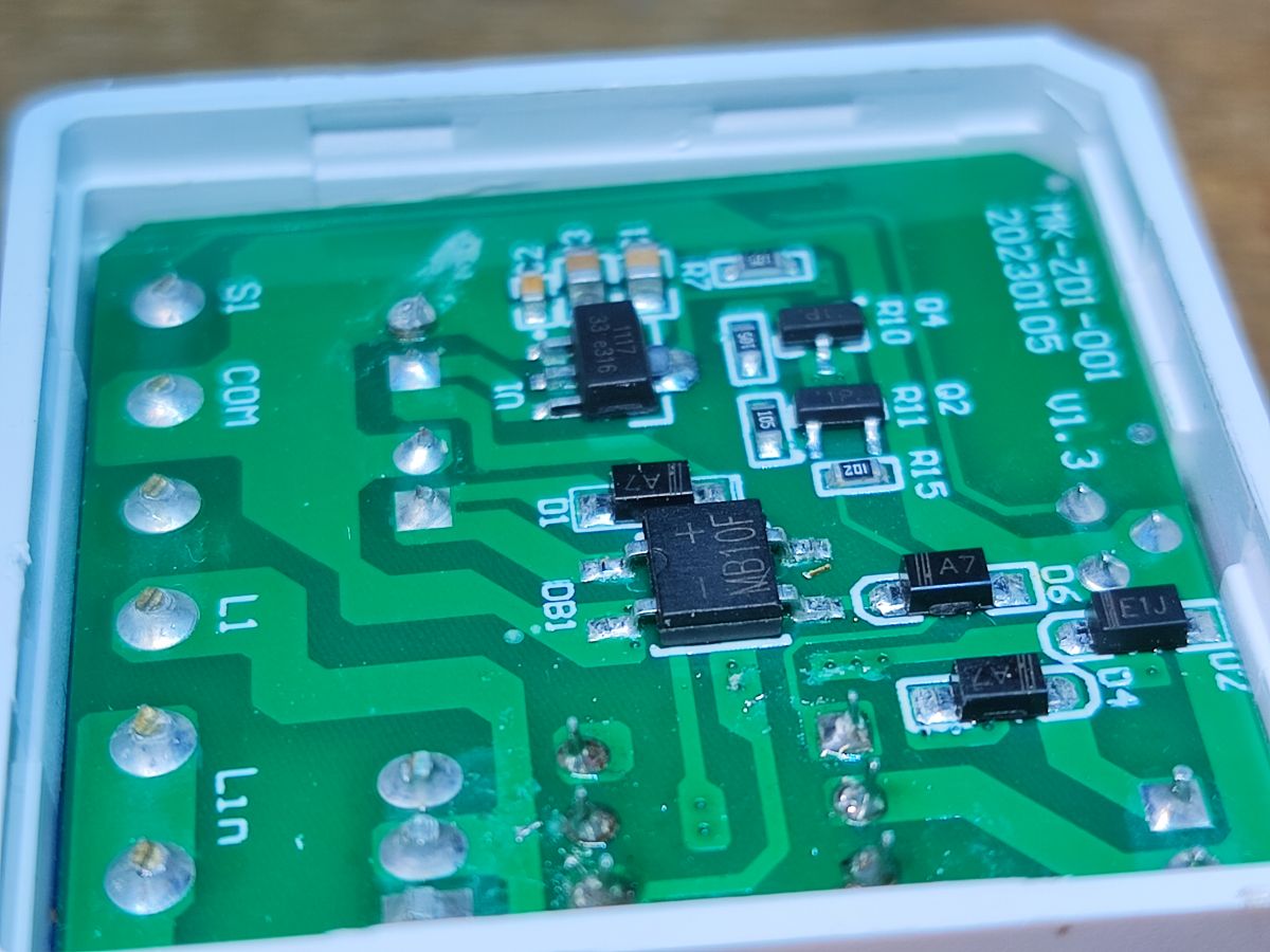

    Just out of curiosity, this is not needed to pair with Home Assistant. Let's undermine the catches.
    Close-up of the bottom side of a printed circuit board labeled MK-ZD1-001, version 1.3, featuring various electronic components. Close-up of the LZWSM16-1 module's printed circuit board. Close-up of the PCB of the LZWSM16-1 module. .

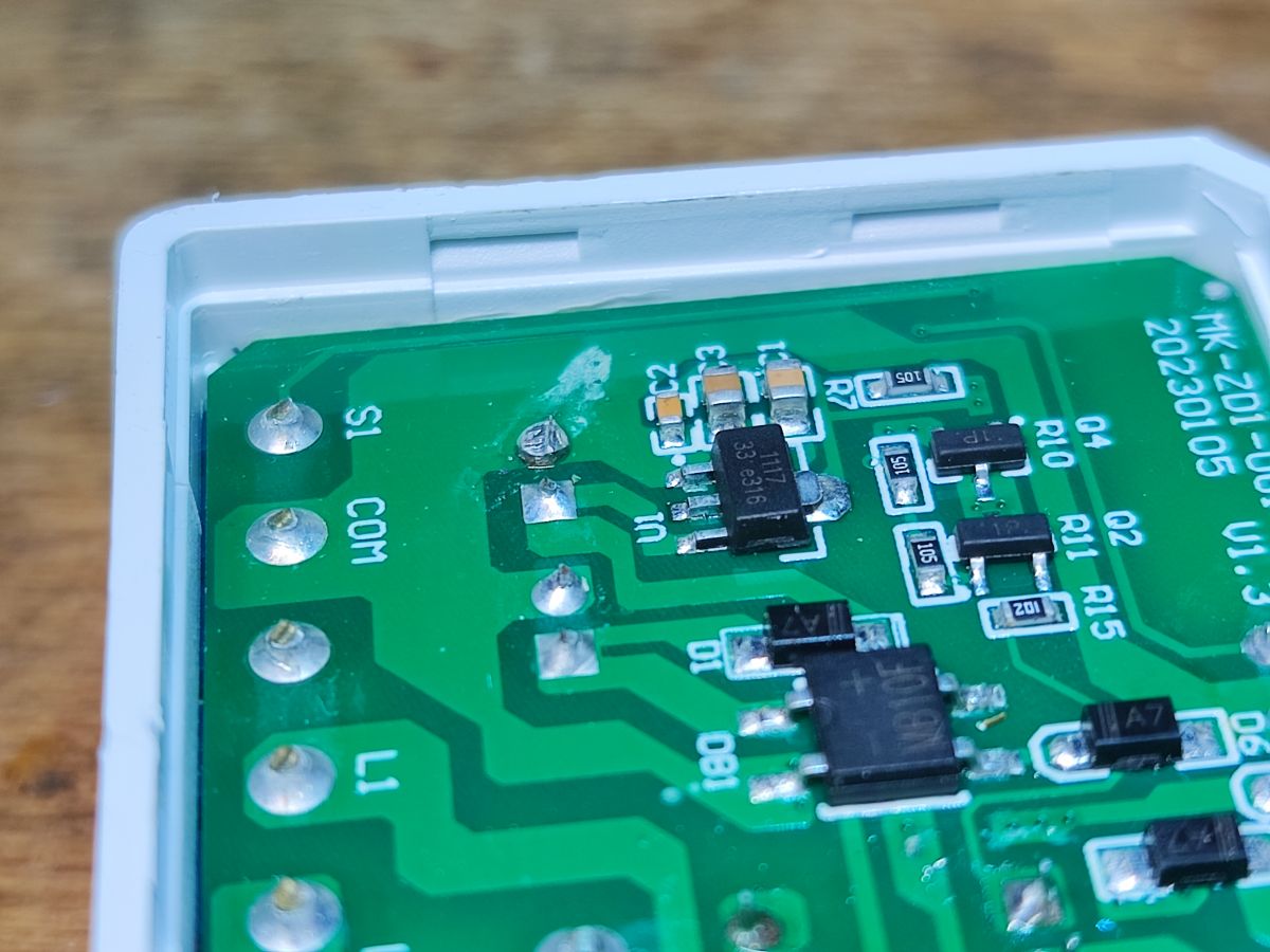

    PCB designation: MK-ZD1-001, data 20230105 V1.3
    On the board I can see so far a rectifier bridge and an AMS1117-3.3V LDO regulator....
    PCB inside Zigbee module with electronic components View inside the Zigbee LZWSM16-1 module with electronic components. Close-up of the Zigbee LZWSM16-1 module PCB with capacitors and other electronic components. Electronic module with visible capacitors, integrated circuits, and markings. Close-up of the LZWSM16-1 module's circuit board with visible electronic components. .

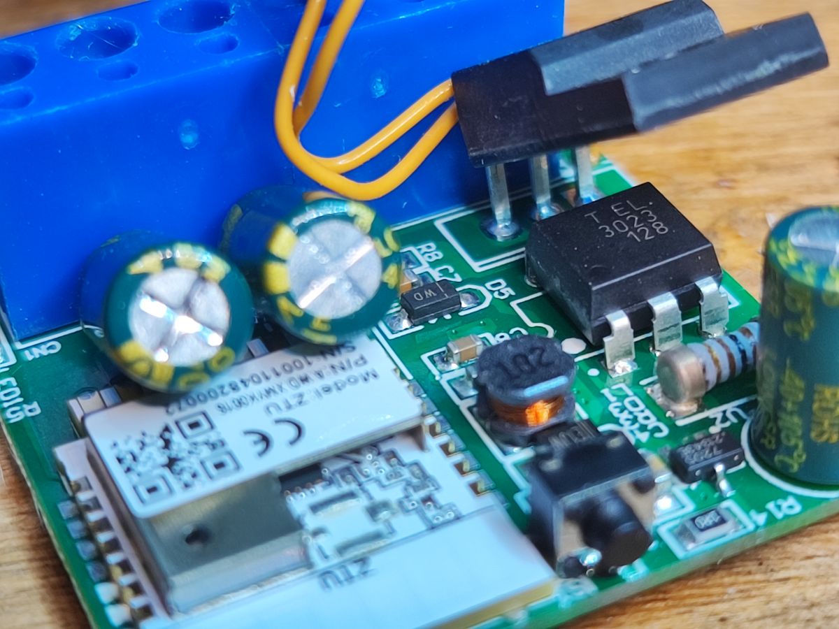

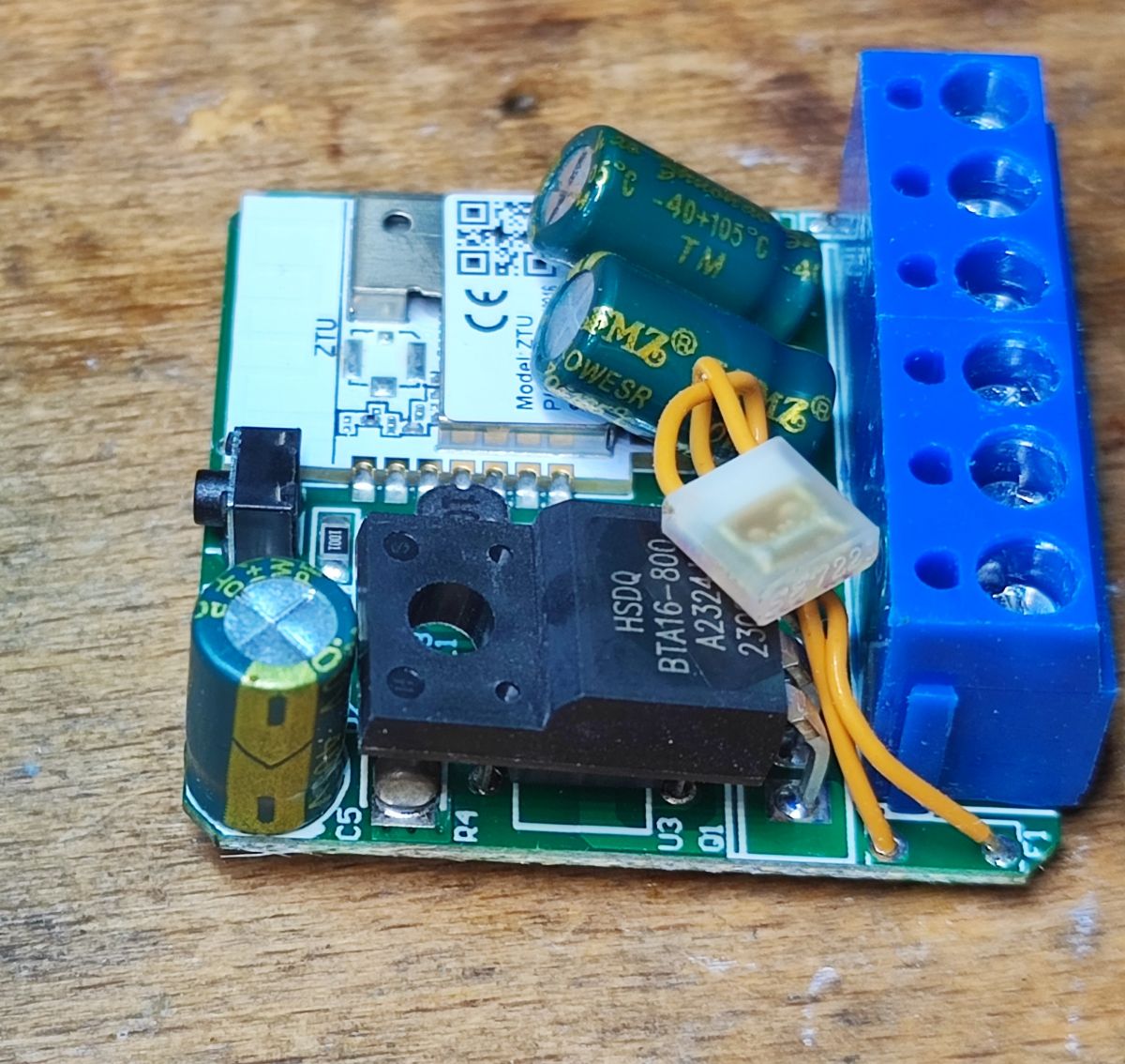

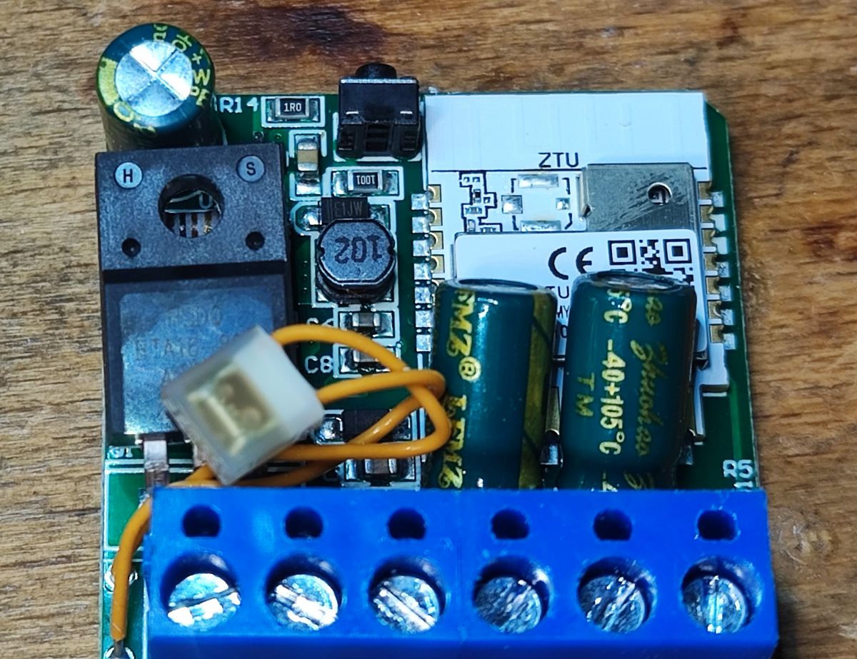

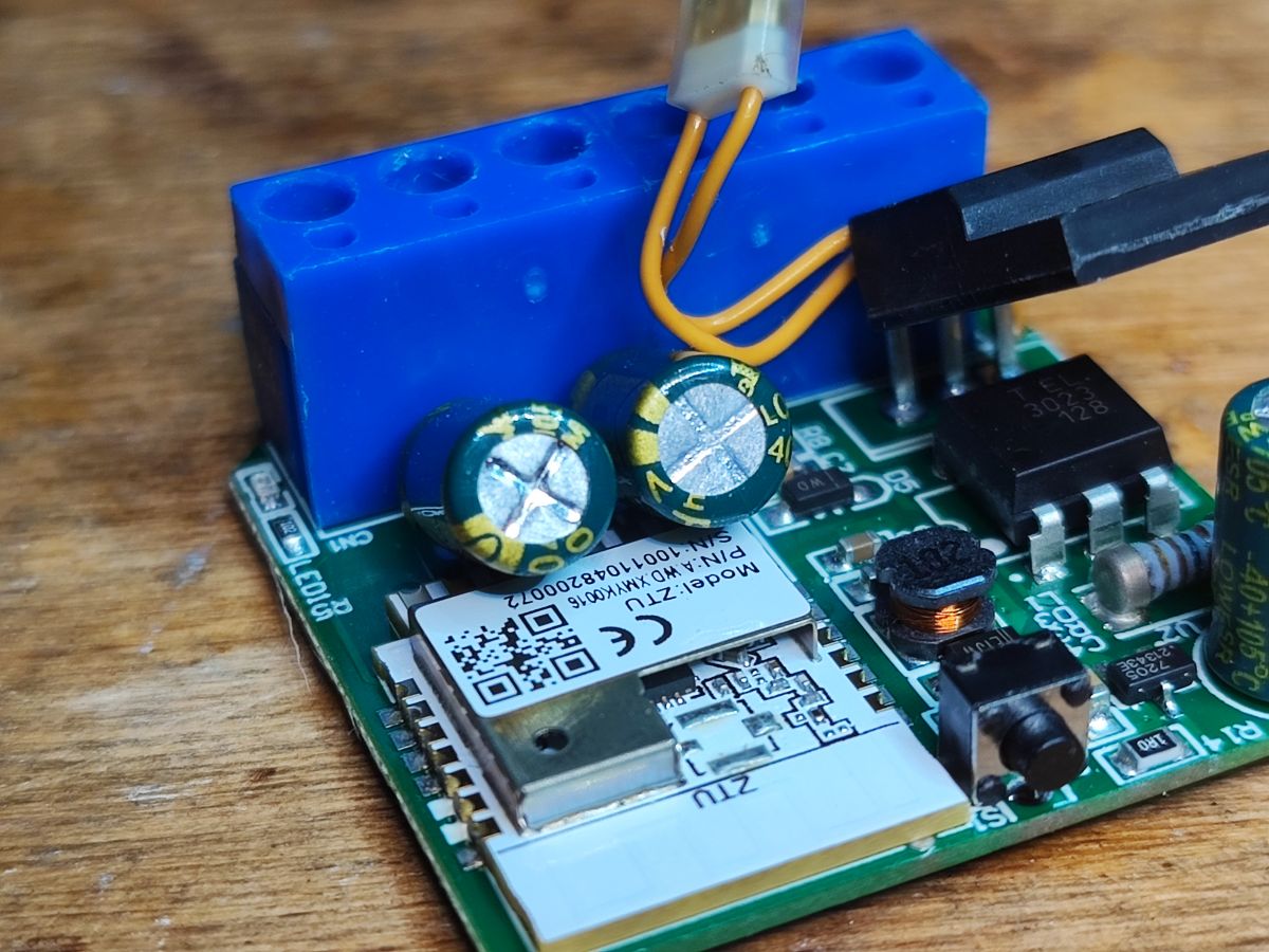

    The other side of the PCB is much more interesting. There is no relay here! Well, basically, it was already clear from the label itself that this is not implemented on a relay, as evidenced by the maximum load of up to 100W. The whole thing is based on a BTA16-800 triac controlled by an EL3023 optotriac. I was also interested in this fuse - why is it on such long wires? Apart from that, inside I see something that resembles a step-down converter, but I haven't analysed it thoroughly. The module itself inside is a ZTU (32bit CPU, 1024KB flash , 64KB RAM), or Zigbee from Tuya:
    Diagram of the ZTU module with Zigbee. .
    The module format reminds me of the CBU on the BK7231N and I have seen similar products (equivalents of the one on WiFi) based just on the CBU, the rest were similarly built.
    Summary .
    Basically I was expecting just this type of design in the middle. It is often found in solutions operating without a neutral wire connection, plugged into the phase wire itself. Also by the sheer power of the load (up to 100W) you can see that this is not just a simple relay.

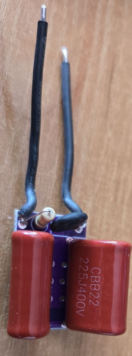

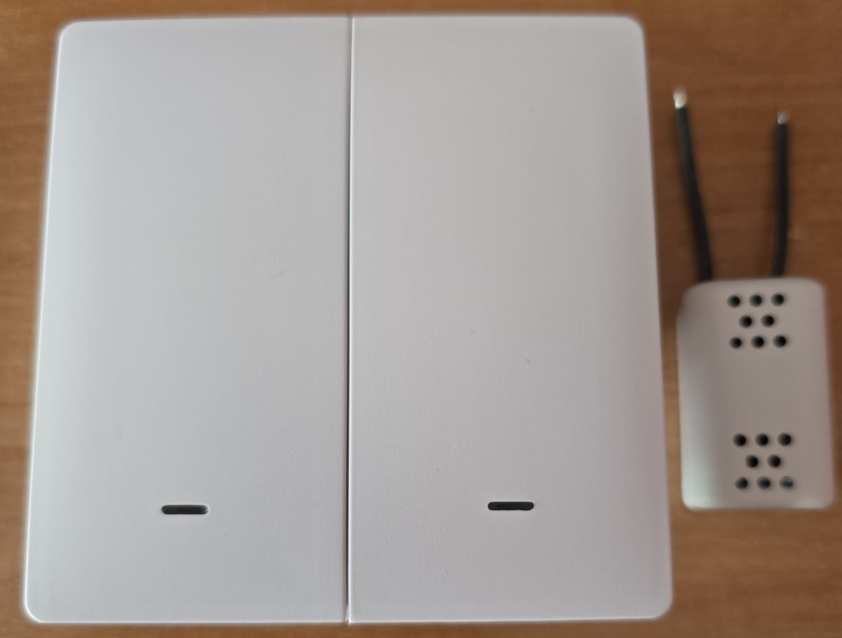

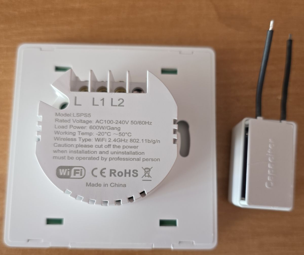

    A device without N, and they did without a capacitor?
    Double white light switch and a switch with two wires without a capacitor. .
    LSPS5 device with capacitor next to it.
    Close-up of a small electronic board with two red CBB22 capacitors rated at 400V. .
    Close-up of electronic components on a circuit board, including an NTC thermistor, a resistor, and capacitors. .
  • Black capacitor included; asks about LSPS5 source
    #3 21506596
    Posts: 14767
    Rate: 12906
    There is a capacitor included, you can even see it in one of the photos, only it is black and the lighting just happened to be low.

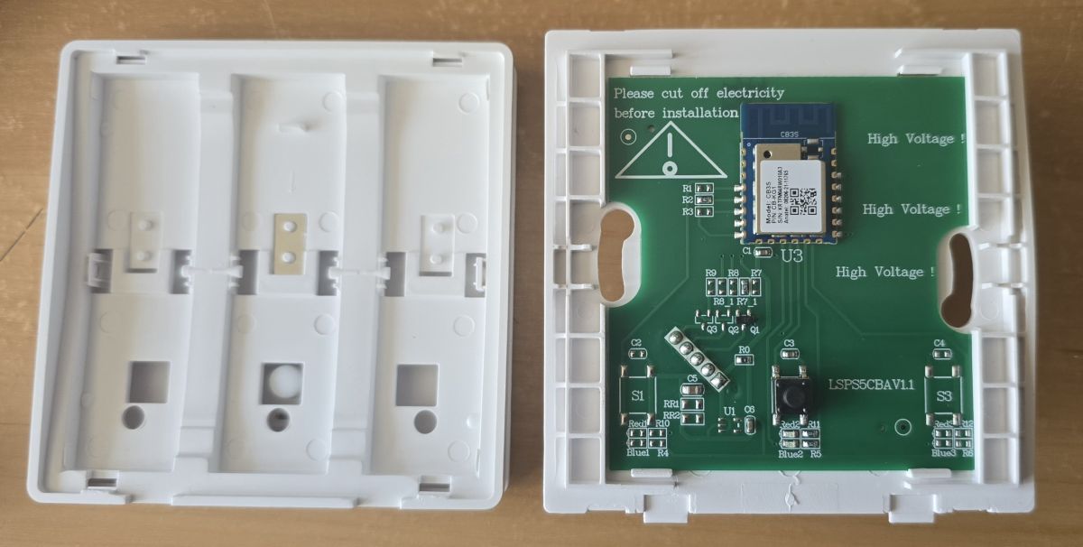

    Where did you buy the LSPS5 you showed? Is it also on a BK7231? It was already on the forum:
    Switch LSPS5 (BK7231N) restarts when button 1 is switched - problem with dr board .
    I ask because we had a question in another topic about some on/off switch (not dimmer) what doesn't make noise: https://www.elektroda.pl/rtvforum/topic4103835-30.html#21500887

    As it happens in my case, aliexpress.
    Here the single button version.
    Switch enclosure and printed circuit board. .
  • LSPS5 already listed on OpenBeken devices list

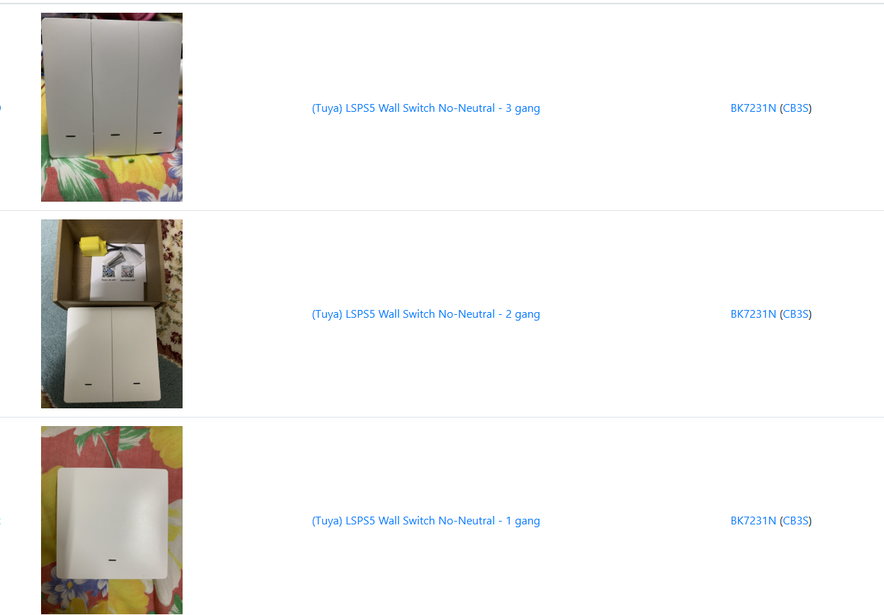

    This is exactly what colleague @omaxp was looking for in the linked thread . Do you happen to have a copy of the BK7231 batch?
    Although I have now checked .... and the LSPS5 is already on the Electrode list:
    Three photos of Tuya LSPS5 wall switches without a neutral wire, showing different variants (three, two, and one gang). .
    I don't think much has changed inside, I see there was an LSPS5CBAV1.0 version in 2022 and you have LSPS5CBAV1.1
    https://www.elektroda.com/rtvforum/topic3934363.html#gallery-8
