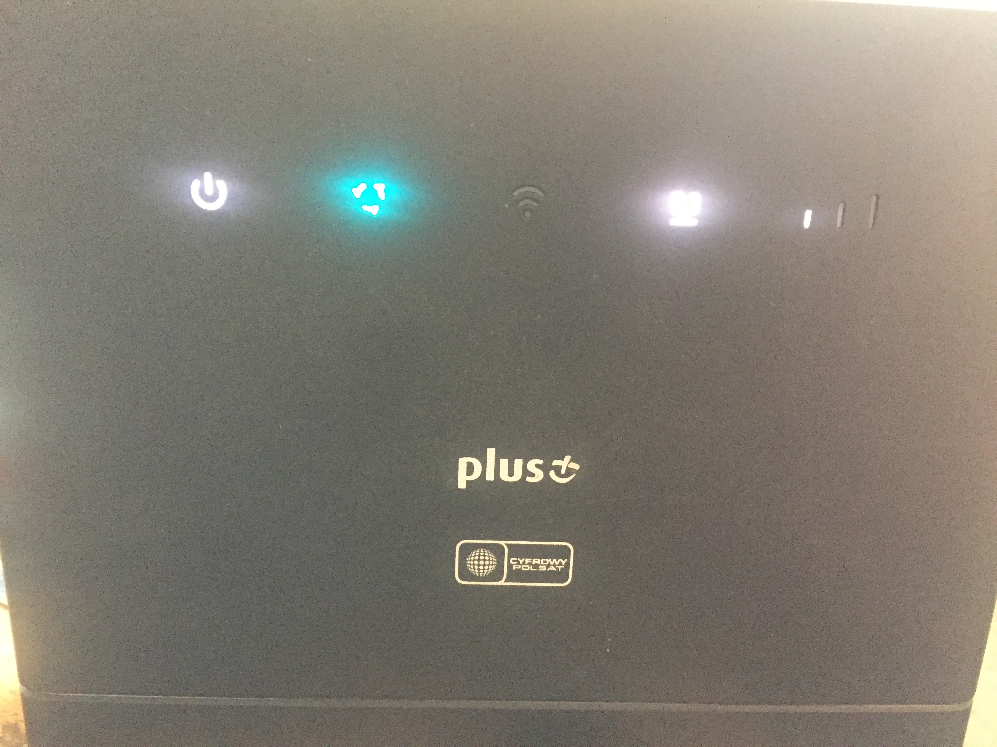

    Hello, there is such a problem I have a Huawei b315 Router and everything was Ok, later I did not use it for a long time and now I wanted to use it, I inserted the card into the router and turned it on and here there is a problem because I do not have Wifi and the router does not light up the WiFi LED . I thought that the diode could burn and the signal could be but there is nothing I also tried to reset the router probably three times or nothing, I have no more ideas will you help me? Still in the margins I connected it to a laptop and made router configurations and it also did not help

    And in the router router panel is turned on?

    Added after 14 [minutes]:
    Here it gives pictures like something
    • Huawei b315 router I have trouble with wifi because it doesn't work in my ro 7768141A-CA30-4591-891E-005E827DBA53.jpeg (1.35 MB) You must be logged in to download this attachment.
    • Huawei b315 router I have trouble with wifi because it doesn't work in my ro 4ECC9A6D-2413-4C2F-A598-C65939524C4F.jpeg (1.73 MB) You must be logged in to download this attachment.

    In the settings find and restore default settings. WiFi in the panel appears as enabled.
  • #7 17266637
    Krystian7363
    Posts: 6
    I did it, it restored the router to factory settings but nothing worked, I still don't have a wifi signal or the LED is unlit, there is nothing I can do

    It is normal that in 90% of locations in Poland there is a weak LTE signal, especially in Play. Therefore, external antennas are used, but another 90% of users count on a miracle instead of buying and using a proven directional antenna. In Play on B315 you must first check all LTE bands, LTE signal parameters on them, BTS CID and speed. In addition, do not mix the range of Play voice offers because they use national roaming in LTE (Orange and Plus) and on 3G from three operators (DL limited to 3Mb / s) with Internet tariffs that work only on the LTE and 3G Play home network. And WiFi in B315 probably fell since the management panel appears as enabled. Router under warranty?

    Then you can connect another router as an AP to it, or buy another one.
