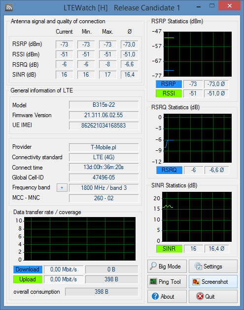

    It's not an antenna, it's some kind of broadband monster. Enter the location, do you have 1 km to the BTS LTE800T-mobile? It is not possible for you to have 95Mb / s in the LTE800 T-mobile band, the operator uses 10MHz (or 5MHz) in MIMO and DL theoretically up to 75MB / s (37.5Mb / s). Such speed is possible on the unloaded LTE1800Networks BTS where there is 15Mhz bandwidth in MIMO. Nobody is interested in the range in lines. for signal diagnostics, BTs identification and LTE band forcing, the castrated B315 programs are used: http://www.lte-anbieter.info/ltewatch/count_huawei.php?Datei=ltewatch_h or https://dl.dropboxusercontent.com /u/1978345/E5186/E5186%20Toolbox_latest.rar Force LTE800 and LTE1800 in them one by one, show screenshots, do speed tests. Of course, without this monster on the router itself.

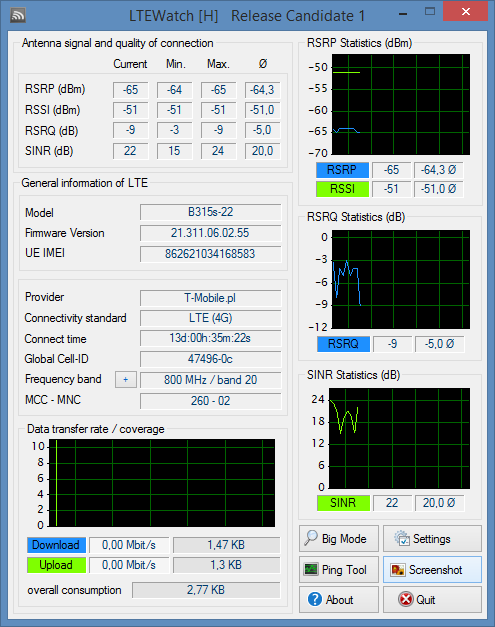

    Speed test
    Lte with external antenna disappears. - Huawei B315 and LTE antenna - coverage d
    Lte with external antenna disappears. - Huawei B315 and LTE antenna - coverage dLTEWatchH_....25.59.png (40.91 kB)You must be logged in to download this attachment.
    Lte with external antenna disappears. - Huawei B315 and LTE antenna - coverage dLTEWatchH_....29.15.png (41.92 kB)You must be logged in to download this attachment.
  • Compare LTE800 and LTE1800 performance and enable LTE-A aggregation

    Both LTE800 T-mobile and LTE1800NetWorks work on this BTS. This broadband crap makes the B315 jump in between. Check the signal and speed parameters of LTE1800 and LTE800 with this antenna, show screenshots. These 50Mb / s in what LTE band? Force bandwidth that's faster and take advantage. Obviously you made the mistake of taking with the T-mobile B315. Due to the fact that there is LTE1800 and LTE800 on BTS, you can use the aggregation of these two bands and LTE-A. But for this purpose, you had to take the B525, i.e. a router with LTE-A. It is possible that it would be faster on LTE.

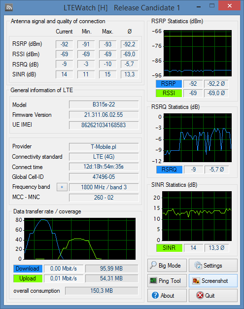

    Speedtests came out differently - from 25 Mb / s - 85 Mb / s
    LTE Watch results were made when speedtest showed 45Mb / s download
    Lte with external antenna disappears. - Huawei B315 and LTE antenna - coverage dLTEWatchH_... 45 mb.png (40.5 kB)You must be logged in to download this attachment.
    Lte with external antenna disappears. - Huawei B315 and LTE antenna - coverage dLTEWatchH_... 48 mb.png (39.11 kB)You must be logged in to download this attachment.
    latest speedtest result
    I'll keep watching, but it looks like it's still working.
    For now, thank you very much for your help so far.

    You use a broadband antenna, working in LTE800 and LTE1800 and on it the router changed the bands because both of them work on the BTS. In such a situation, the key is to use LTEWatchH and force a specific LTE band. Choose the one that gives you better speeds. If you had the B525 you would benefit from LTE-A band aggregation and it would be even faster.
  • #7 16314470
    simonm1978
    Posts: 7
    After speed tests, I chose the 1800 Mhz band.
    Here is the measurement result (at 00:30)
    Thanks again for your help.
