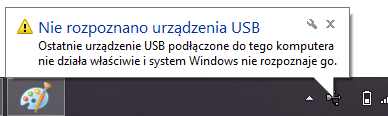

    Hello everyone .
    I have a problem with the TOSHIBA MQ01ABF050 1TB external disk. At the beginning I would like to say that I searched similar topics and found no solution. The problem is that every day for unknown reasons the laptop has stopped detecting it for me. I treated him well, I rarely removed him in the wrong way, he was not intensively exploited, he never fell. After connecting the disk to the computer (usb 3.0 port) the computer informs with a standard connection sound and the indicator light on the disk lights up. In the safe removal of equipment appears as " External USB 3.0 "not Toshiba. Unfortunately, after less than a minute the message pops up" USB device not recognized "
    The disk is not visible in My Computer, Disk Management, Devices and printers. In the device manager> Universal serial bus controllers it appears as " Unknown USB device (address setting failed) ".
    The disk has a USB micro B cable. I tried to connect it to all USB ports on the laptop, and on other computers installing the device fails. I also tried to connect it to the rear usb ports and change the cable - still unchanged.
    As recommended in similar topics, I installed the CrystalDiscInfo program, but the program detects only the internal disks of the laptop and, oddly enough - assigns them the name and model number of the Toshiba disk. I don't know how to deal with it, I have no ideas. I care about both the content and the disk itself, but if the disk has fallen I would like to recover data. I am asking you for help. I paste the screenshots below.
    I suggest you try the Y type cable.
    Disk connected when working, makes any strange sounds?

    Code 43 is displayed if one of the device's drivers has notified the operating system about a device failure.
    Therefore, this may indicate a driver error as well as damage to the device. The problems with the driver can rather be rejected, because connecting the disk to another computer also failed. Let's focus on the disk itself.

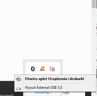

    I am asking for the symbol of this external disk read from the sticker on the housing.
    I don't know which symbol is meant so I put in the screen. TOSHIBA MQ01ABF050 1TB External Drive Not Detected: Laptop Issues, USB 3.0 Port & Solutions

    Not true , there may be "unusual" :wink: -> TOSHIBA MQ01UBD100 :?:

    Unfortunately, I could not open the disk casing .. I used the guide on YouTube, I pried it with a knife, but it holds it so hard. I preferred not to wrestle with it anymore because I was afraid that it would completely destroy the disk. I do not currently have access to a desktop computer, because only a laptop at home, so connecting to SATA tapes is out. Is there any other less invasive solution to this problem? Maybe with this DMDE program?

    I wrote at the beginning that I tried to connect to other computers, but to no avail. Other devices have a problem installing this disk at all.
