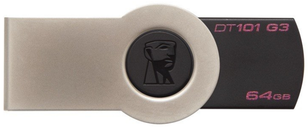

  • #9 16445085
    dumnykw1
    Posts: 14
    Rate: 15

  • #10 16447632
    pidar
    Posts: 11363
    Help: 1569
    Rate: 3590
    dumnykw1 wrote:
    D101 64GB if you want, I'll send you a photo.
    Thank you for the "incomplete" photo. :wink:
    What does it really look like and what is written on it (see below).
    Kingston DT101 G3 64GB (USB3.0) Flash Drive Not Detected: Phison PS2307, Toshiba Memory Chip
    If you want, check it out more ( only "ReFresh" :!: ) as it will detect "64GB" in the program UPTool . :idea:

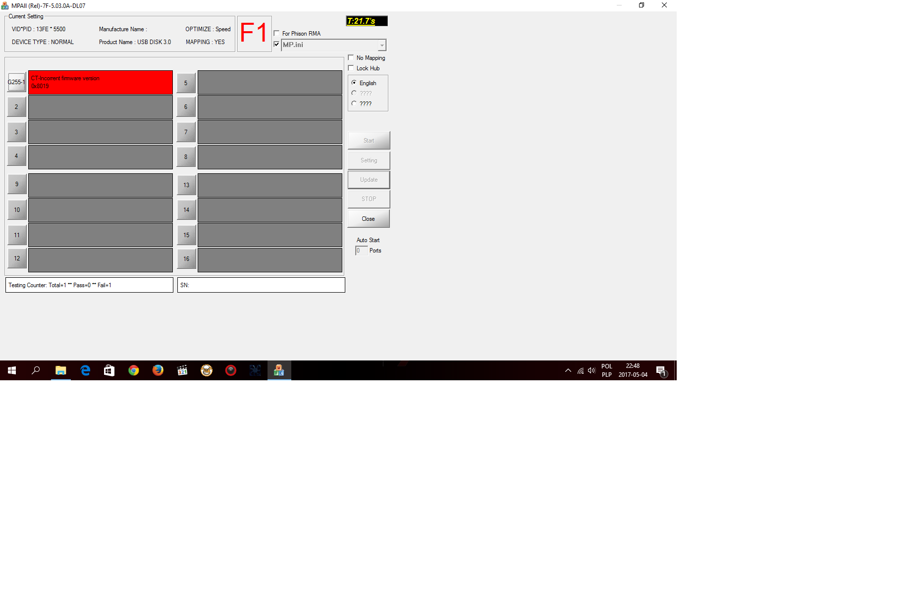

    Well now "START" in UPTool -u ( there will be an error at the end -> submit it for analysis), and then let's finally check it MPALL from my attachment. :idea:
    • MPALL F1 7F00 DL07 v5.03..0A mod by pidar.zip (2.23 MB) You must be logged in to download this attachment.

    dumnykw1
    Posts: 14
    Rate: 15
    Hello, here is a photo from the UPtool program: Kingston DT101 G3 64GB (USB3.0) Flash Drive Not Detected: Phison PS2307, Toshiba Memory Chip if necessary I will put a log from the program.
  • #14 16455300
    pidar
    Posts: 11363
    Help: 1569
    Rate: 3590
    dumnykw1 wrote:
    .... if necessary I will put a log from the program.
    You do not have to give the log, now try to upload the new firmware with MPALL -and.

  • #17 16475202
    dumnykw1
    Posts: 14
    Rate: 15
    The old one brought him back to life, the topic can be closed thanks. Helped the post program above.
