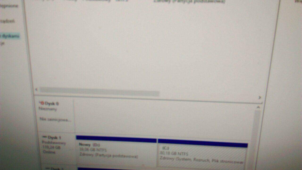

    Hello, I have a problem with one hard disk on my computer, this is 1T HDD from Toshiba. Bios does not detect it connected, but 2 Adata 120 GB SSDs already detect. In Windows 10, it shows like disk 1, but when I want to add it, I get the problem "The file cannot be found". The motherboard model is Gagabyte m250 pro-vdc mATX if that would be helpful. In addition, the disk was delivered to me only in bubble wrap. Thank you in advance for your help and sorry for any mistakes in the text.
    • Bios (UEFI) Unable to Detect Toshiba 1TB HDD on Gigabyte M250 Pro-VDC mATX - Windows 10 Issue received_1996855490601620.jpeg (38.44 KB) You must be logged in to download this attachment.

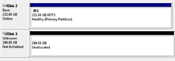

  • Initialize new disk as MBR in Disk Management
    #6 16732758
  • #7 16732761
    safbot1st
    Posts: 21951
    Help: 2719
    Rate: 1585
    I don't know, by me should be "unallocated". I might be wrong:
    Added after 45 [seconds]:
    Aseri15 wrote:
    The disc is new, as you can see (I say that since it was delivered in foil).
    But in "bubble"? P
  • #8 16732770
  • #9 16733714
    EnklawowyBobru
    Disk loudly walks in neighbor stated mechanical damage to the disk to be replaced. Subject to close
