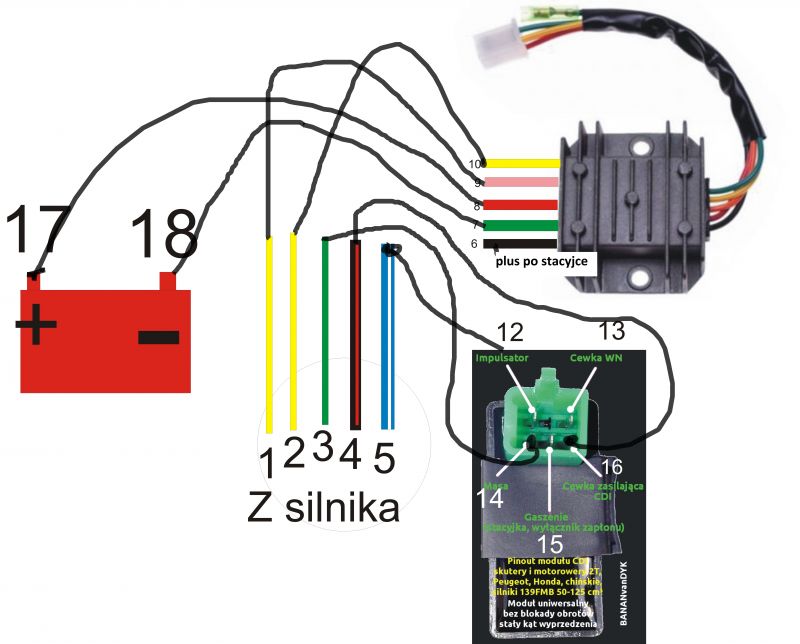

    Hello, I replaced the installation with a new Zipp Pro with a 125 engine. I do not know how to connect the elements that I prepared in the graphics. I would like to connect "briefly". Because when I connect in different ways, there is no spark in the new installation.
    Connecting Elements in Zipp Pro 125 Engine Graphic: No Spark in New Installationzipp 125..o.jpg (1.39 MB)You must be logged in to download this attachment.

    Hello. Check that you have all grounds properly connected. The mass of the module, regulator, battery and generator should be common somewhere on the frame. It is not in the attached picture. The "quenching" pin of the module may still be shorted to ground, you can check it with a meter.

    everything works clear that the mass of the coil goes to the frame :)
