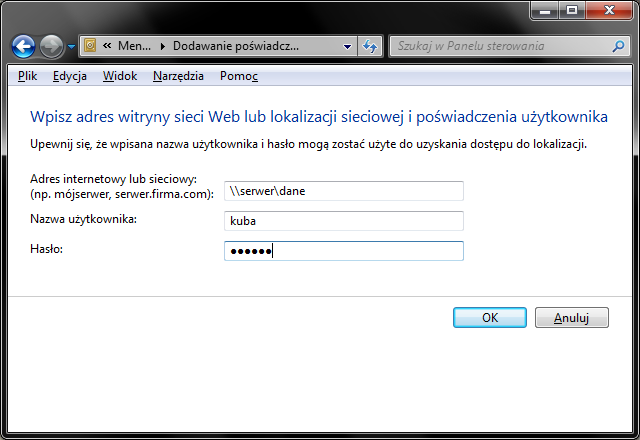

    And on the subject of authentication: add a plate to the Windows Credential Manager :
    :arrow: Control panel (icon view) :arrow: Credential Manager :arrow: Add Windows credential :arrow: you enter the name of the computer / host on which the Symfonia + login + password is and it should work (;
    This is what it might look like, but instead of the name, I suggest using a specific IP:
    Windows 10 (1803 Update) Network Visibility Issue: Computers Not Seeing Each Other on LAN
    (screen from Win7, but the same for Win10)

    In Windows Credential Manager, both computers were already checked in, so I removed them and added them again. I assigned a fixed IP in the router, but it didn't change anything. It is still so that either both computers do not see anything, or after restarting, one sees the other but the other one does not see the first and so on. And all because of this system update ... instead of improving the system it just made a mess. I am still asking for tips in solving the problem.
