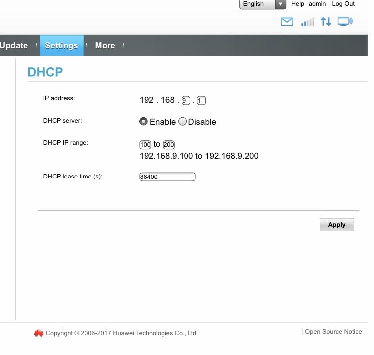

    Just today, to my surprise, there was a software update for the B529s-23a router
    - after updating, I check what they added or corrected and what can I see in the DHCP option:
    Setting a Static IP Address on B529s-23a Router for Specific MAC Address
    - this solves my first problem which was - static IP to a given MAC address and using a different router
    Maybe the WIFI communication with which I had a problem once in a while on certain devices has also improved. I will check, test and let you know :)
    What is your software version? I am looking for the same and I do not have IP addresses reserved in DHCP.
  • #22 18737067
    gothic77
    Posts: 560
    Rate: 84
    Modem firmware version: 11.187.61.00.49
    - on this ver. when it comes to IP assignment, you have the DHCP option, and in it - IP and MAC address binding
