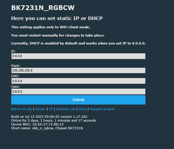

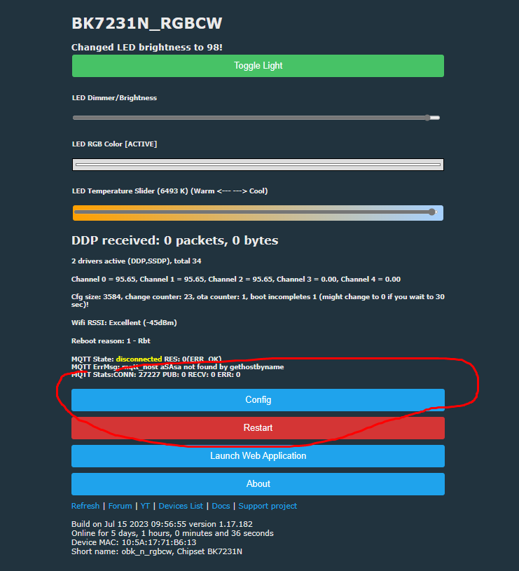

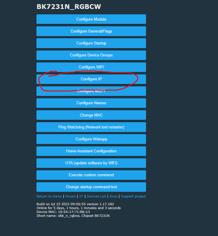

    Hello @jbrande ,
    to set the static IP in OpenBeken, first click Config:
    OpenBeken - Setting Up Static IP for BK7231 IoT Devices with Poor Signal Strength
    Then go to Configure IP:
    In Configure IP, enter your desired static IP, your mask, DNS and gateway:
    If you are not sure about the Mask, IP, etc, settings, you can check them on your router or on your PC machine (ipconfig command). Futhermore, please make sure that you are setting IP address that is not already reserved, otherwise you'd get an IP conflict.
    Alternatively, you can stick to DHCP setting on OpenBeken and just configure a MAC-based address reservation on your DHCP settings of your router.
    Let me know if you have any further questions or if something is not clear.[/b]

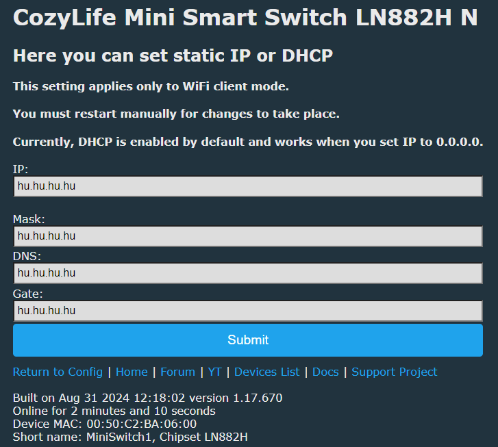

  • #6 21212667
    kodacy
    Posts: 6

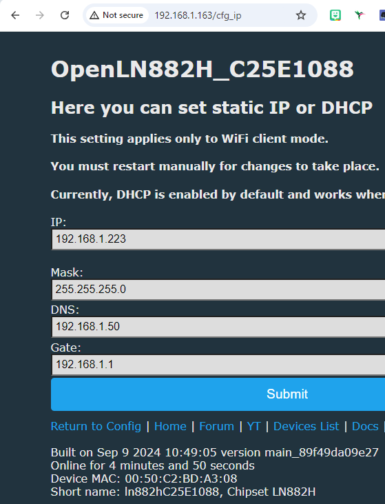

    >>20662501 Tried multiple times in different browsers and it always reverts back to original set DHCP IP. When I access the configure screen I always get this hu.hu.hu.hu on every line.
    Screenshot of the CozyLife Mini Smart Switch LN882H configuration screen with IP fields filled with hu.hu.hu.hu.
    Any idea on how to fix this issue on a LN882H.
    Thank you
  • #7 21212848
    Posts: 14767
    Rate: 12907
    It seems that obkStaticIP_t is not currently used (implemented) for LN882H:
    https://github.com/openshwprojects/OpenBK7231T_App/blob/main/src/hal/ln882h/hal_wifi_ln882h.c
    So it's a pending feature.

    #9 21219984
    max4elektroda
    Posts: 758
    Help: 49
    Rate: 189
    A first approach to implement this is in PR#1342.
    I first had to deal with the unknown "%hhu" in printf (generating the IPs like hu.hu.hu.hu) and ssccanf.
    Then setting an IP just didn't seem to work, and this turned out to be an implementation of the netif that will always use DHCP.
    So as a first try I simply made an extension to the call setting the IP, so afterwards we know IP was statically set and netif handling shall not use DHCP then. Seems simple and straightforward, but maybe there should be a more direct way to disable DHCP on an interface?

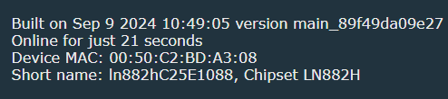

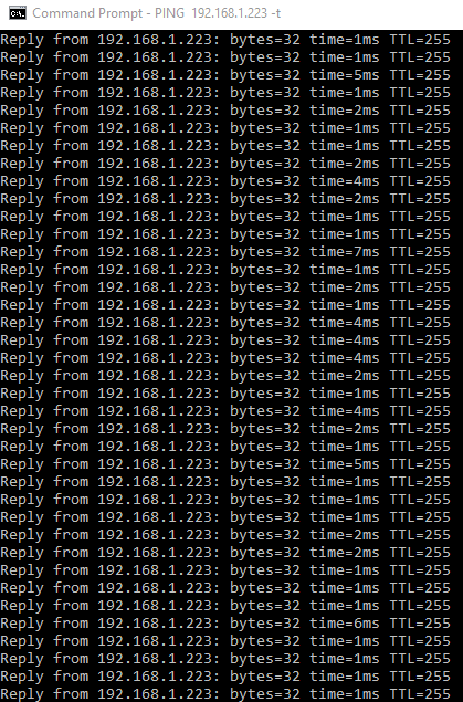

  • #13 21220399

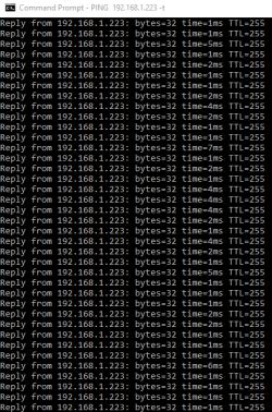

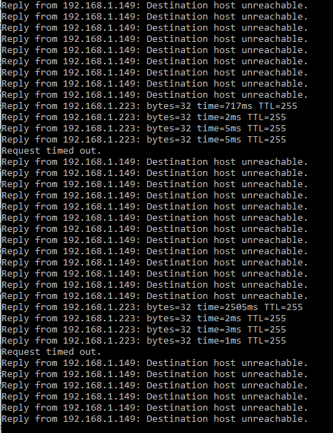

    Posts: 5216
    Help: 448
    Rate: 917
    hmm. it'll give 4 ping responses from the static-set IP (192.168.1.223) but then it switches back to DHCP (192.168.1.163 in my case)
    Screen showing device information with build date, online time, MAC address, and chipset name.
    responses here after each reboot
    Screenshot of ping command results showing replies and availability errors.

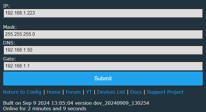

    max4elektroda
    Posts: 758
    Help: 49
    Rate: 189
    Which version did you try? Maybe it's still built with the old SDK? This would in fact "overwrite" the static settings ...
    How does the config page look? Does it show correct IPs or still "hu.hu.hu.hu"?
    I just cloned the git and built a new version. and its working for me. Just to be sure, could you try this version?

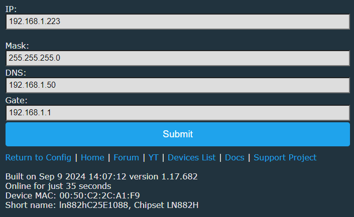

    Posts: 5216
    Help: 448
    Rate: 917
    all good with 1.17.682. After OTA it brought itself up on the preconfigured static IP and is staying there
    Network configuration interface with IP, mask, DNS, and gateway settings. Screenshot of a command prompt window pinging IP address 192.168.1.223 with response times between 1-5 ms.
