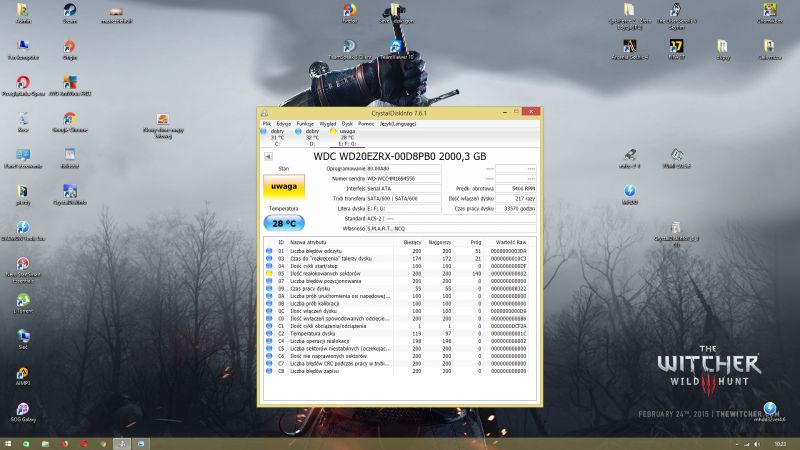

    Run some bootable system and enter SMART disk.
    Did you sometimes run out of power during the system upgrade?
    If there is data on the disk, it may have damaged your boot sector or some important boot files. In this case, you can repair the system from the original Windows media

    Run any bootable Linux on this USB stick. In Linux, you'll find a SMART disk.
    Alternatively, run MHDD (also bootable) and read SMART. The disk may be damaged, not only the data on the disk, then you won't be able to recover the system, maybe you will pull out the data at most.

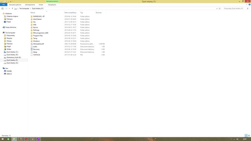

    From drive D, I copied all files, unfortunately I couldn't get to drive C where the system was installed (drive restricted).
    Maybe I will add when I plugged into another computer on a second tape, three partitions appeared:
    restricted disk E
    drive F where there are windows files etc. (I can't find a folder thanks to which I could get to the desktop, that's where I have some important data)
    drive G is the partition from which it was possible to copy the data

    Unfortunately, the disk is no longer suitable for system use.
    Surface problems (01), relocated sectors (05) and (C4).

    Since you have access to the partition, copy ...
    I don't understand what you have a problem can't find the desktop ?? Come on, stop it.
    C: \ Users \ (account name) \ Desktop \ account name is the username you set there is the desktop
    C: \ Users \ (account name) \ Documents are documents
    Instead of C, the letter of the partition on which the system is (the one that died), which seems to be F for you.
    By the way, did you not come across e.g. search options? You probably remember the name of at least one file you need from this desktop.

    And here is the dog buried because there is no Users \ Users folder. Search also found nothing.
    On system hiss, only such folders: Asus Uefi Bios - EZ Mode - The computer does not react when turned on

    Since the search has not found it is gone. Now the question is whether you have changed the desktop path (because it can be done anyway) or somewhere in the heat of battle the folder has been deleted. I understand that hidden and systemic shows nothing? The sum of the data in the partition corresponds to the space used?
