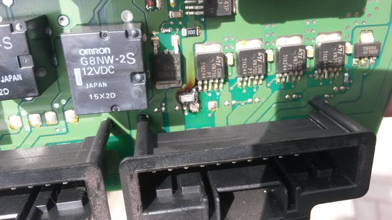

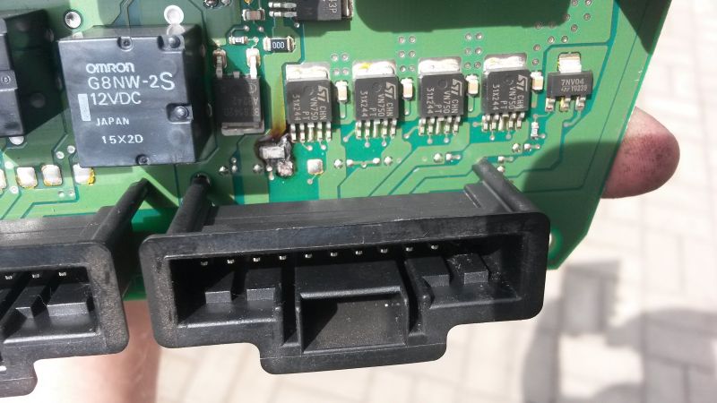

  • #11 17295900
    Frost160
    Posts: 692
    Help: 9
    Rate: 183
    The cable and the plug to the ears are checked, working properly.
    I opened my ear, here's what I found:
    Megane II 2004 - Rear boot lock and rear washer does not work. Megane II 2004 - Rear boot lock and rear washer does not work. Megane II 2004 - Rear boot lock and rear washer does not work. Megane II 2004 - Rear boot lock and rear washer does not work.
    Burnout almost perfectly over the power pin you wrote about.
    Can it be fixed? Is it only a replacement for a stimulant and an immo spacer?

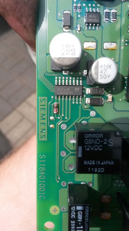

  • Question about UCH bridge component identification
    #12 17420835
    arrttuurro
    I will connect to the topic. I have exactly the same case. For me, someone also fixed the problem with the cottage industry by connecting + from a location other than UCH, but also active only after opening the central one. I put everything back to factory condition, everything worked as it should for about a week and the entertainment was repeated :( My UCH looks similar, maybe it is not as burned as my friend's. Maybe someone would be able to define what this element is?
    Maybe it's just a bridge like the one above and a piece of wire will do :)

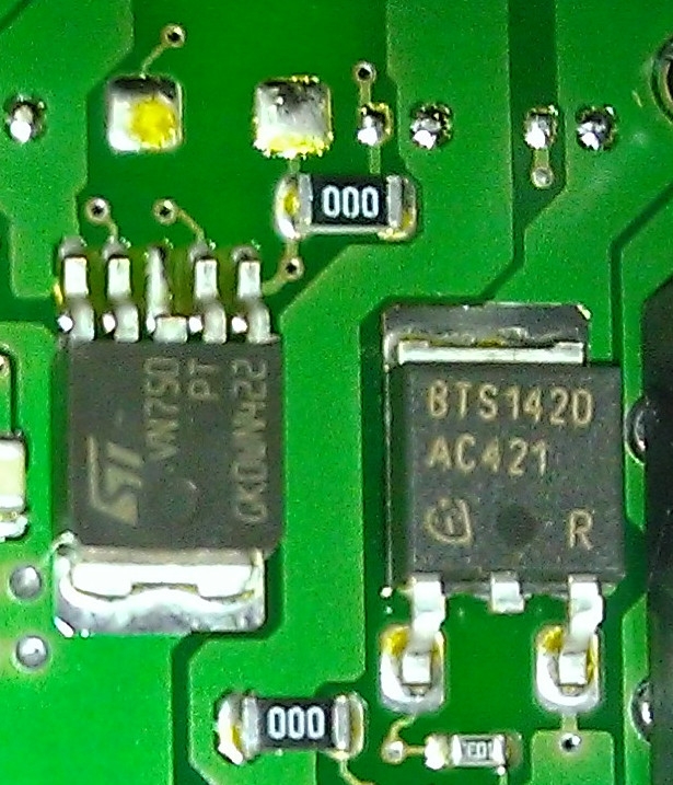

    Well, my topic is solved. If someone ever needed it, there is a resistor installed in the place that burns out. Unfortunately, I found divergent information about its value. One source gave about 100 ?, the other 0 ?. The element that I had had a value of 95 ?, but due to the fact that it was burned out, it is difficult to speak of any accuracy. Eventually I found something like this:
    An ordinary 0? "jumper" is mounted here :) So I put in the right resistor and everything works as it should. The hatch opens every time. The only problem I encountered was the chafing path on one side of the resistor, but somehow I managed to solder it. Finally, I poured tile varnish to make everything stick.
    Below are the parameters of the resistor I installed:
    Resistance - 0R
    Housing - 1206
    Tolerance - 5%
    Power - 250mW

    Did you have the exact same spot burned out?
  • #15 17460055
    piskala
    Posts: 11
    Yes, but not as much as yours. In my case, the tracks were still completely detached. The resistor, on the other hand, was burned out and there was no chance to read its value.
    By the way, I don't know why there is information about two resistor values. Maybe it depends on the date of production of the UCH. I have it from the beginning, i.e. 2002.
