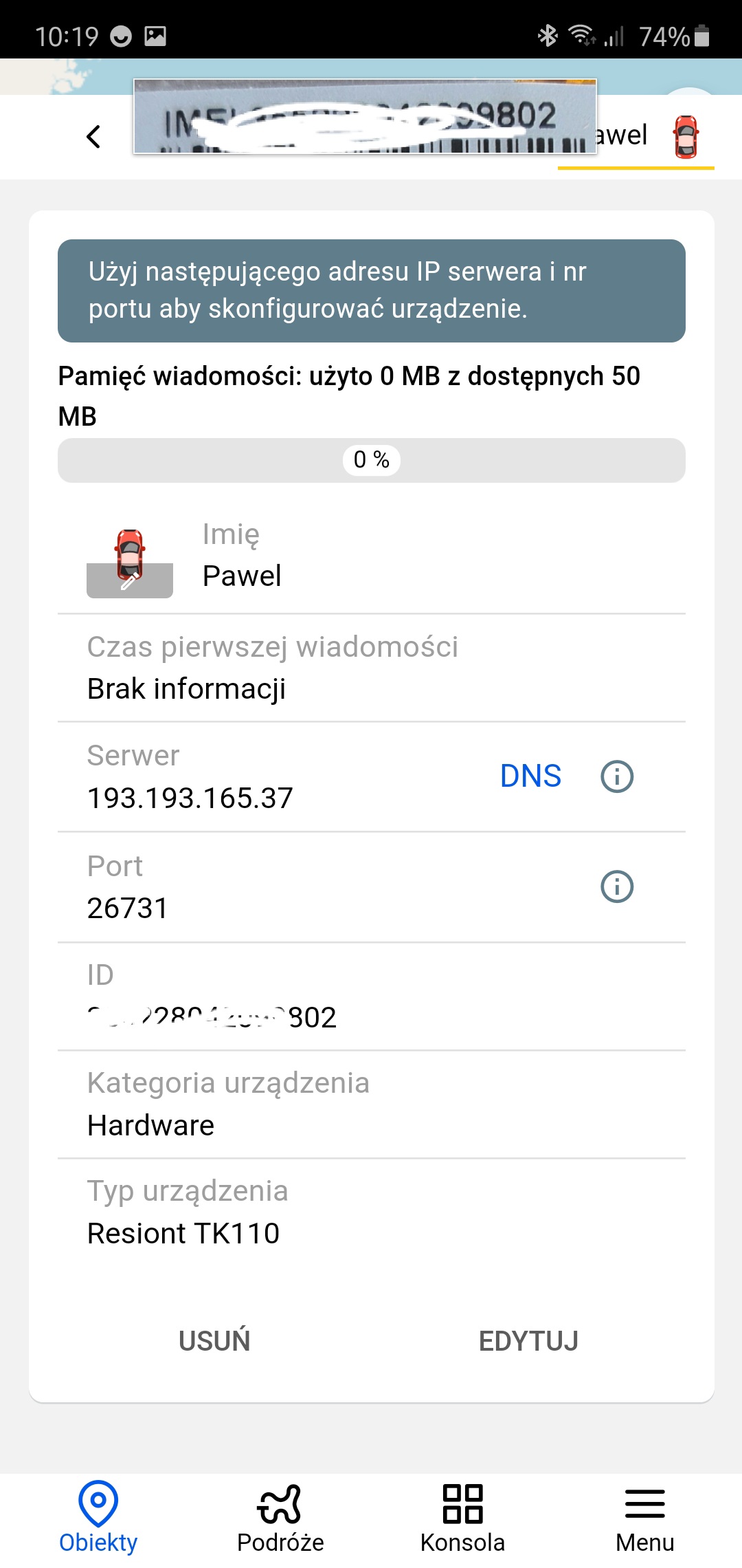

    Maybe someone will help me, I tried according to the descriptions but it does not work. The site has changed its name, Ruhavik app. Tracker from China gt02a
  • #40 18825158
    bsp5020
    Posts: 124
    Help: 17
    Rate: 76
    Follow what the SMS configurator spits out (for TK110):
    http://config.viaroute.pl/index.php?page=config
    In Ruhavik, select Resiont TK110 as device, port 20448
    There are different devices under this name, if they are still invisible - write to priv, we will determine by the frames what protocol it uses and match it to the Ruhavik device.
  • #41 18825335
    baxy
    Posts: 8
    Yes, I do, but when I choose Resiont tk110 it shows the server 193.193.165.37, port 26731
    Edit: on the http://id.wialon.net website I checked the ports from devices related to gt02a one by one and logs on to tk110 on port 20488, however, in the Ruhavik application you cannot select such a device with this port.
    Please help

    I HAVE THE SAME AND IT WORKS FOR ME:
    The server
    12741.flespi.gw or 193.193.165.37
    Harbor
    26731
    ID IMPORTANT PLEASE PLACE AT BEGINNING 0 and 11 digits 2 ... your id ...
    tk110
    then check by SMS Status, 666666 # 66666 is your password
    if it doesn't work, set the zone Gmt, 66666, e, 1 #
    and sending time TIMER, 666666,, 30 #
    and APN ele it is already under the operator
    As for the Ruhavik website, it is only free for 1 year? and how many gps can be serviced for free.
