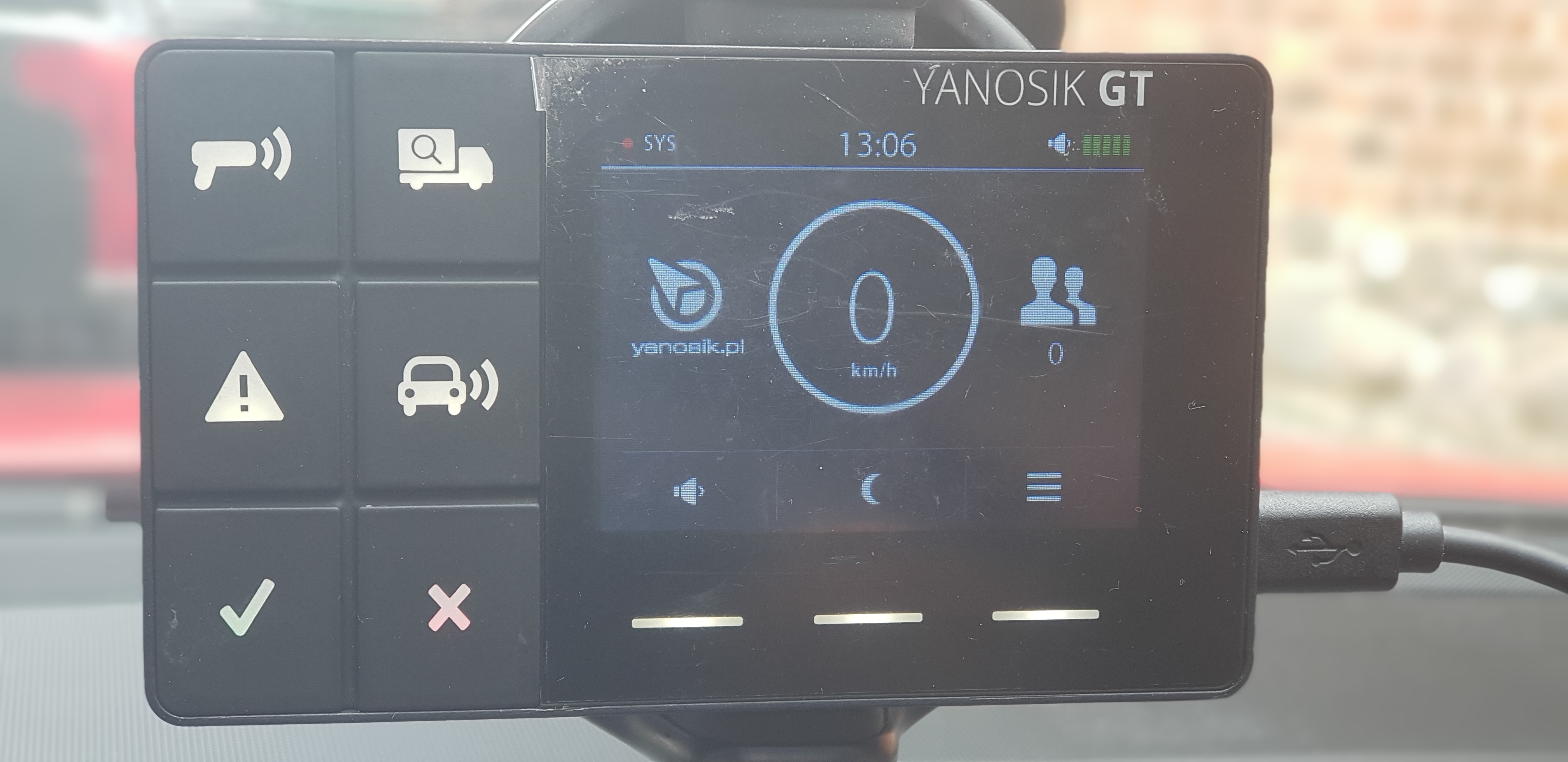

    1) Can an alternative SIM card be used for Yanosik GT that will work?
    (I tried Aero2 but SYS lights up red and doesn't show active users)
    The problem here is probably wrong settings, e.g. APN access point name, only where and what can be changed.

    Today with Internet play card
    Sys in red

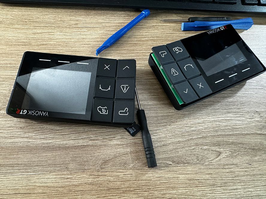

    I have the old R, the first one. My SD card died, I have a 2Gb regular one, not even a micro one, I didn't have to copy anything, I inserted a blank card from the store and the device started working again on its own, I didn't even format it.
    The card is intensively ground as an on-board disk and cell degradation is quite rapid.
  • #24 20787908
    Matmich10
    Posts: 6

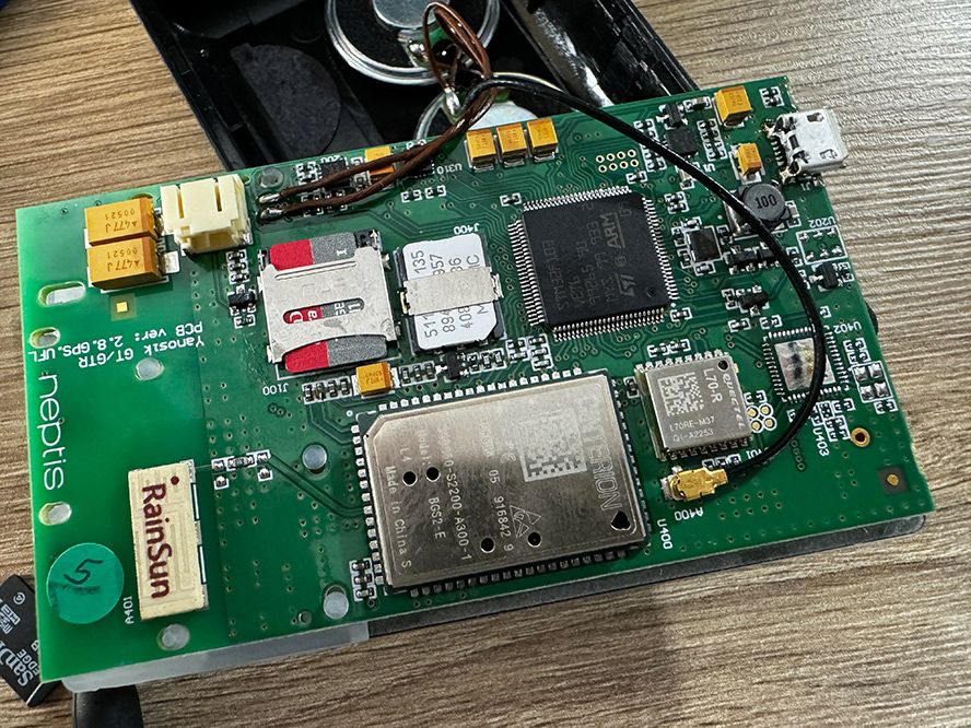

    After one of the Yanosik GTRs kept resetting, turning off, or hanging on some message that lasted 30 seconds and annoyed the driver until I unplugged it, I took the device apart and tried to copy a copy of the SD card. It turned out to be one big bad sector and it was of no use. There were 4 partitions on the card, but only one was completely correct.
    I took apart the second device, surprisingly two years older, i.e. from 2018, made a clone of the card, inserted it into the one from 2020 and everything works flawlessly. Logs in to the cellular network and GPS. In "system information", everyone identifies themselves with their ID from the sticker and provides the correct expiration dates for data transmission, as if the software on the card was just software, and the remaining identifications are made at the hardware level.
    The motherboards of the devices are quite different. The 2018 device has a full SIM card, the 2020 device has a nanoSIM. The SD card slot is in different places, the board layout is also completely different. Maybe this information will help someone, because I was looking for information myself, and there is almost none. In my case, the job was trivial, no interference with the software, APN, card PIN, etc. is needed. Both devices have active data transmission.
    Two disassembled Yanosik GTR devices with exposed buttons and a screwdriver on a wooden desk. Yanosik GTR device motherboard with visible electronic components.

    Then post an image of these partitions/clones here or somewhere!

    @breshnew If anyone needs a picture of the card, please send me a private message. There are identifiers in the software which device is the donor, once I clear it, I will upload the bare image.
    @epiotr2 perhaps it is paired somehow in newer versions? I bought the last Yanosik in January 2020 and so far I have managed to reactivate it
