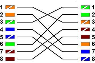

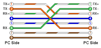

    Did you make a cross cable to connect the computers?
    If so, for 1GB connection, you need to swap not only the orange and green pairs, but also the blue and brown pairs.
    greetings
    Andrew

    Did you do it like this:
    Cat 5e U-UTP Twisted Pair Not Syncing to 1 Gbps on Windows 10

    Andrzej75
    Posts: 41
    Once again,
    100MB patch cord
    [align]
    1GB patch cord
    Cat 5e U-UTP Twisted Pair Not Syncing to 1 Gbps on Windows 10 [/ align]
    or yes
    greetings
    Andrew
    NOT TRUE.
    And it is of great importance.
    Structured cabling (as understood by professionals) can be fully used for telephony. On your idea, on the first ring, there is smoke coming from the ethenrnet card.
    The newer inventions (not yet standardized) include PoE power.
    False rumors about cables should not be tolerated
    (Historically, before the Auto MDI-MDIX era, ONLY orange to green pairs were patched. Blue was ALWAYS middle and Christmas.)
