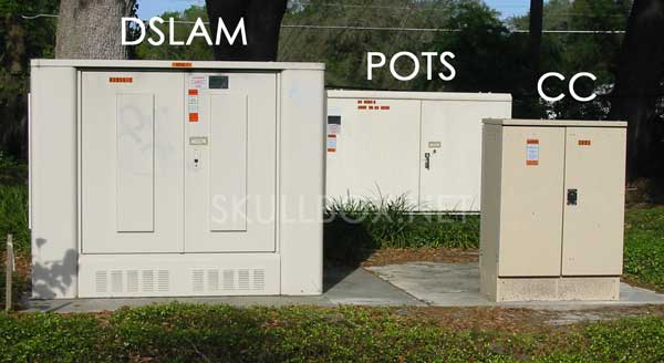

  • #30 12776494
    jimasek
    Posts: 35287
    Help: 3783
    Rate: 2681
    okular766 wrote:
    So if it was 10Mb for me, they would have to re-lay the cables to my house? They probably won't. How to spr. where is the nearest headquarters, probably more than 20km in my opinion.
    Not the switchboard, but the DSLAM, to be specific:
