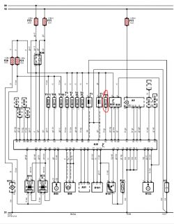

    The mass of this actuator goes through some anti-interference filter, the efficiency of which I am also not sure (I marked the actuator with a red pin).
    Volvo v40 1999 (B418S2 engine): Variable Valve Timing Issues with P0010, P0135, P0141 Errors
    Can I omit it in the circuit for tests (give minus directly to ground and plus from the computer) and check if the voltages are correct?
    #6 17306265
    tzok
    Posts: 38882
    Help: 3175
    Rate: 6545
    No, because the valve should receive constant 12V after ignition and the key mass from the controller, i.e. you read the diagram incorrectly. You have checked the presence of a constant voltage of 12V on the power supply of this valve (bulb, not a meter) - between 12V from the actuator plug and the ground of the body.
    #7 17306352
    kortyleski
    Posts: 12265
    Help: 957
    Rate: 3860
    There shouldn't be any filter there. When something is on the installation, someone was already pushing their hands. As tzok wrote, check the 21W bulb supply in parallel with the meter. There is to be full battery voltage. Of course, on a running engine.
