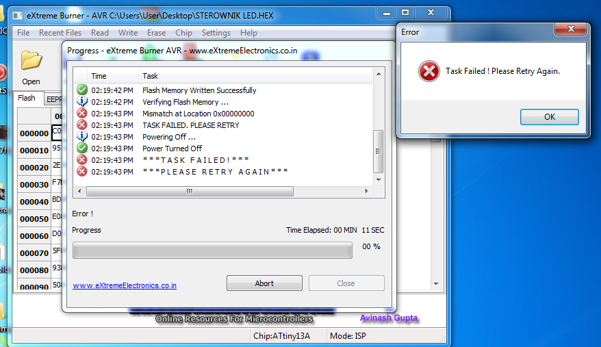

    The programmer-> system connection is good (I have connected the programmer so many times that I know the sequence of the legs on the prock and on the KANDA connector by heart). The programming ribbon also seems good (I checked it with an ohmmeter).
    I was also acting on my own and tried a different programming program. EXtreme Burner AVR gave me this message:
    Power On Failed
    Cannot Communicate with Target Chip
    Here they write to check the ISP connection, but as I said, I checked it in all ways available to me and everything indicates that it is OK.
    I also noticed another interesting thing. When I put a voltmeter on the Vcc and GND pins of the prock, these two LEDs somehow magically lit up. When I took the voltmeter, they remained on for a while, but then they went out. From time to time, applying a voltmeter, these LEDs started in different ways. Sometimes they flashed, sometimes only one was lit (at least it did not seem to me to be "consciously" running the program). When I managed to achieve the effect that both LEDs were on, I tried to contact the Prock, but regardless of what action I triggered at avrdude, the LEDs turned off and the program spewed out an error (to restore this light, I had to cut the power from the prock for a moment, and after turning it on from new to play with voltmeter).
    I am waiting for your opinion on this, but now it seems to me that either the chip is broken or the contact plate on which I have assembled the whole thing is not suitable for such things.

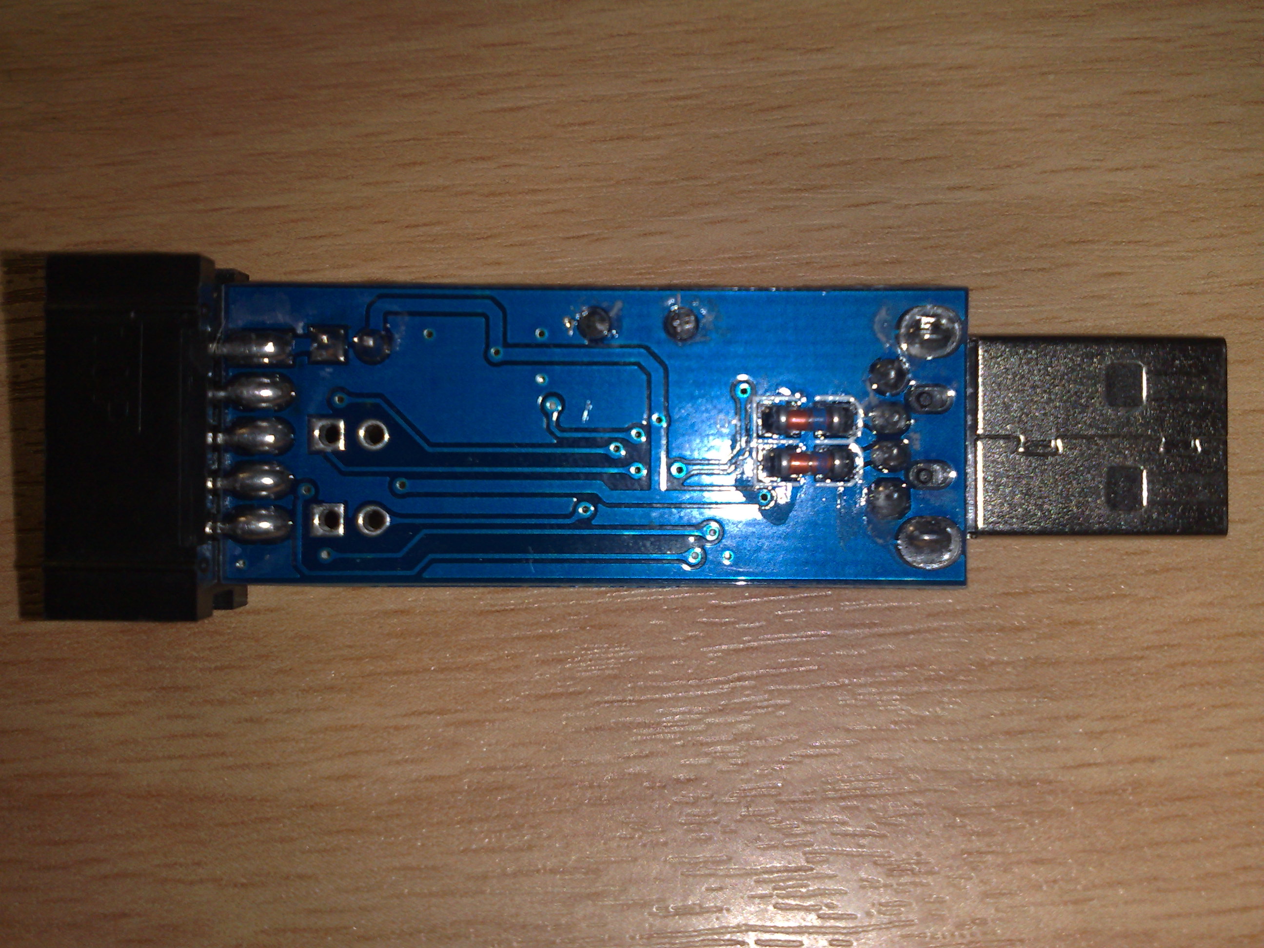

    Ps. Upload 2 photos of the programmer :)

    Here are two emo pics of my programmer:
    Atmega32, USBasp, Avrdude: Resolving Error Setting SCK Period & Invalid Device Signature Issues Atmega32, USBasp, Avrdude: Resolving Error Setting SCK Period & Invalid Device Signature Issues

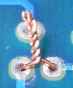

  • #14 9135555
    bigben93
    Posts: 32
    @ Light-I
    Take a look at the first photo. You have a jumper soldered on the top right. As far as I know from the seller, this jumper is responsible for the free programming mode.
  • #15 9135601
    BoskiDialer
    Posts: 1530
    Help: 353
    Rate: 42
    bigben93 Take a look at the second photo, there is a thick path to the jumper and it goes out to the VCC pin from the target circuit connector, so it will rather be from the power supply.
    The middle (J4) jumper is connected to the reset pin, so it will be from the firmware update, so the latter (J5) will be from slow sck
  • #16 9135643
    saper_2
    Posts: 322
    Help: 23
    Rate: 38
    Divine Dialer , you warned me for a few minutes :P . As you write, the jumper you have is from connecting the power to the programmer from the target system. J4 connects the processor reset in the programmer to the connector (needed to upload FW). And J5 remains SlowSCK.
    So when you jumper J5 (e.g. put a piece of insulated wire in the pads and twist it tightly so that both points meet) and then try to communicate with the target processor.
    I mean something like this :) :
  • #17 9136650

    avrdude: warning: cannot set sck period. please check for usbasp firmware update.
    Avrdude asks you to update the firmware of the programmer itself, because the old one does not support software SCK speed change. You force such a change with a parameter -B10 . If you add this to the command, the programmer will not set the jumper. sapper_2 already wrote to send a command without this parameter, but again you got the above quoted excerpt, which is disturbing. After updating the firmware, you should get something like this instead of this error:
    set SCK frequency to xx kHz
    So I suggest you put a jumper on the update and update the firmware.

  • #19 9139547
    bigben93
    Posts: 32
    I made this jumper connected, but still no communication. The only thing that has changed is the waiting time for a response; previously i got it almost immediately and now i have to wait 2-3 seconds before getting this error message so i suspect slow programming was on.
  • #20 9139794
