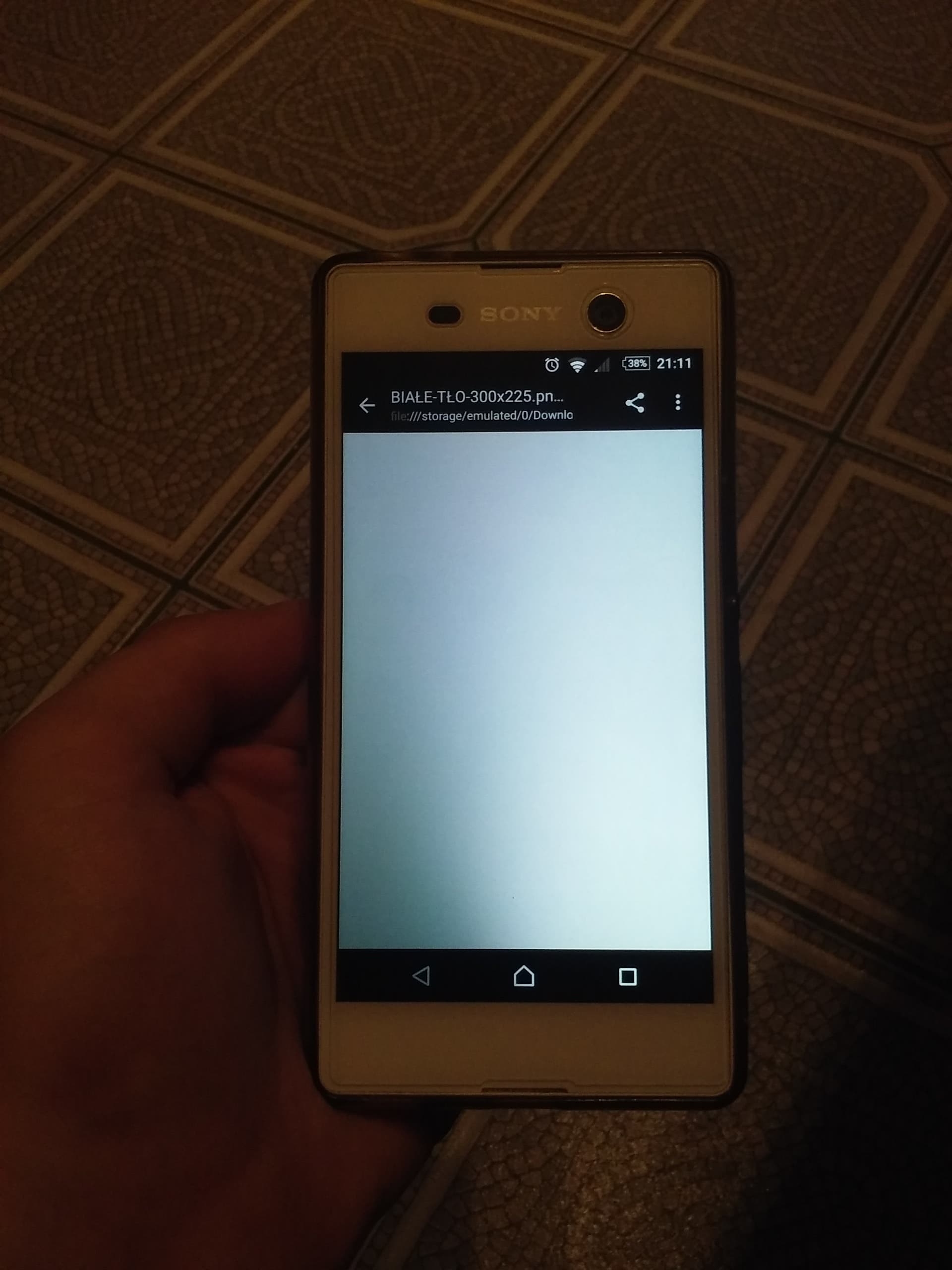

    Additional information, maybe not special, but important to me, I noticed that one corner of the screen is darker than the rest, it illuminates the screen less well, maybe it is the software's fault or the matrix is sitting down?

    Insert a picture what the screen looks like.

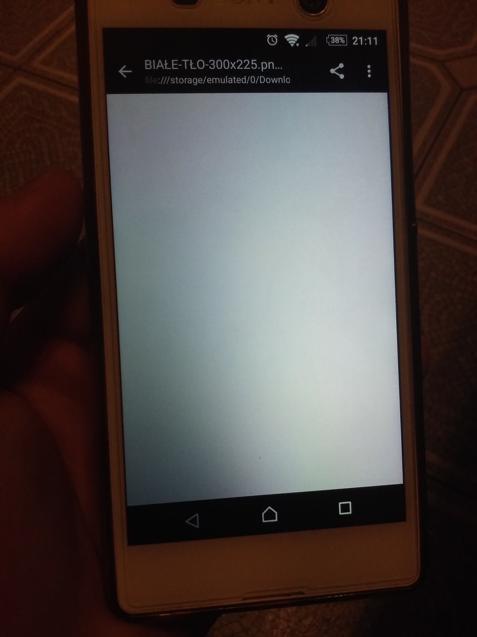

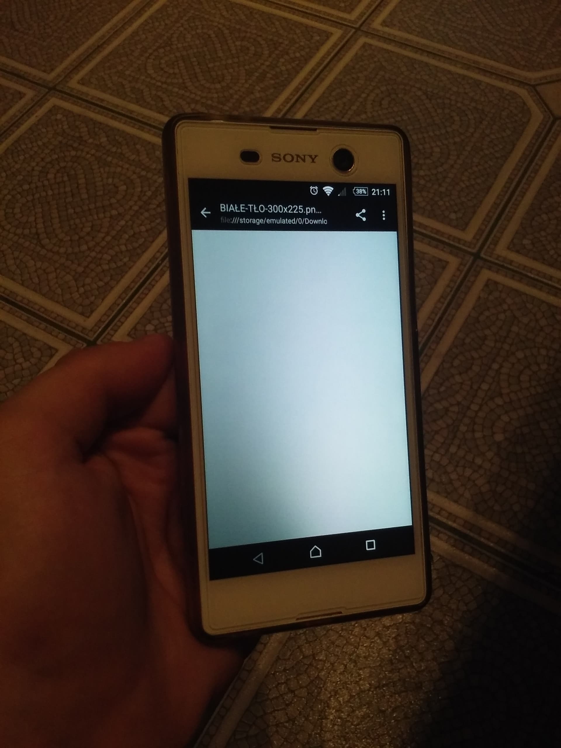

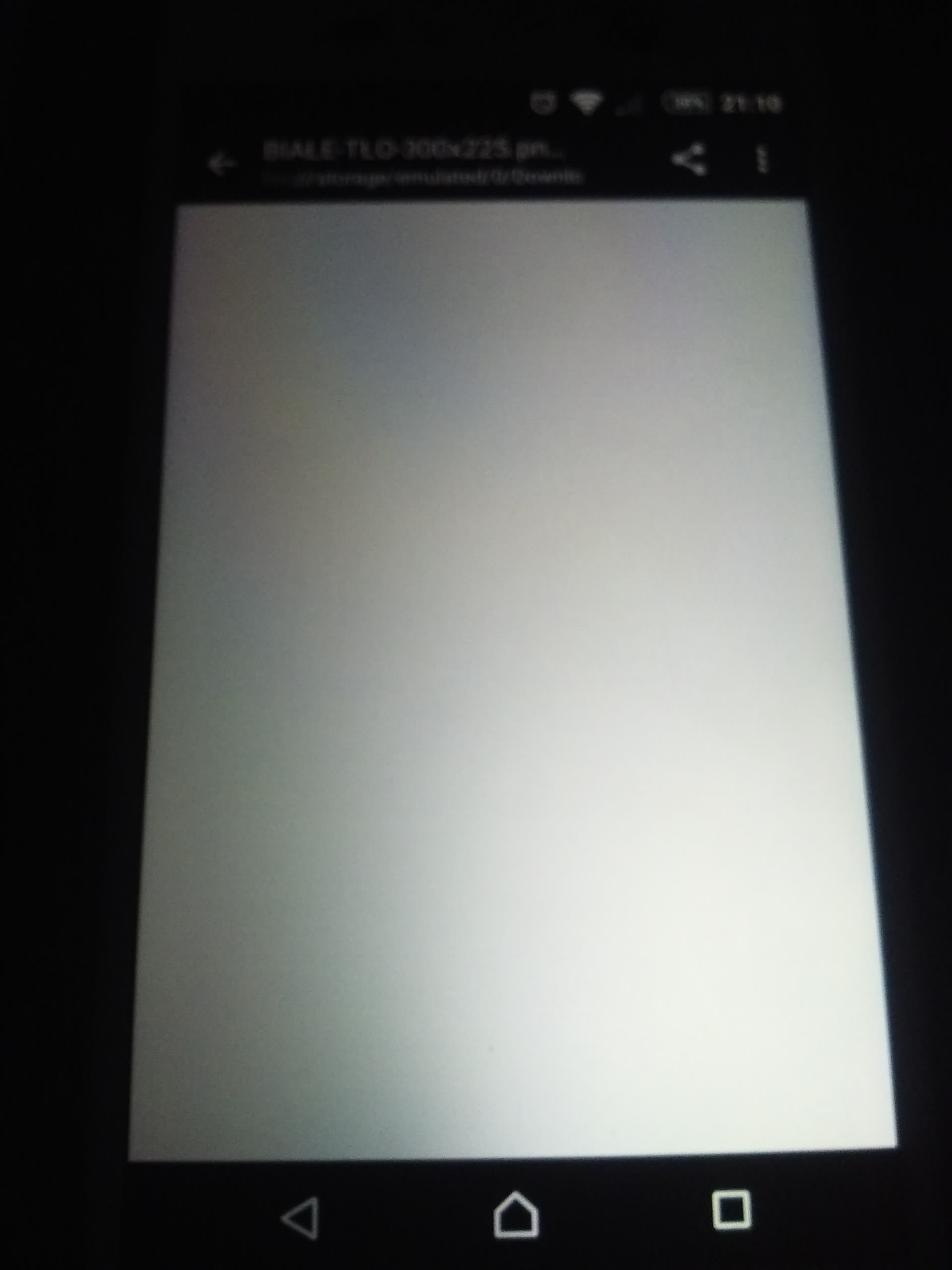

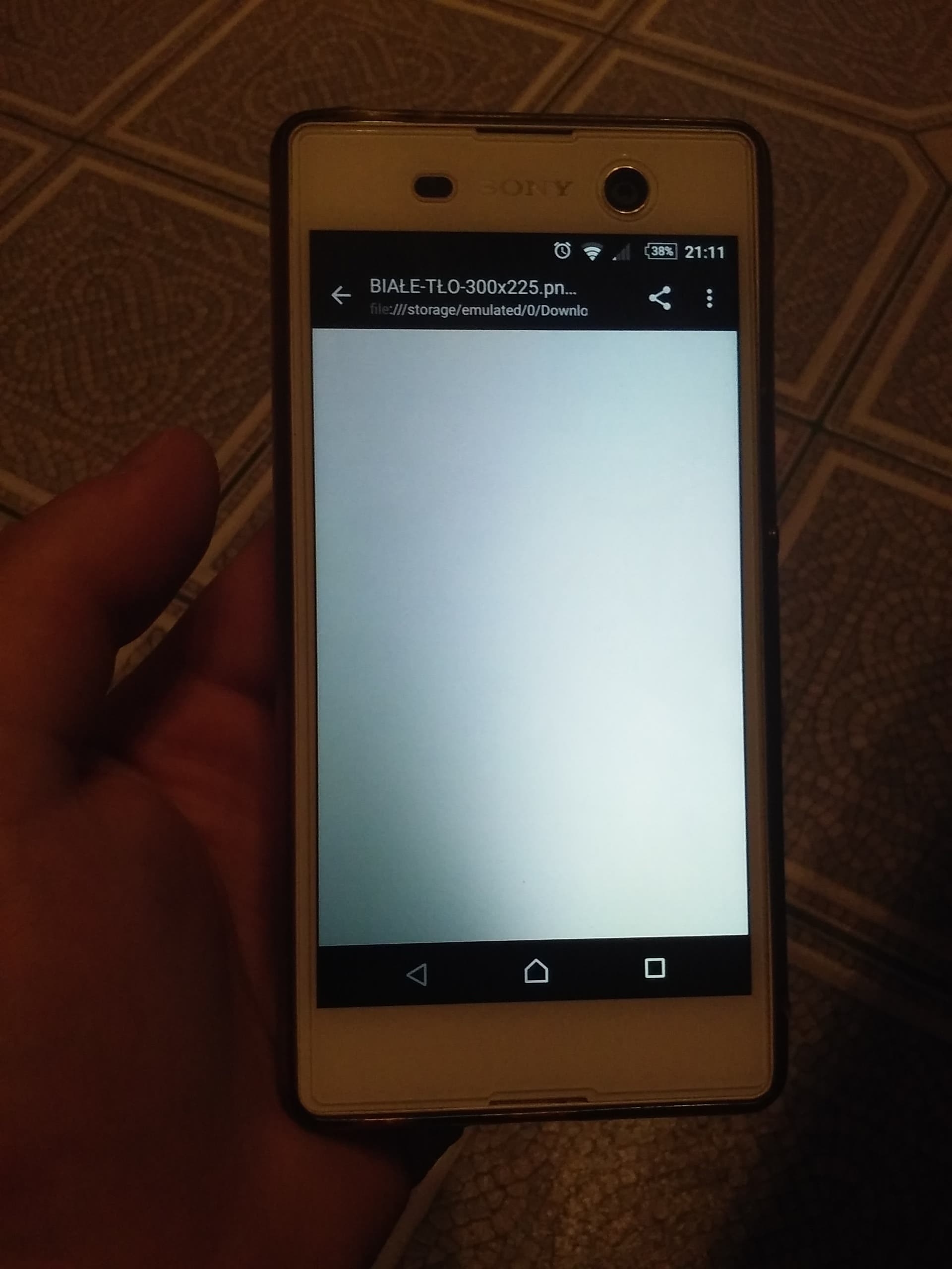

    Phone screen brightened 100% on a white background I took a picture of my old LG LEON LTE phone, I hope you can see it.
    Sony Xperia M5: Unexpected Shutdowns during Messenger, Google Maps & Varying Battery Percentages Sony Xperia M5: Unexpected Shutdowns during Messenger, Google Maps & Varying Battery Percentages Sony Xperia M5: Unexpected Shutdowns during Messenger, Google Maps & Varying Battery Percentages Sony Xperia M5: Unexpected Shutdowns during Messenger, Google Maps & Varying Battery Percentages Sony Xperia M5: Unexpected Shutdowns during Messenger, Google Maps & Varying Battery Percentages
    And the question is, in this case, will my screen fall? is it the fault of the system? However, will the repair be unprofitable and I have to prepare the money for a new phone or whether this defect can remain so for a long time because in fact, at low brightness you can hardly see it and it does not bother me at a high level, because it is also poorly visible and certainly not I will return to LG Leon Lte because that phone is a failure ..

    As for the screen, was it ok before?

    From the beginning, when I bought it, I probably knew it 3 hours after buying it, because outside I was not able to see it only in a dark room or at night you can see it so much.

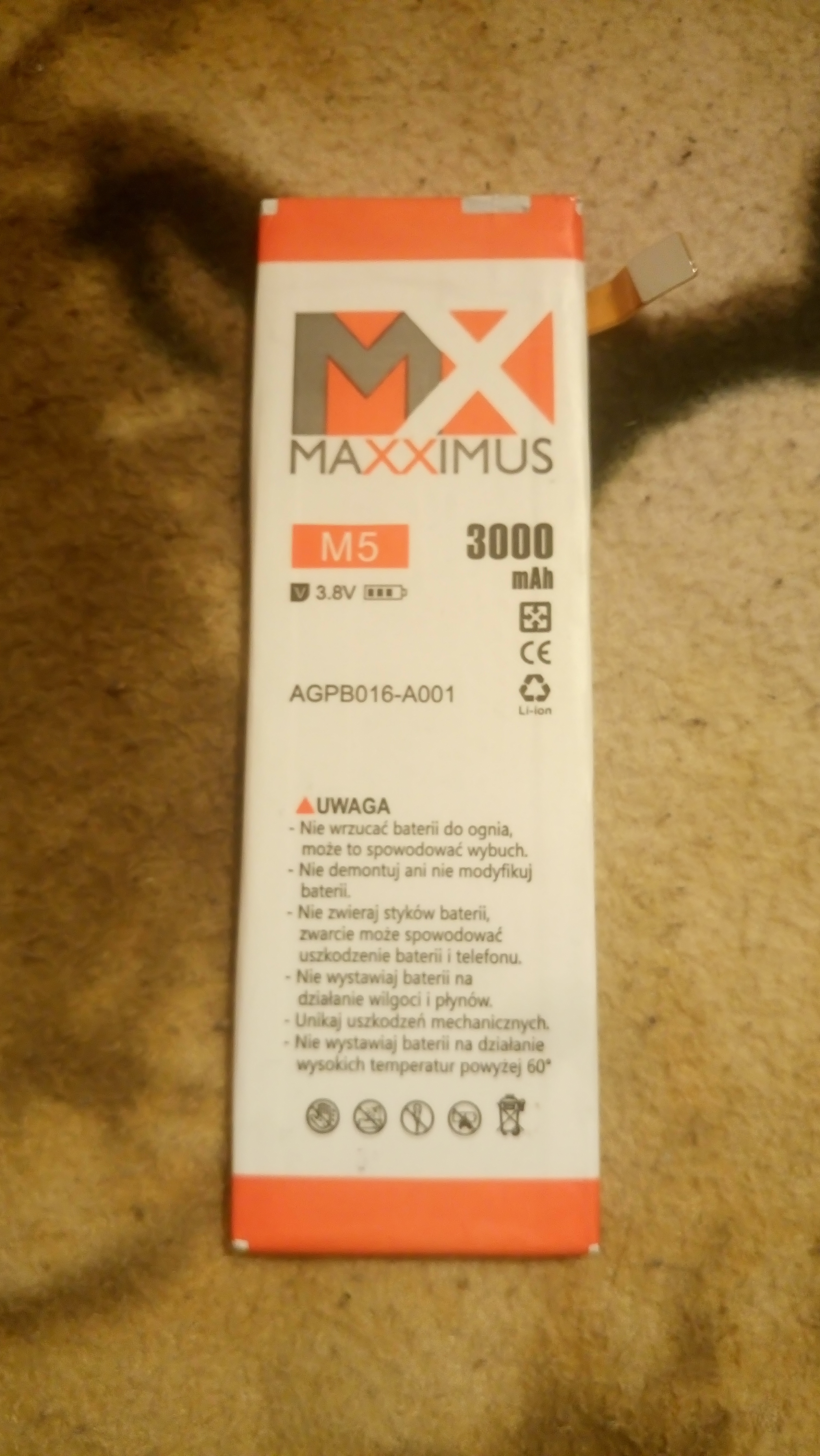

    Hi, I have not continued this topic for a long time because of the purchase and waiting for batteries
    I ordered the new batteries visible in the photo
    Unfortunately, the problem has not been resolved
    Then I bet on the motherboard, I bought a phone with a broken matrix, but still working.
    I replaced the motherboard, the problem still has not gone away, even I took batteries from this broken Sony and it did not help.
    I noticed the problem that it does not occur when the phone is connected to the charger.
    Maybe someone else has some suggestions to check?
