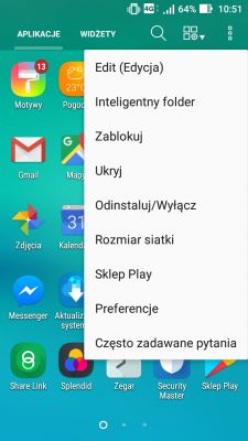

    Kraniec_Internetów wrote:
    Try to set up a password for applications. In the application menu, go to (...) and select "Block" if available.
    Blocking YouTube App on Huawei B525s Router: How to Limit Kids' Internet Consumption
    Thanks, the problem is that I do not want to block the application on this device but only on this WiFi network.
