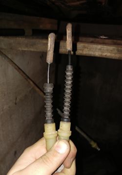

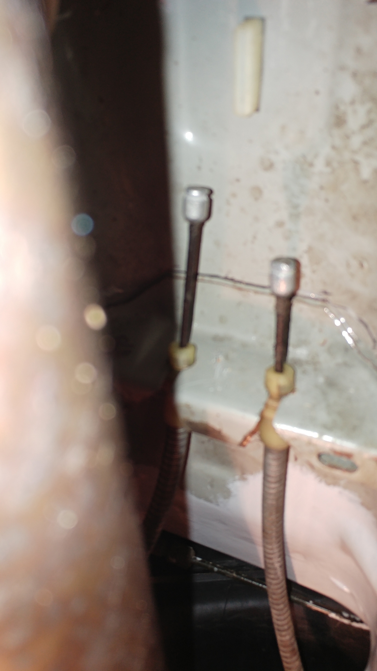

    Added after 4 [hours] 33 [minutes]:
    So I decided to check everything carefully. I took these plastics from the armor on both links to see if they had gone too little. Here, one end of both lines, as you can see armor entered the same:
    Focus Mk1: Manual Handbrake Cable Setup Issue - Cable Too Short After 2 Years Unused?
    The other end, the same situation:
    And here the length of the lines after maximum extension to one side:
    As you can see one is about 2 cm shorter.
    Now I don't quite understand what's going on. After all, I did nothing with these links, the brake once operated normally, the lines on this splitter for one line were of equal length. Has it shrunk? It's impossible.
    PS Ignore my question in the previous post. I didn't get it :)

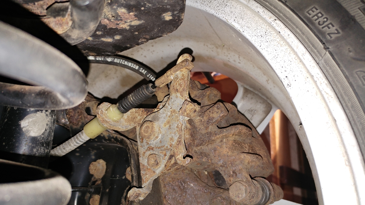

    Added after 21 [minutes]:
    I upload photos:
    one wheel:
    second wheel:
    Where the lines come off:
    now I noticed that even this longer line is a bit too short to put on this "splitter".
    Added after 6 [hours] 33 [minutes]:
    I shortened the wire armor with the saw blade, one by 3.5 cm and the other by about 2 cm. They are now of equal length. I have put together and for now everything is ok, manual works, the links are arranged evenly. The topic can be closed.
