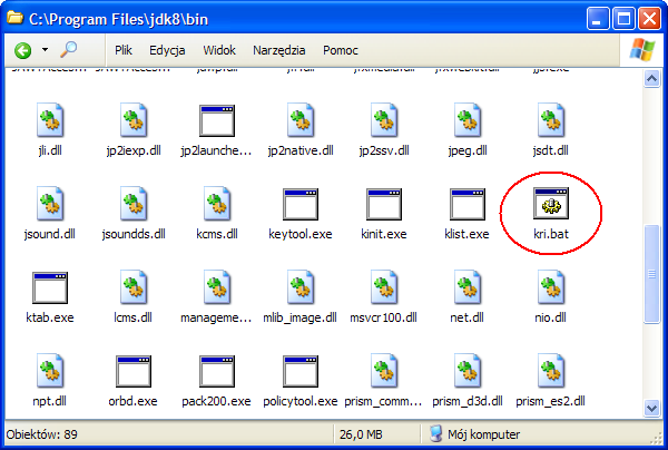

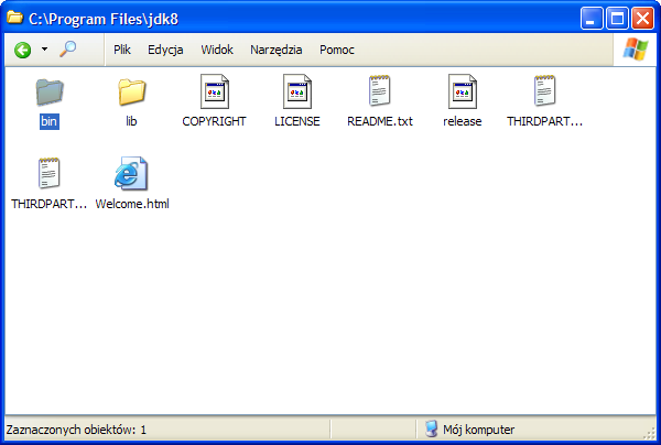

    [*: 52395d12f8] download java offline - Windows Offline 61.66MB - https://www.java.com/pl/download/manual.jsp " target="_blank" rel="nofollow noopener ugc" class="postlink inline" title="" > https://www.java.com/pl/download/manual.jsp
    [*: 52395d12f8] extract the contents of the archive using 7-zip 9.20 jre-8u171-windows-i586.exe - after extracting, you should have the file installerexe
    [*: 52395d12f8] extract this file to a folder jdk8 and copy the folder to the directory C. :P rogram Files
    [*: 52395d12f8] in the attachment in the archive kri.zip you have a file kri.bat - copy it to jdk8bin and run
    [*: 52395d12f8] add the path after the semicolon ; C :P rogram Filesjdk8bin to an environment variable Path
    Java 8 Installation Issue on Windows XP: Unable to Install, Offline Installer & System Specs
    [/ letter: u: 52395d12f8] It works for me :-)
    ATTENTION! The current version of 7-Zip 19.00 from 2019 unpacks the jre-8u171-windows-i586.exe file differently (too deep) and you need an older version, e.g. 9.20
    • kri.zip (276 Bytes) You must be logged in to download this attachment.

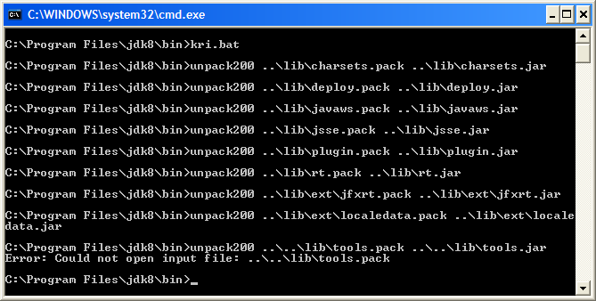

    GrzybMaślak wrote:
    Gelip, I did as you wrote above. however, it still doesn't work. I did everything right (hopefully), reset my computer, and it still doesn't work. What's next? Greetings!
    You must have done something wrong at one point. This is how the unpacked java w should look like Files program :
    And you have to run the batch file kri.bat from your location bin (program unpack200 has to extract some .jar files):

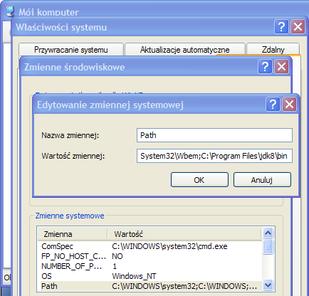

    Maybe a path in Path did you add wrong?
    Works 100%
    File kri.bat is exactly java version of the JDK jdk-8u5-windows-i586 but it works with the newer JRE - it just won't extract the file tools.jar which is not in the JRE jre-8u171-windows-i586 :
    PS Or maybe you need the JDK version ( jdk-8u171-windows-i586.exe 199MB) and not JRE (jre-8u171-windows-i586 61MB) ???

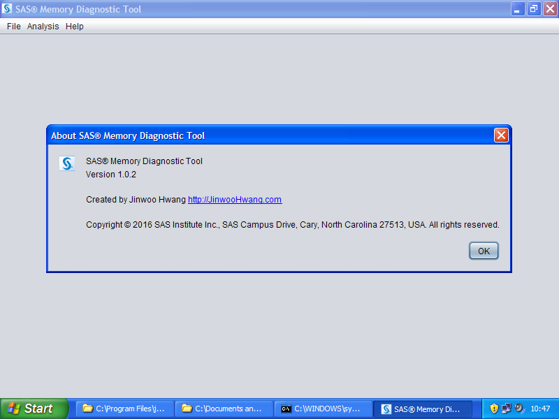

  • #17 17367357
    Gelip
    Level 36  
    Posts: 5249
    Help: 324
    Rate: 612

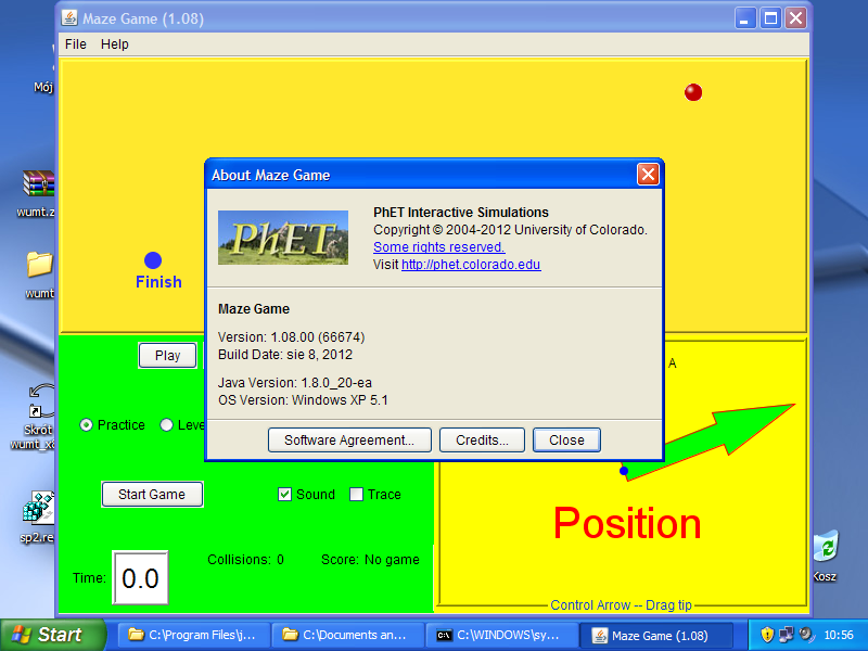

    Ramiro Roberto wrote:
    Not. This is the fault of Windows XP - JAVA 8 libraries are no longer compatible with this system. Or else JAVA 8 requires newer libraries than what Windows XP can offer.
    I just downloaded a sample application in .JAR format smdt102.jar and it works fine. You just have to run it from CMD like this:
    java -jar smdt102.jar

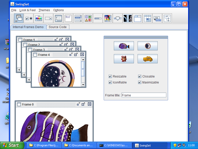

    You can also make a .bat batch file - it was on this forum: Problems opening .jar
    Added after 8 [minutes]:
    Another sample game in the .JAR format and also runs on WinXP :D :
    https://phet.colorado.edu/sims/maze-game/maze-game_all.jar " target="_blank" rel="nofollow noopener ugc" class="postlink inline" title="" > https://phet.colorado.edu/sims/maze-game/maze-game_all.jar
    And another http://www.cs.cmu.edu/afs/andrew/course/15/41.../jdk1.5.0_05/demo/jfc/SwingSet2/SwingSet2.jar " target="_blank" rel="nofollow noopener ugc" class="postlink inline" title="" > http://www.cs.cmu.edu/afs/andrew/course/15/41.../jdk1.5.0_05/demo/jfc/SwingSet2/SwingSet2.jar
    Added after 12 [minutes]:

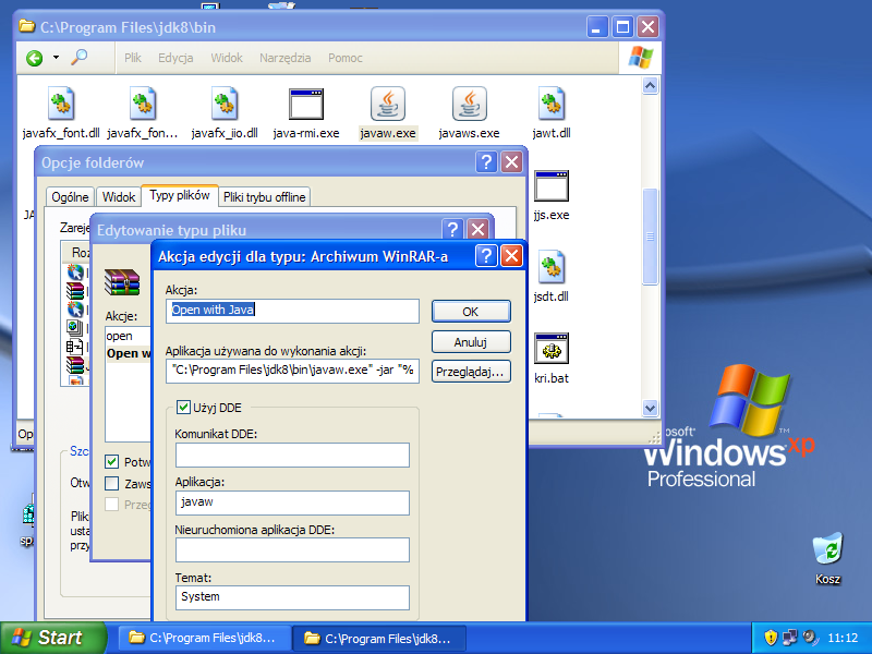

    Instead of opening in CMD or via a .bat file, you can add an action Default in the .JAR file type opened with an application javaw.exe :
    "C:\Program Files\jdk8\bin\javaw.exe" -jar "%1" %"
    Of course, we give our path to the file. From now on, just double-click on the .jar file icon to open it:

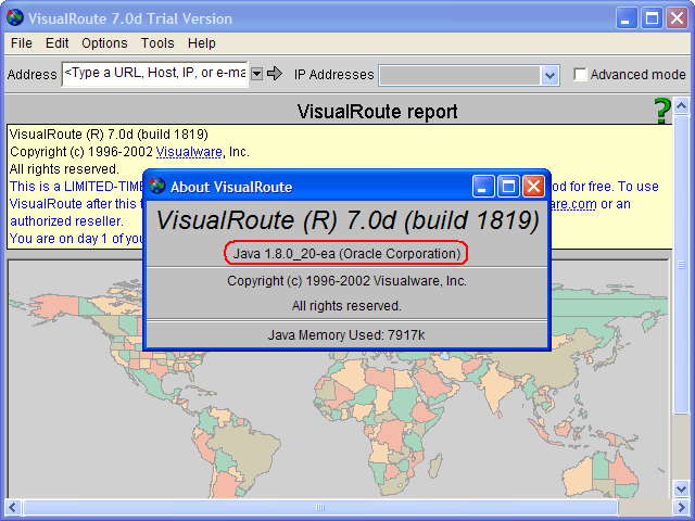

    Here are some examples of applications that do not necessarily require the latest JAVA 8. And it's not that Windows XP does not support JAVA at all.
