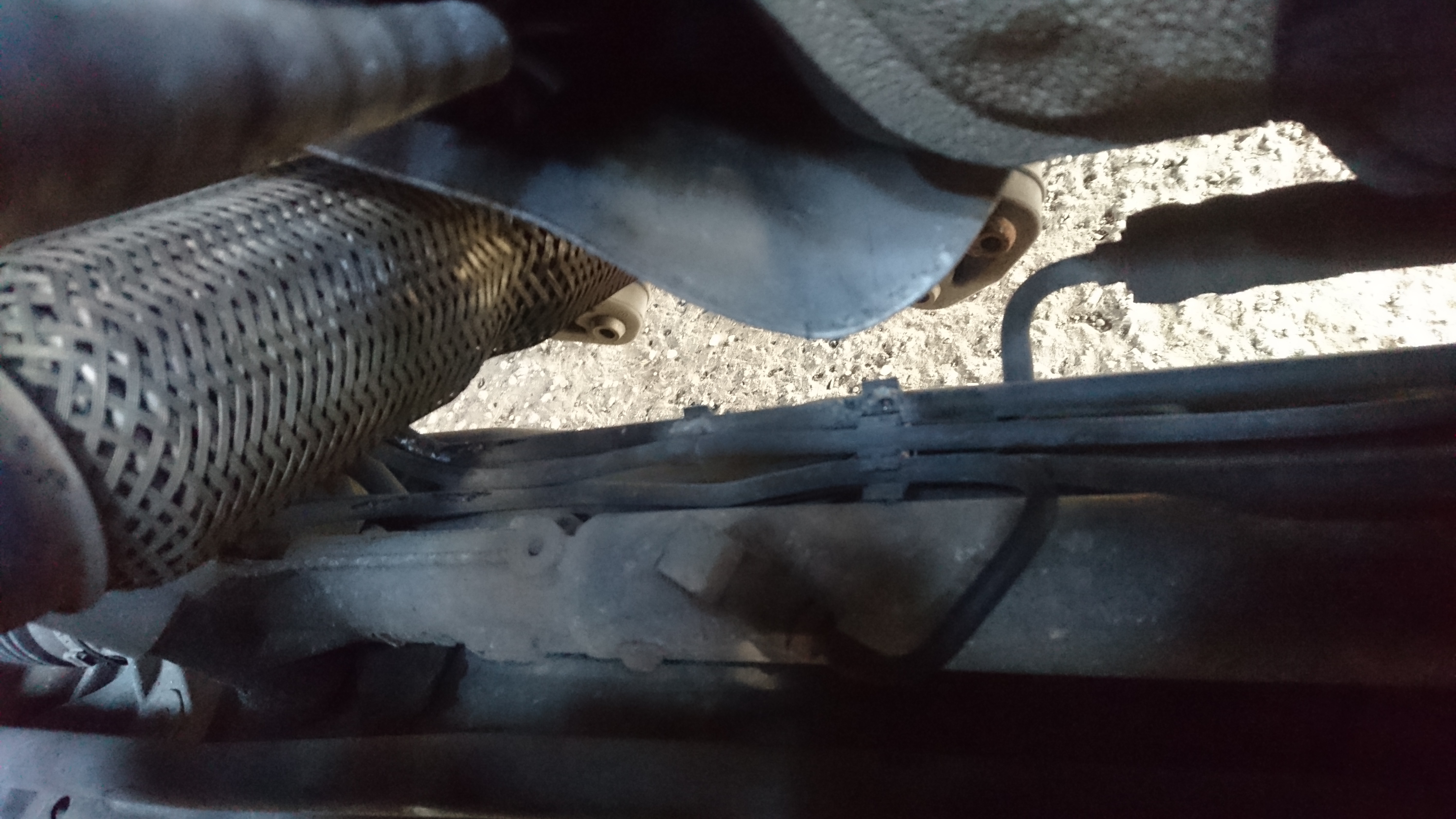

    Hello everyone! This is my first post, so please bear with us. Namely, I have a wv polo 1.4 TDI 2005 before the lifting AMF 75HP engine. The problem is vibration / humming from 1,400 revolutions to 2,000,000 and this happens in every gear. Driving at 90 km / h in fifth gear it is unbearable, this phenomenon occurs both during acceleration and when braking the engine. I replaced all 3 cushions with new ones, absolutely no improvement, new driveshaft, no improvement, oil, filters. There was a lot of play on the differential, so I replaced the gearboxes without any changes. This engine does not have a dual mass flywheel. What do you think it can be because I already lack ideas. Could this be due to the torsional vibration damper on the clutch plate? At idle, in this RPM range, you can also feel trembling, but much weaker with the clutch engaged and disengaged. Please help.

    I would take a closer look at the braided line from the exhaust manifold, but it's just out of curiosity, connect a kkl interface, it costs PLN 20 and check the condition of the unit injectors that have plus or minus.

    Thank you. Diagnostics was carried out at the Bosch workshop and according to them, everything is within the standards. I just checked the braid it looks like it has a break in the middle but is it possible that it vibrates so much? Your 1.4 TDI drives normally at 90 km / h in 5th gear?
    • Polo 1.4 TDI 2005 AMF 75HP vibration and hum 1400-2000rpm, clutch damper issue? DSC_1109.JPG (4.73 MB) You must be logged in to download this attachment.

    Replace the braid.

    Braid replaced. It is quieter because there was a leak, but the vibrations are still there. I have a question about the pillows, they need to be set up somehow because I put them on, how to say it (full) ? and the right driveshaft has a special task, this tubular because I do not know what to call it correctly, something is inside it or just like that looks like
