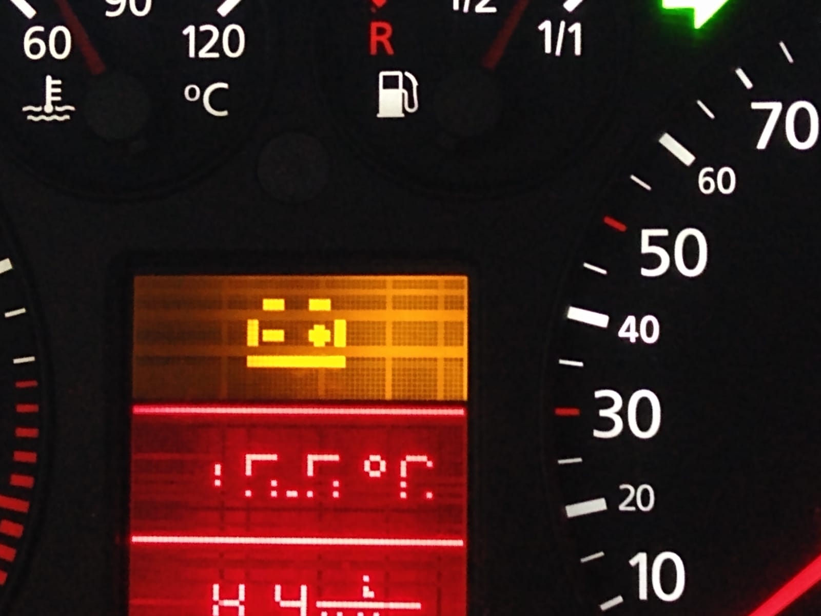

    Audi A3 8L 1.6 2002R patient.
    The yellow battery on the on-board computer is burning (fis) and the climate control clocks are blinking, the radio sometimes dims.
    Replaced the voltage regulator, the battery shows 12.8 at a standstill when charging 14.4.
    Is it possible that the computer has an error and needs to be cleared? It comes after replacing this regulator does not read that it has been replaced?
    Is there any other reason for this yellow battery?

    But why is this indicator YELLOW? This is for sure about the battery? Maybe fluid in the radiator?
    I don't know Audi, but in Mercedes the customer added water in the battery to the plugs, and the yellow light was still on ... :)
  • #6 17335775
    kajdasz27
    Posts: 6
    This is what the indicator looks like, rather something downstream if there is a battery; D
    Does anyone have a description of the computer controls for the audi a3 8L?

    It has a plus and minus, it really leaves no doubt that it is a battery.

    One more thing, where we have kilometers that can be reset, it is not displayed only by the inscription "sich"
    If this battery does not light up, it normally shows kilometers.
    In German it means "alone". This is what the translator shows because the car used to be from Germany.

    These photos of yours are (sorry) but they only take up space on the server - they have no other use ;)
    "Sich" can also be an abbreviation of the German "fuse" (Sicherung)

    A yellow battery light means the battery voltage is abnormal. It has nothing to do with the charging itself or the alternator.
    Info taken from here: https://www.a3-freunde.de/wiki/FIS_Symbole_%C3%9Cbersicht
    It looks like the battery isn't necessarily "good". What is the voltage at a standstill, one hour after turning off the engine? It should be no less than 12.6V. I understand that the clamps are clean and well tightened, the connection of the body with the negative of the battery is also good and reliable?

    This message means that the voltage on T30 (pin 23 in the blue battery connector) is below about 9V. If you pasted a picture of the entire meter, I would tell you whether it was his fault or the installation (if the voltage is really low, the meter barely lights up, you can see it). If it's Jaeger, I say it's damaged, if VDO (which I doubt) measure the voltage.
    Added after 14 [minutes]:
    Added after 10 [minutes]:
    Now I just read the rest of the thread. Your "SICH" stands for "Sicherung" which means fuse.
    It's about fuse no.15 (at least in the Audi TT, the meter is the same, but I do not know if the fuse is) but it is not damaged, see here:
