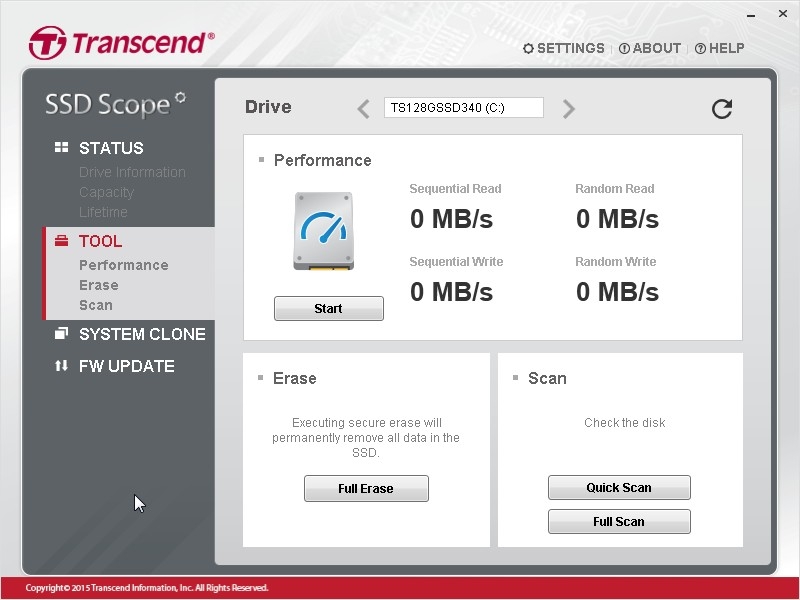

    Often the SSD manufacturer equips the equipment with appropriate software I use Transcend,
    Complete removal of data from the SSD drive on which Windows is installed.
    Intel also has tools -
    https://downloadcenter.intel.com/download/27656/Intel-Solid-State-Drive-Toolbox
    https://www.dobreprogramy.pl/Intel-Solid-State-Drive-Toolbox,Program,Windows,28552.html
    The solution can be effective encryption, e.g. with the whole disk truecrypt, the buyer will not have access to the data without knowing the password.
