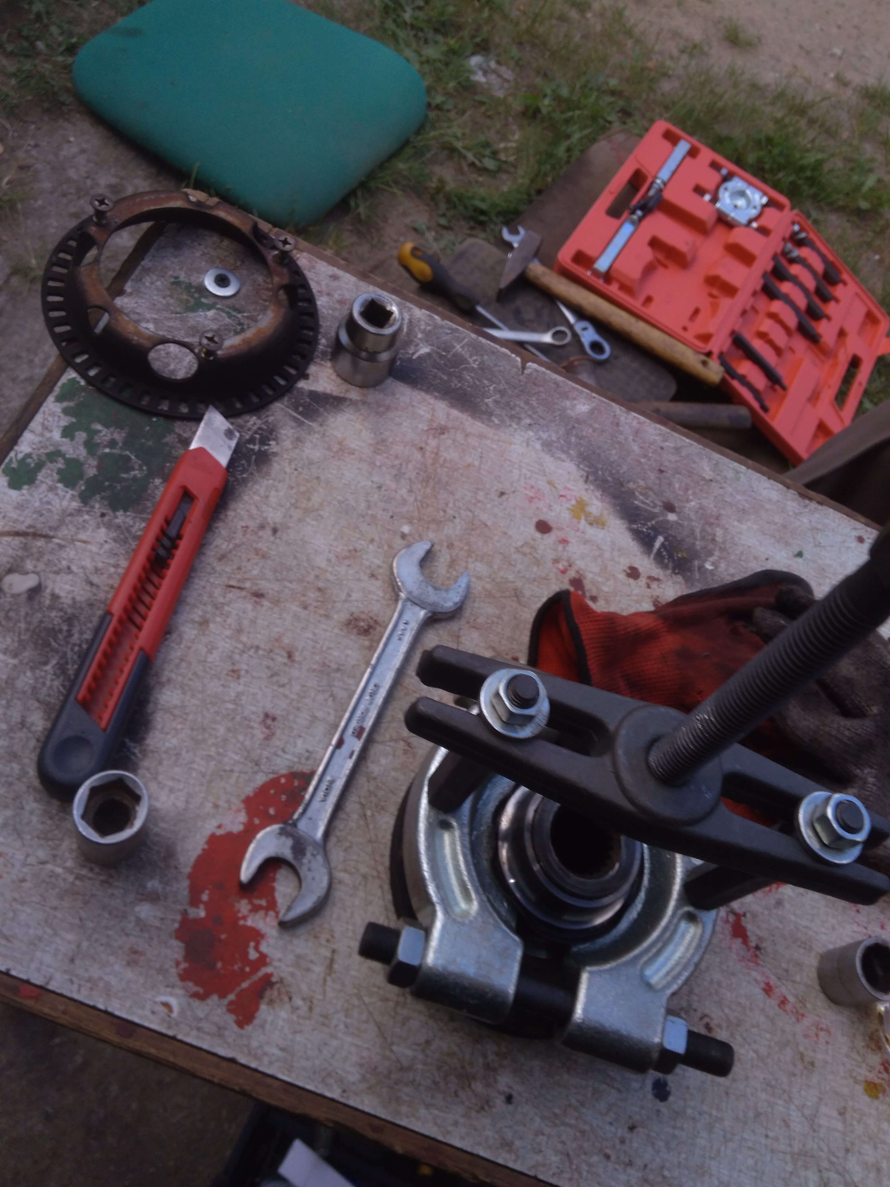

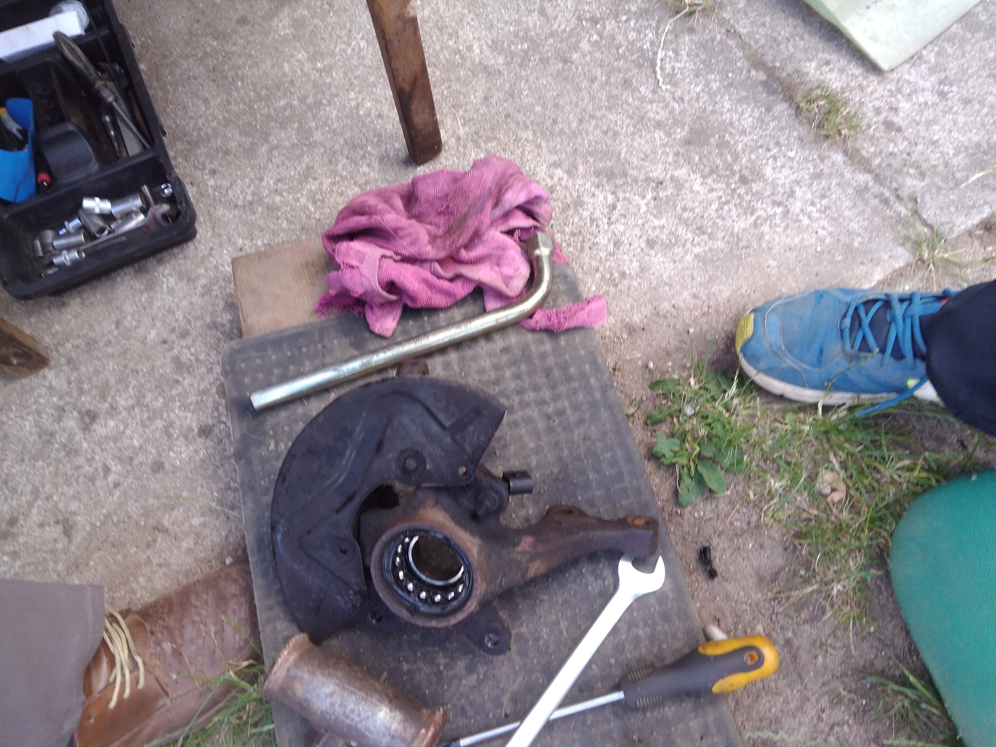

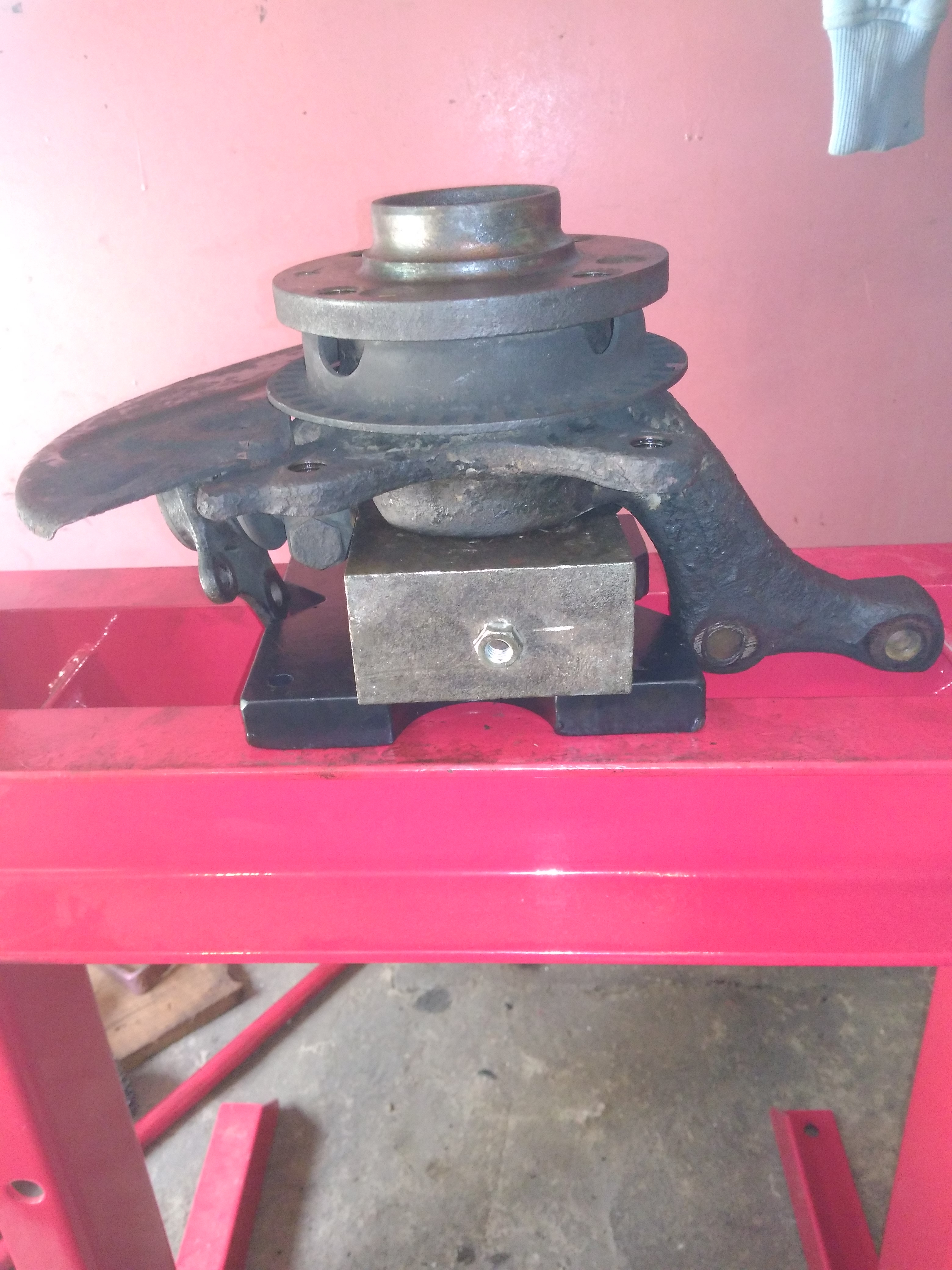

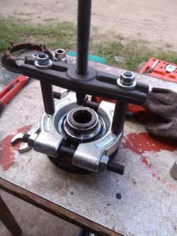

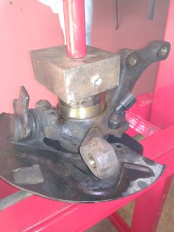

Front Wheel Bearing Replacement Process for VW Polo 6N 98: A Detailed Walkthrough
