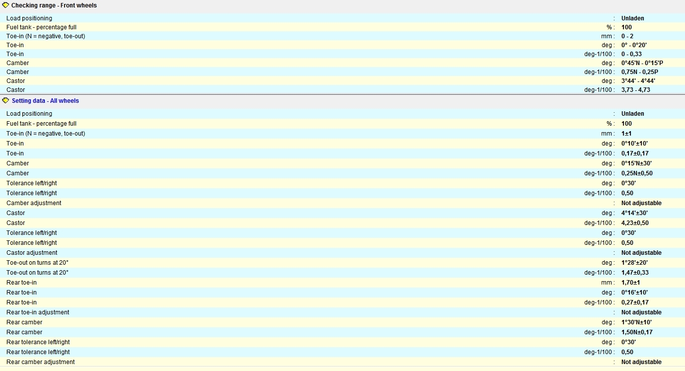

    I replaced the front suspension plastic-rubber bushings (silentblock-i) in VW POLO 9N. I would like to check the wheel alignment now, but nowhere can I find what these angles should be. If anyone knows the toe-in parameters of the Polo 9N and wanted to help, please answer. If someone has toe-in and camber angles in 9N, it will be even better.

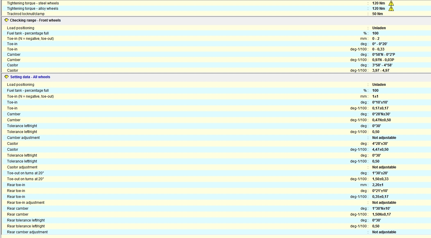

    You did not specify the exact model, and I do not know if the parameters are identical with the change of the engine version (vehicle weight).
    Here you have some 9N randomly selected.

    You choose sooner: in app. VOLKSWAGEN Polo IV reg. wheel settings for various suspensions, descriptions in Polish.

    Excuse me. Indeed, I haven't given the exact model. Polo 2002 petrol, 1.4, 16V, 55kW, 75HP, BBY engine, 5-door. This is probably enough to identify the car.
    Thank you for the answers above. The data shows that the convergence should be in the range of 0.0 degrees to 0 degrees 20 '. I think that it will also be the case in the model I gave.

    This is the data I meant. Thanks for the answers.
