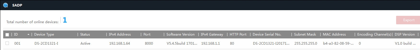

    HIKVISION DS-2CD1321 camera.
    As an encoder, I'd like to use OBS STUDIO (unless it's something better).
    I can't get a camera image in OBS STUDIO.
    I suspect I have something wrong with the RTSP path. The question is, what should the correct path look like?
    Information about the webcam here:
    login: admin
    password: admin1234
    RTSP HIKVISION IP Camera DS-2CD1321 & OBS Studio: Correct RTSP Path Setup & Troubleshooting
    I entered RTSP as input for streaming in OBS, but no image.
    rtsp: // admin: admin1234(_at_)192.168.1.64: 8000 / streaming / Channels / 101
    What could be wrong here?
    I used the RTSP formula for HIK found on the internet:
    rtsp: // : @ : / streaming / Channels / /

    And try on something other than OBS Studio, and possibly change the password to e.g. Admin1234 (often required upper / lower case + numbers)
    Ps: the default port for RTSP is 554, and you enter 8000, which is from the server - unless you have changed something ...

    It followed such RTSP:
    rtsp: // admin: admin1234(_at_)192.168.1.64/Streaming/Channels/101
    Thanks for the help
  • #9 17351554
    iDest
    Pupil
    Posts: 166
    Rate: 11
    The camera transmission caught up after such an RTSP:
