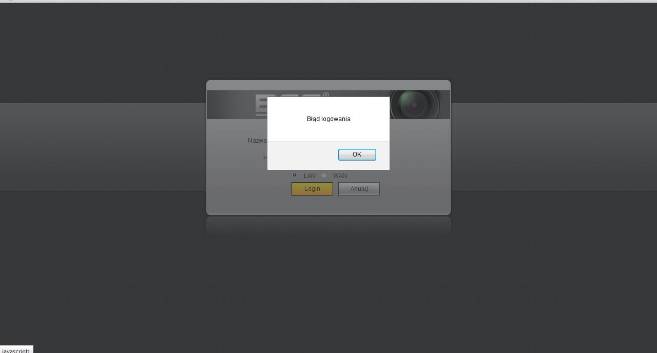

    I have another problem, I cannot access the recorder remotely, the username and password page opens, and after entering the login error pops up. This happens as one wants to get through the noip domain. logging in locally via an IP address is no problem. On the router, all redirected to the recorder because I changed the standard port 80 to 1080.

    You set a fixed IP for the recorder, redirected the ports on the router?

    Yes, the fixed IP set on the router, the forwarded port, after the IP address connects without a problem if you want to connect after the ddns address, it also connects because the reversal from the recorder appears, but after entering the user and password, the login error message appears as in the picture .
    What does everything mean?

    Everything, i.e. http, tcp and udp ports, but it works, it turned out that the error was in the port of tcp or udp not enough numbers, Czech error.
    But now I have a problem with access from the phone I have a program that I downloaded using qrcode provided by the recorder and July I do not have a preview from the camera maybe the program's fault you have maybe some proven or some idea what may be wrong.
