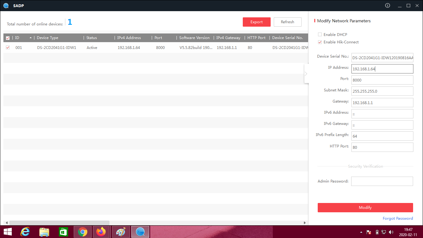

    Problem with wifi cameras with the given model in the subject. In the SADP program I set a password, Active camera and all that I was able to do. I cannot log in to it through a browser or any other means. So what to do to get a preview of the cameras? They write everywhere but everything I did does not work and it pisses me off: <

    You set the password and gave them the IP addresses from the router pool?

  • #4 18465222
    Voxx11
    Posts: 14
    Rate: 8
    HikVision DS-2CD2041G1 problem with connection to camera preview
  • #5 18465230
    sosarek
    Posts: 83875
    Help: 9320
    Rate: 15532
    Set a lower address in the range 192.168.1.10-50 and check.

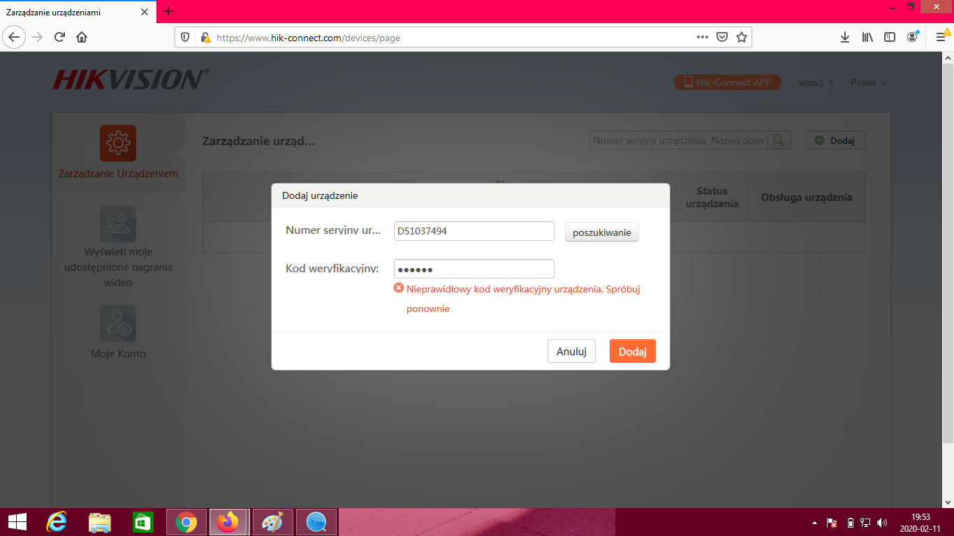

    PS: On the hikconnect website I tried to add a device and I came to the verification code stage and none of the matches, fancy, from the box, the one with the email, all the passwords I have and so where should I get this code or how to generate it?

  • #7 18465260
    dawidedziu
    Industrial cameras specialist
    Posts: 3009
    Help: 500
    Rate: 642
    192.168.1.64 is the default IP address - if you have two cameras connected at the same time, there may be problems with e.g. logging in to the camera. Connect only one and check if you can log in to it.
    The verification code is probably set in the camera itself - in its network settings.
    Please try from Internet Explorer.

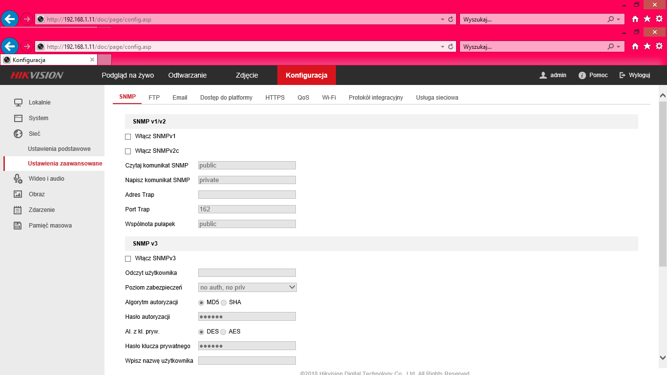

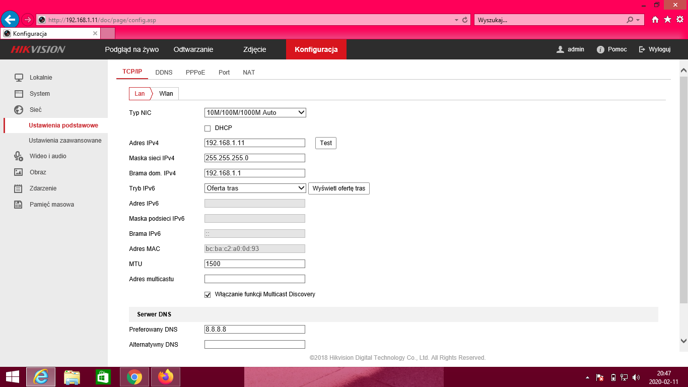

  • #11 18465286
    Voxx11
    Posts: 14
    Rate: 8
    sosarek wrote:
    Voxx11 wrote:
    How to enter the camera's network settings to check this code?
    Log in to it via a browser.
    After changing the address, save the settings, wait for the camera to reboot.
    This is how logging into the camera looks like.
    The standard ip address 192.168.1.64 was the same and the same with every other one.

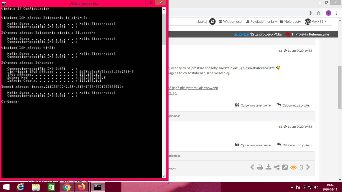

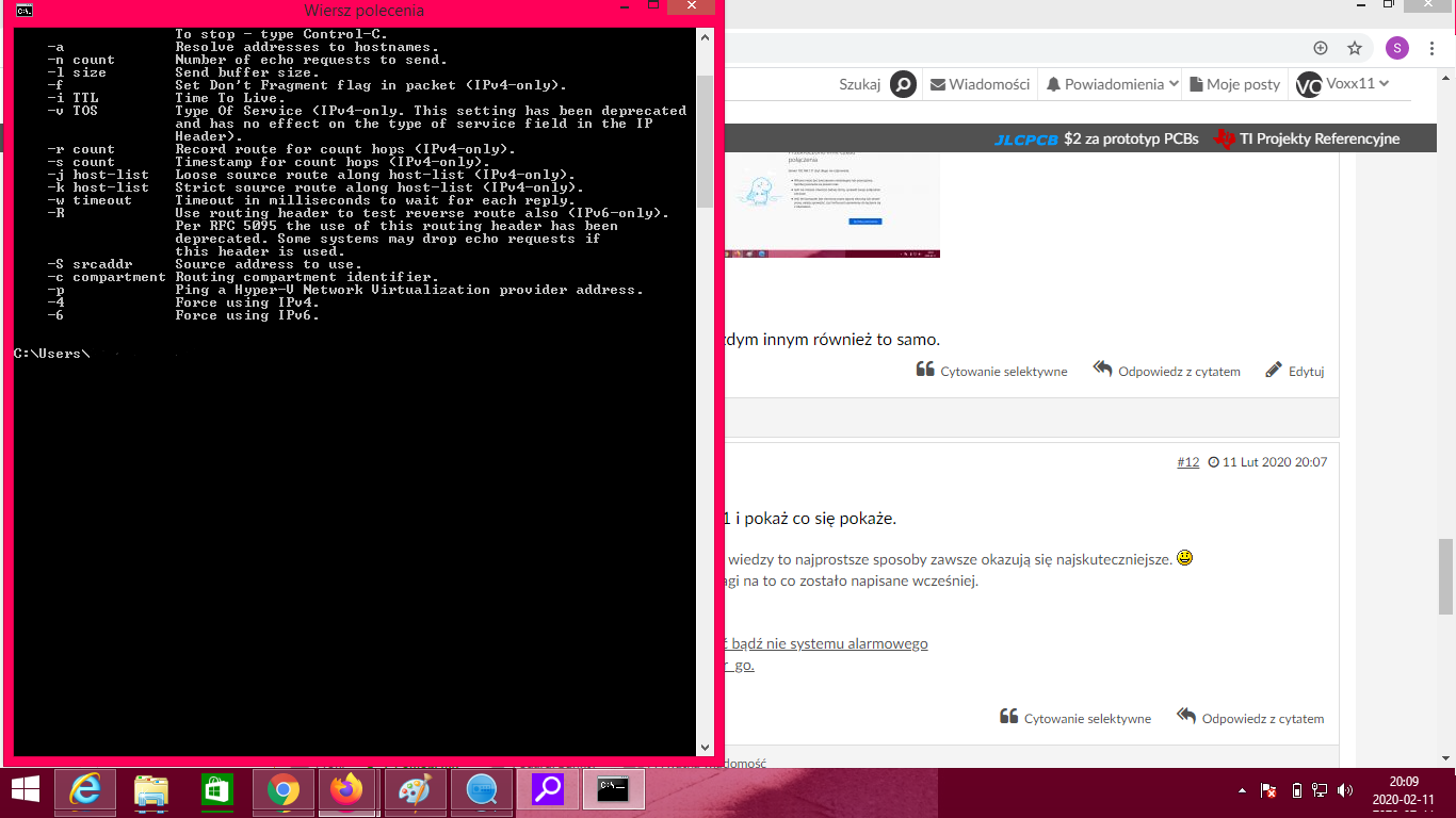

  • #12 18465297
    sosarek
    Posts: 83875
    Help: 9320
    Rate: 15532
    Weird...
    Press Win + r, type cmd, in the window enter ping 192.168.1.11 and show what appears.
    Z
    Pka, Poznań, 60-850

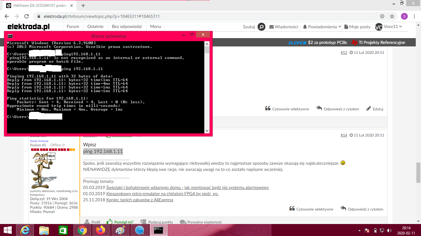

  • #13 18465311
    Voxx11
    Posts: 14
    Rate: 8
  • #15 18465327
    Voxx11
    Posts: 14
    Rate: 8
  • #17 18465339
    Voxx11
    Posts: 14
    Rate: 8
    sosarek wrote:
    So the camera is pinging.
    In the browser, enter - 192.168.1.11:80
    Access Error: 404 - Not Found
    Can't locate document: /notSupported.asp
    such info ...

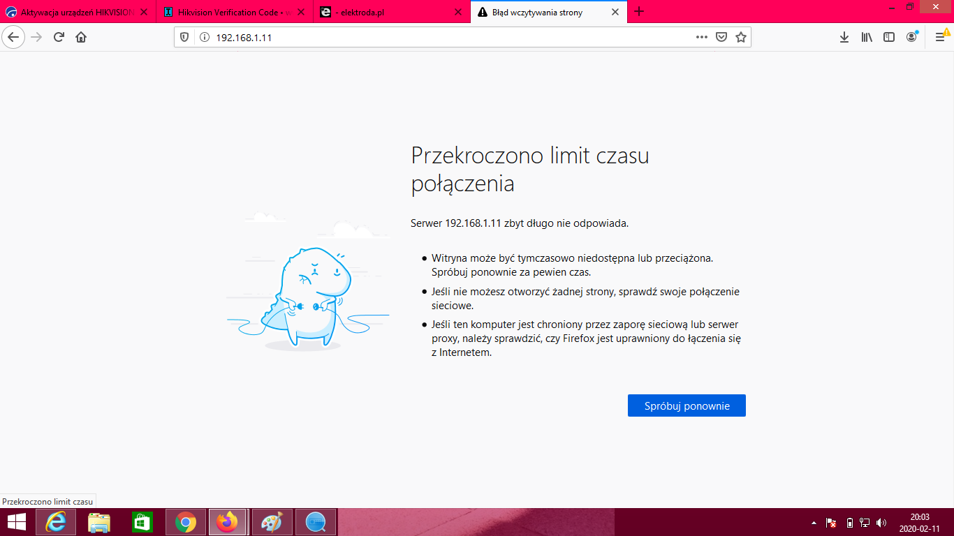

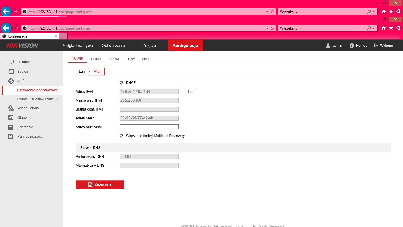

  • #21 18465421
    Voxx11
    Posts: 14
    Rate: 8
    sosarek wrote:
    It should work with any browser.
    After entering the settings, there should be a Network / Network and something about WiFi where you need to find your network and connect to it.
    Not necessarily, only works with explorer. Chrome, mozilla, etc. do not contact
    Something needs to be changed here?

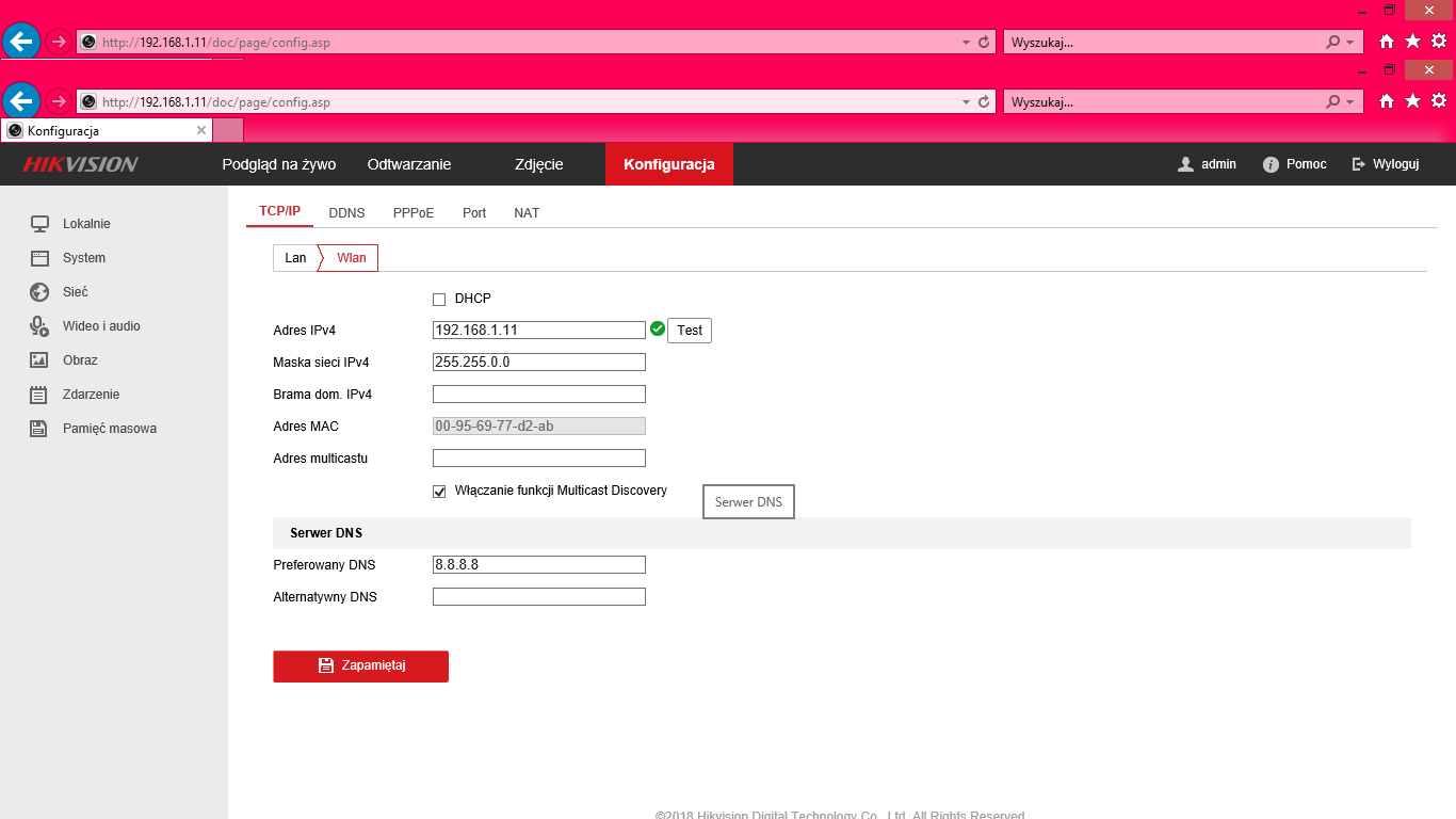

  • #25 18465465
    Voxx11
    Posts: 14
    Rate: 8
    sosarek wrote:
    Disable DHCP for Wlan, give it an address manually, show advanced.
    So in the sense of yes?
    Advanced ... any specific card?
  • #27 18465491
    Voxx11
    Posts: 14
    Rate: 8
    Got it, connected to my network in the wifi tab, everything works as it should. Thank you my friend for your help. Can I repay you somehow?
    PS: Why do you think other browsers are not responding at all?
    sosarek wrote:
    WiFi in advanced.
    Add the default gateway under IP.
    The default gate, what is it?
  • #28 18465506
    sosarek
    Posts: 83875
    Help: 9320
    Rate: 15532
    Router's IP 192.168.1.1
    Configure yourself access to the platform to have an external view.
