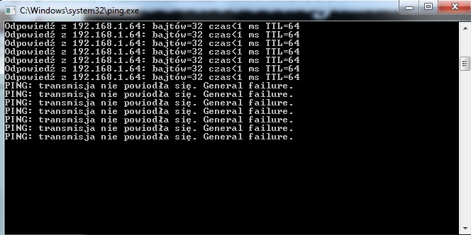

    192.168.1.103 - Computer
    192.168.1.64 - Such a camera shows me in the program
    Only I disconnect the cable from the computer with internet and connect the camera directly to the computer

    I bet that if you unplug your computer from the router, your computer will lose its IP address.
    Is the camera on your 12V power supply?
    Option 1.
    Set your computer's permanent address, e.g. 192.168.1.103 and check if you can log in to the camera via the browser.
    If you succeed, remove the camera in IVMS settings and add it again in this program.
    Option 2.
    Connect your computer to the router and also a webcam. Check if you connect the computer with the cam.

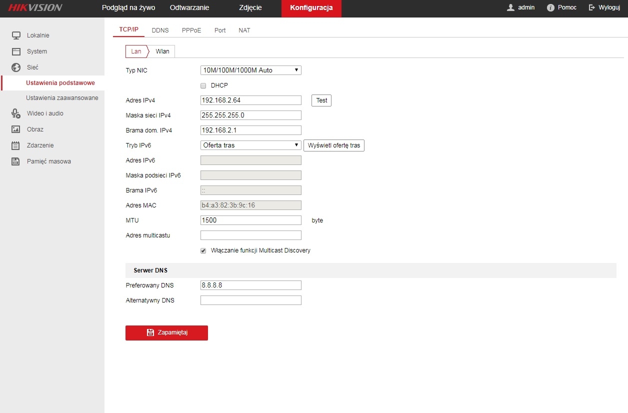

    The camera menu was successfully accessed. I changed the ip address of my computer's network card to a permanent one and it helped.
    By the way, I would like to ask for help in the matter of providing remote viewing of the camera image.

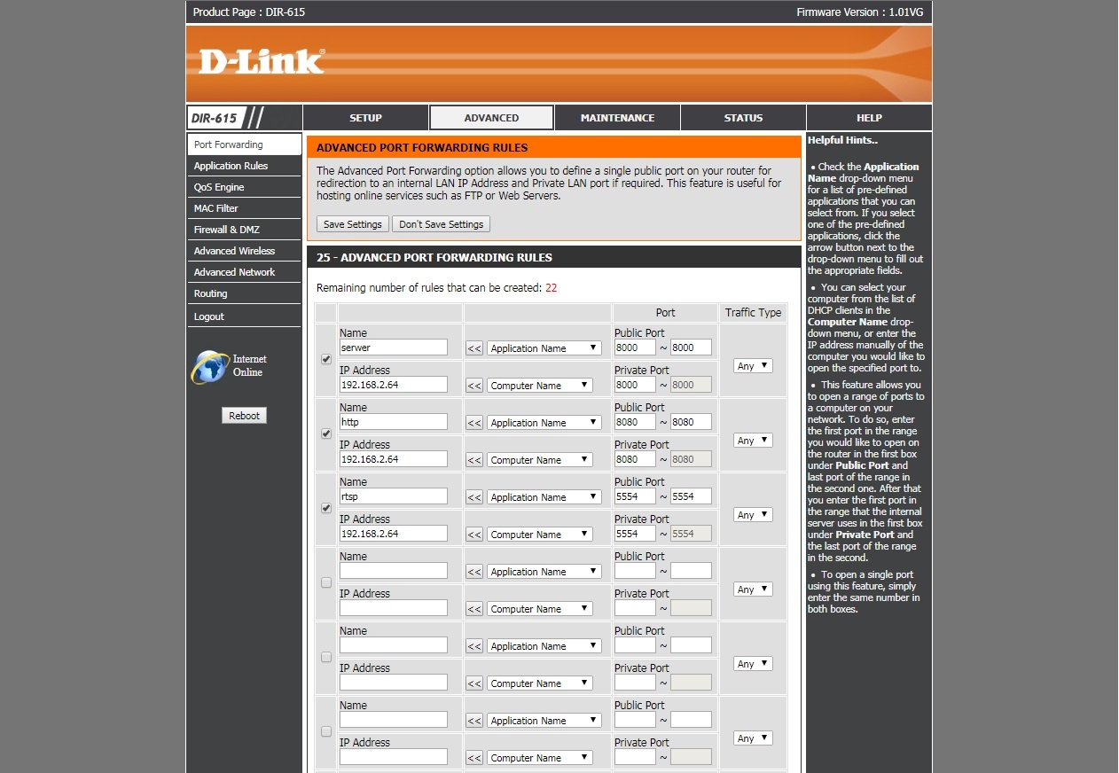

    I connected the camera to the router, changed its ip to 192.168.2.64 (router 192.168.2.1), everything is ok, but I do not know how to route ports on the router (D-Link 615).

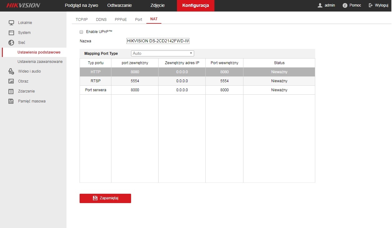

    I changed the ports on the camera to those recommended by the manufacturer
    HIKVISION DS-2CD2142FWD-IWS Camera Connectivity Issue: Fails to Connect via iVMS-4200 & Web Browser
    And in the router I redirected the ports
    I am not sure if I did everything right, because I will not see the external IP address in the camera in the NAT tab.
    Anyone know how to deal with this? :)

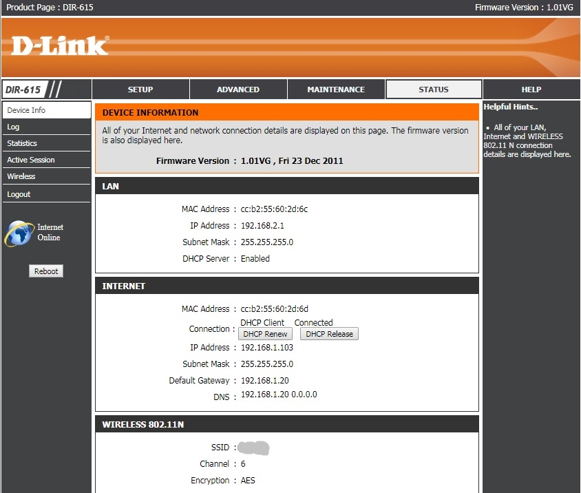

    Fixed IP address, radio internet

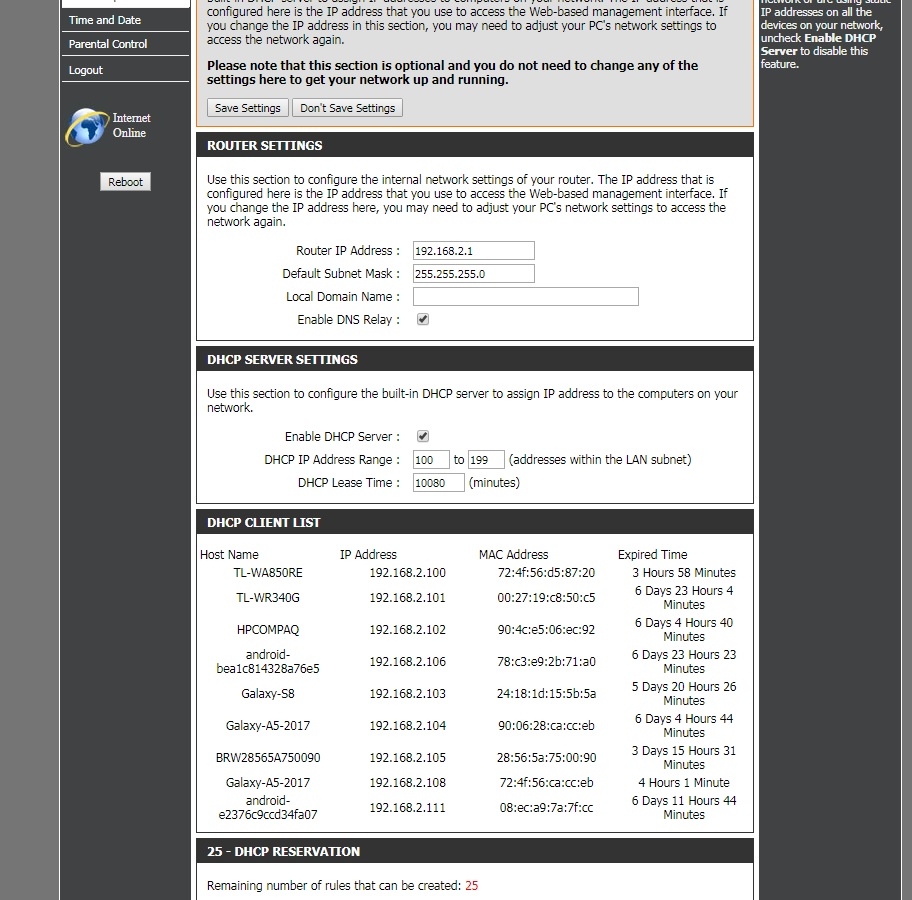

    Insert screenshots from the "Port" and "TCP / IP" tabs from the camera and local network settings from D-Link.

    Remember that when you set up a redirection, you can only check the operation from an external IP address.

    HIKVISION DS-2CD2142FWD-IWS Camera Connectivity Issue: Fails to Connect via iVMS-4200 & Web Browser HIKVISION DS-2CD2142FWD-IWS Camera Connectivity Issue: Fails to Connect via iVMS-4200 & Web Browser HIKVISION DS-2CD2142FWD-IWS Camera Connectivity Issue: Fails to Connect via iVMS-4200 & Web Browser
    I tried to log in from an external IP address in the form IP: 8080, but it doesn't work
