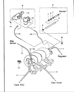

    Hey
    The Check light came on, I immediately checked the hoses under the hood. And the EGR hose is hanging around, I can't get to where it should be connected?
    Lanos 1.6 16V: EGR Hose Disconnected, Check Light On - Connection Location Advice Needed
    [img-1]

    Look for a small inlet port. It can be so hidden that you can't see it from above

    The V-GIS is to be on the bulkhead, under the fuel filter.
    If you need photos, I can take them, but I will write right away that I removed the bracket a long time ago ...

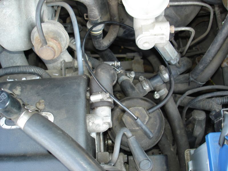

    I have all the pipes on the bulkhead

    Good, now look where I wrote. The tube to the valve enters the upper port.
    Did you pull that tube out, was it already lying? Half of the Daewoo drives with the EGR valve disconnected, and the only error that can show up from the EGR is when the egieerem control solenoid is disconnected. Self-disconnection of the plug seems doubtful to me.
    Check lit up and what next? Increased, decreased engine speed? Removed tube means left air with open solenoid valve and different engine speed.
    Any other symptoms?
    So did you even read the error that shone?
    What you found and showed did not have to generate an error that you can read yourself.

    I found the cube (felt it) but I will have to unscrew the wheel and the hole next to the alternator will be easier for me to get to and install the hose. In general, the check turns on after some time with higher revolutions.
    By the way, the gas controller fell, when I replace it, I will see if the check lights up. The car runs ok, it is no longer muddy, now Brc Storm driver.

    In the end, I dealt with Check, the egr tube also helped in the proper operation of the engine, it does not go out, the revs are sticking. Check lighted up sporadically and went out for good after replacing the gas controller. Everything is back to normal.
