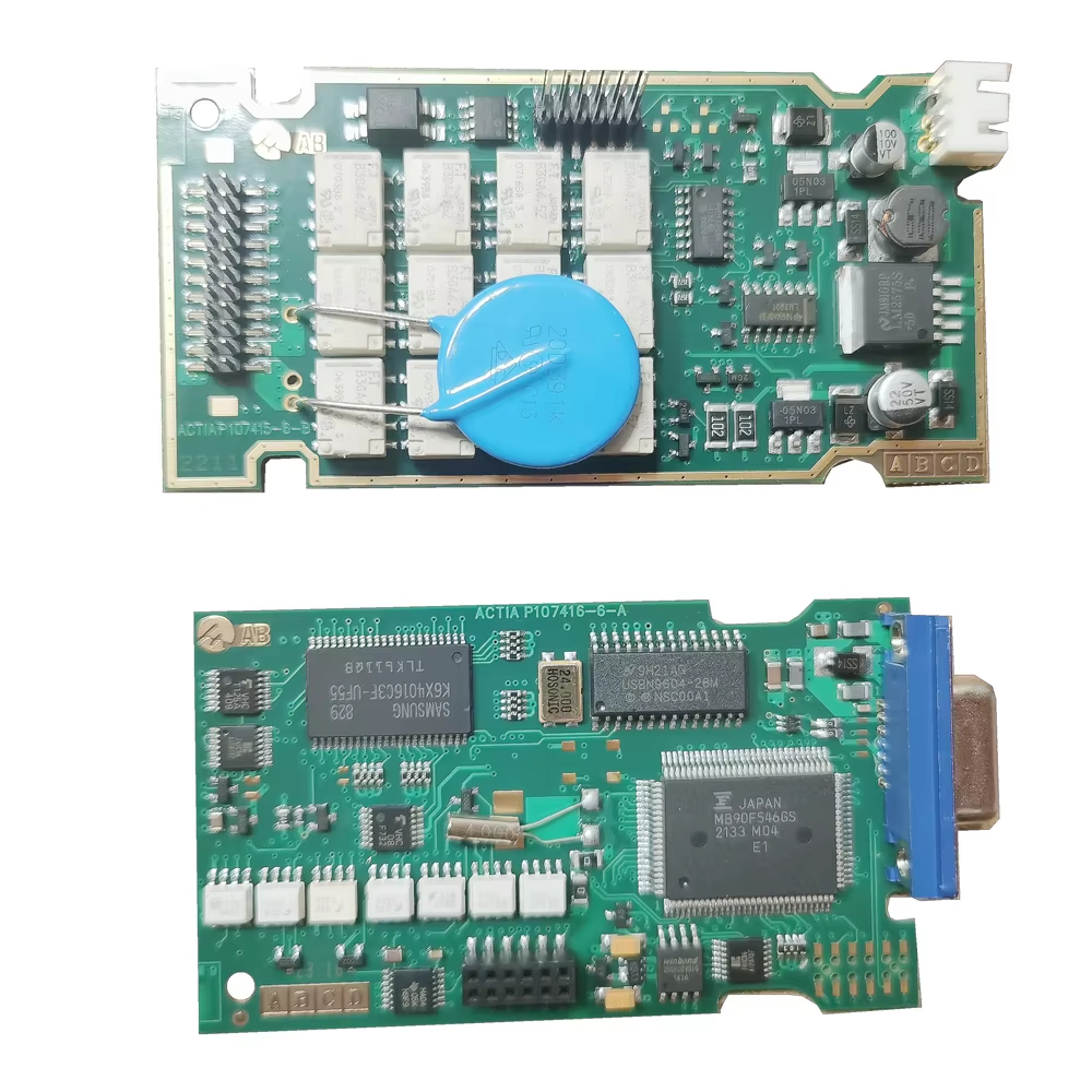

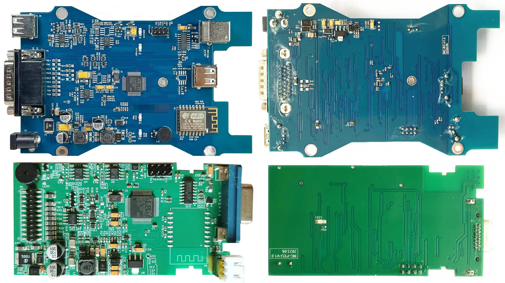

    Jahowski wrote:
    Good afternoon,
    I ran into a similar problem, while it has slightly different symptoms. The cable is probably a WiFi quinol too, SuperCAN sees it and shows that there is voltage from the OBD. In DiagBox it also has no problem seeing that it has the VCI connected. On the other hand, it doesn't automatically find the VIN and when I type it in from my finger, when the two apps to choose Diag and PP2000 show up, neither works. I can click on it as much as I want and still nothing opens. The patient is a Peugeot 307 ~ 2003.Is there anything that can be done about it?
    It can be done, you need to replace it with something that has the correct circuit boards inside and reports in the device manager as ACTIA not CH343. Some dealers write that it will work for cars after 2006, some omit this inconvenient fact. In addition, the fact that the PP2000 does not open is the fault of putting an old software version on a 64-bit system.
    This version will work:
    Two electronic boards labeled ACTIA. The top board features a blue capacitor, the bottom has more integrated circuits. .
    This one won't:
    Two images of electronic boards, one blue and one green, shown from both sides.

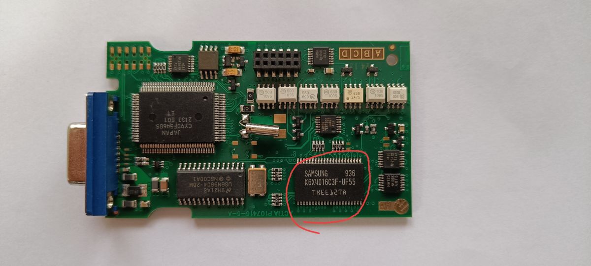

    #26 21450793
    Pavololo
    Posts: 12
    Ok, thanks for the hint, I'll try it today.
    >>21450550 Using the USB hub did not yield positive results.
    Is this a physical fault or a firmware fault for example?
    Many years back someone had a similar problem here on the forum, only that on his two laptops Diagbox worked and on two it didn't, and also "unknown device". In the end it is not known what caused it, because the topic died.
    Is there a possibility that this is the fault of a particular laptop?
    Image of a circuit board with electronic components, with a Samsung integrated circuit highlighted. .
    Is this particular component the culprit? I know no one is clairvoyant, but maybe there is an electronics person here. I found a video on YouTube as some Romanian spec shows that replacing this component fixed the issue.

    Pavololo wrote:
    Is this a physical fault or e.g. a firmware fault?
    Many years back someone had a similar problem here on the forum, only that on him on two laptops diagbox worked and on two did not, and also "unknown device," ultimately it is not known what was the cause because the topic died.
    I know of several cases where the interface "didn't like" the laptop- but using a hub took care of the issue.
    Pavololo wrote:
    Is this component the culprit? I know no one is clairvoyant, but maybe there is an electronics person here. I found a video on YouTube how some Romanian spec shows that replacing this component fixed the issue.
    This is a Statis RAM bone, there is no guarantee that it is the culprit.
