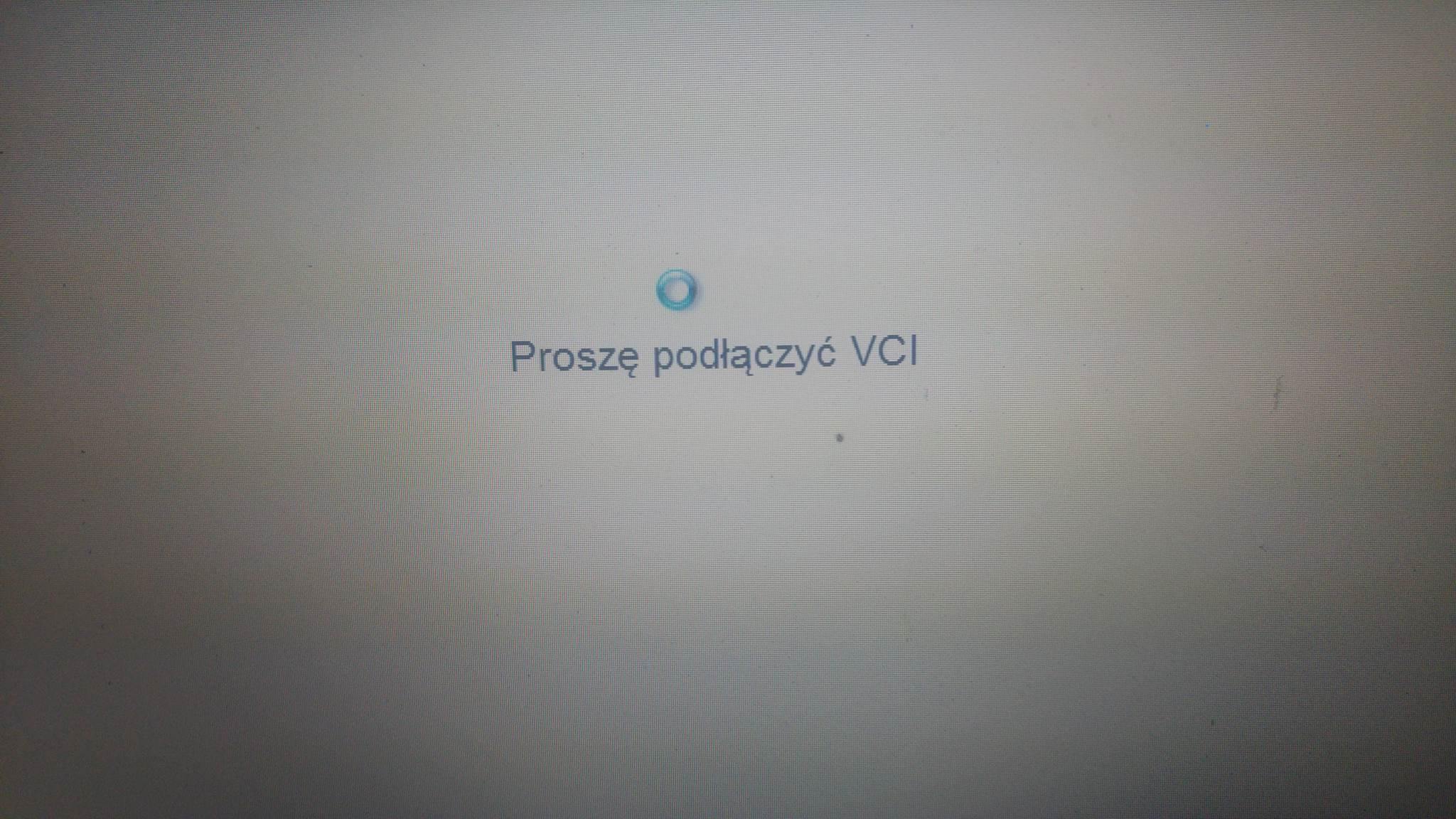

    Hello, I have a diagnostic computer that has worked well so far. For some time I bought a Peugeot 407 there is an rt3 radio in which I would like to activate the parking visualization function and activate the aux socket. I found out that it can't be done with an ordinary delphi or autocom program. So without waiting I downloaded PP2000 but it turned out that it could not be launched on windows 7 so I installed Windows virtual pc and then I started it on 7 Xp I downloaded the program there of course I installed the driver for the OBD interface. The program starts normally and then when I choose the make and model of the car a message pops up "Warning You cannot start peugeot planet Office for the following reasons; Peugeot planet interface is not connected to the usb port.; Peugeot planet interface is being used by another application. So you should connect the interface to the computer and close the remaining applications. Itu tk in and my problem. I downloaded other drivers, it did nothing, I transferred the USB plug to other sockets also with no result. Not knowing what to do I decided to download the DIAGBOX which can also be telecoded radio. I installed it on the same computer but on the win 7 system. After which I start the program and there VCI message not connected, I don't know what's going on, I remind you that other programs work normally and the computer connects through it with the car. Please help or directing on some other topic related to it.
    Computer parameters
    -Windows 7 ultimate 32 bits
    - ACER name
    - Intel [R] Pentium Dual T2330 1.60Ghz processor
    - Frame 2.5 GB
    Interfeis to;
    AUTOCOM CDP BT
    Series 3555 https://obrazki.elektroda.pl/6893340400_1489169441.jpg" target="_blank" data-fancybox="gallery" data-thumb="

    How do you want to run the program with hardware rigidly associated with other software? Buy interface for PP2000.

    So because of this interfeis I won't be using this program. Or maybe there is another program thanks to which I can do the telecoding.?

    This interface will only work with a dedicated program. Look for someone who has Proxia should be able to grasp (though I haven't done that at the time).
