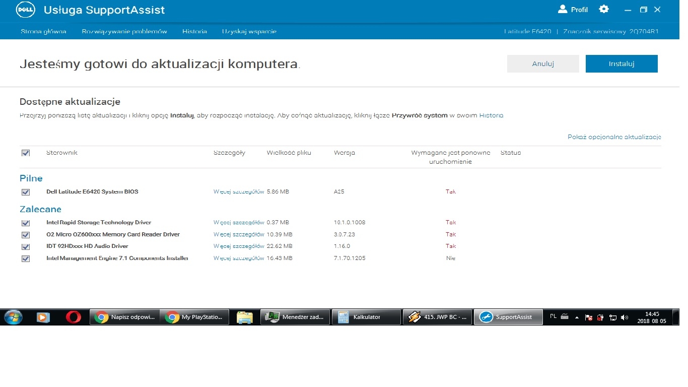

    I have a problem because I have a 300 Mbps optical fiber from Orange, when I tested my laptop I always had a maximum of 99Mbps, because I was sure that the network card only had a range of up to 100Mbps, but I read Orange`s guide, and it is mentioned that I have Windows 7 on their website http: //www.orange.pl/kartalan and according to the instructions, it turned out that my card has the 1.0 Gbps option.
    this is a screenshot of my card
    The Network Card has a speed & duplex of 1.0 Gbps, but only works up to 100 Mbps
    the default setting is that auto negotiation always works, but it blocks up to 100Mbps,
    and if I switch to the 1.0 Gbps option and use , the network connection is completely disabled.
    I also checked that when I select another one from the list, e.g. 100Mbps, it is ok and the connection works just like in the auto option.
    I don`t know much about this, maybe it`s very simple to do so that I have a maximum speed of 300Mbps
    (of course, e.g. on the PS4 console I checked and Orange actually gives me 300Mbps via optical fiber)
    Thanks in advance for any advice, regards Łukasz

    Is the computer connected directly to the Orange device? What is this device? Is there a switch or something else on the way?
    How long is the ethernet cable and what category (it should be at least 5e - if it is cat. 5, replace it).

    1. marca-mba 3, jimasek re:
    directly to the router is funBox 3.0 from them and a short ethernet cable, 1 meter long, the one I got from them is two black ones with a red transparent plug through which I can see 8 wires, cat 5e, 30v, 60st etc./
    2. DespKaMRaT answer:
    I install the drivers with SupportAssistent, I did it about 3 months ago
    The Network Card has a speed & duplex of 1.0 Gbps, but only works up to 100 Mbps [/align]
    now I don`t see anything about the network card here, unless it`s better to find the drivers for this card somewhere, I would have a problem with that, I probably don`t know such websites nowadays, I stayed at the stage of Win 98 on old PCs haha.

    Try a different cable. It must autonegotiate gigabit.

    I don`t know about you, but in my company, cat 5e had to be replaced with cat 6a. There was no way in hell we could push more than 120-150 Mbps. We replaced everything, including the sockets, it helped, almost 500 are working.

    You need to check the cable and sockets in the laptop and router, I had a similar problem recently with my laptop, I was looking for the cause and it turned out that one pin in the Ethernet socket was bent, I gently straightened it and it works at 1gbps

    The cause is probably this cat5e cable, they will come from Orange and replace it with 6e, then I will be sure that this is the problem, thanks everyone for the advice
