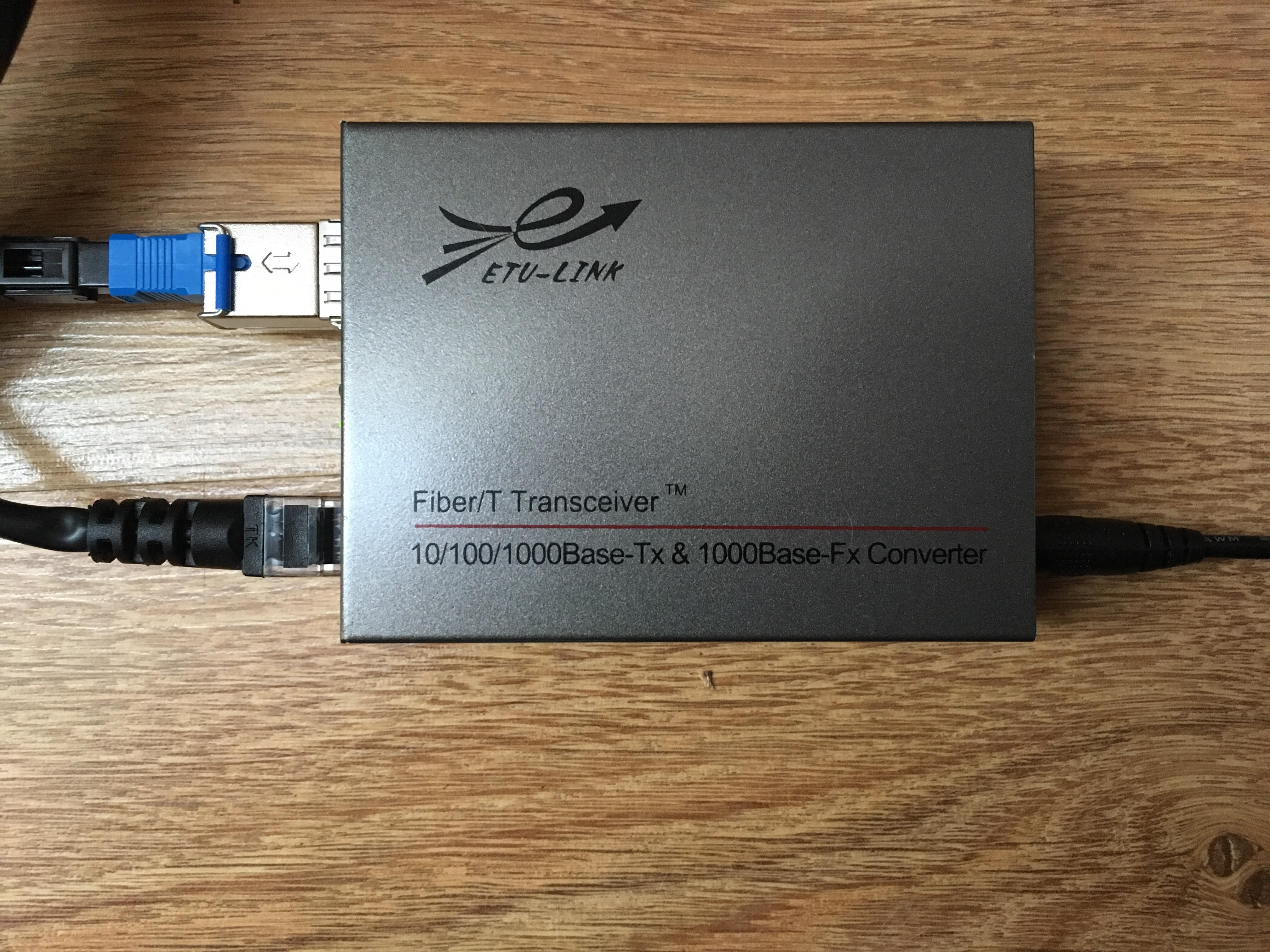

    Hi. Recently they connected my fiber with the speed of 1 Gb / s upload and download (1/1). The problem is that I do not know how to use the full potential of this internet. Speedtest tests show me speeds from 350 mbps to 500 mbps, the reserve is also quite big.
    The router I use for this connection is Asus RT-N18U, which is equipped with all Gigabit ports and the Router -> Pc connection is via cat 5e ethernet cable (there were also other tested wires that I found at home).
    The Internet is connected to an integrated network card for the Gigabyte GA-Z270-HD3P motherboard, which indeed - also supports this speed. Especially for this occasion, I installed the system from scratch, all drivers and other services were installed and updated.
    The optical fiber converter has incl green leds that indicate the current speed hmm supported, let's say - it is of course at 100 Mb / s and 1000 Mb / s, where in this case it is naturally lit at 1000 Mb / s.
    The router settings specify the speed at the WAN ports - 1 Gb / s and Lan, which is connected to my computer, also shows 1 Gb / s.
    The way to connect the optical fiber to mine single-family house it's P2P, so it's not a shared network.
    How can you advise me so that I can see the speed offered by the supplier on the speed test.
    The maximum download speed of the game on steam is up to 62 MB / s.
    For rhetorical questions like: "Why do you need such speed" and other unnecessary comments - thank you very much .

    What's your ONT? And what speed is behind it bypassing the router?

    @internick what ONT is it about? Because I am not too familiar with the subject of optical fibers and networks in general.

    Optical Network Terminal, i.e. the subscriber terminal to which the optical fiber enters.

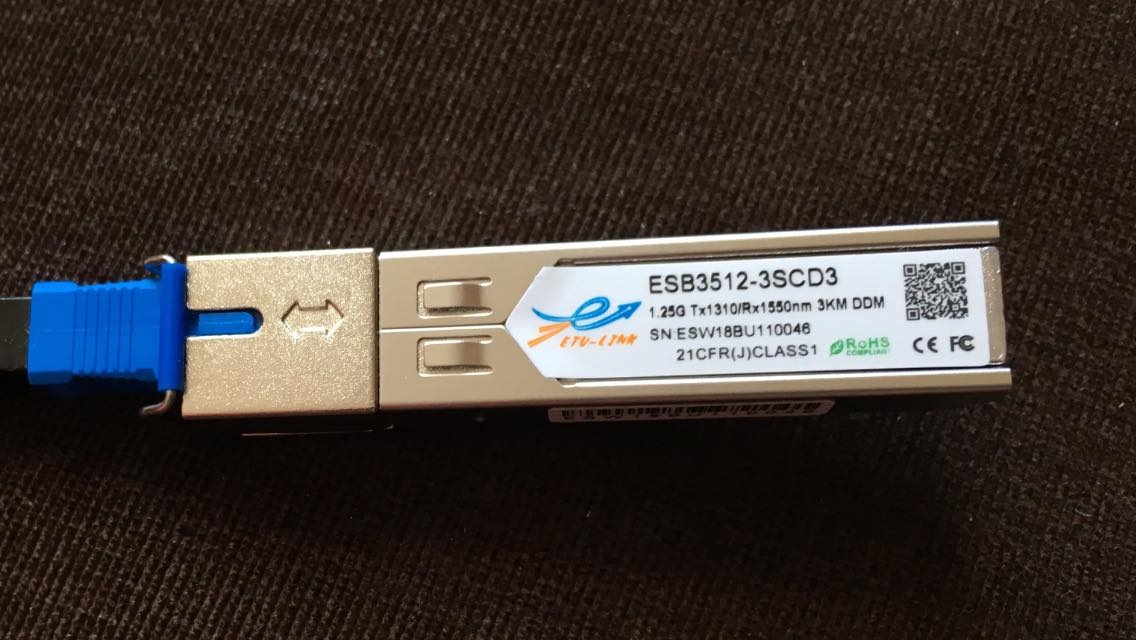

    @internick
    I have an SFP. I connected the converter directly to the computer (bypassing the router) and the speed on:
    speedtest.net download 502 Mb / s upload 179 Mb / s
    speedtest.pl download 460 Mb / s upload 550 Mb / s once showed me 543/592 Mb / s, respectively

    Producer? Model?
    If all the cables you have have similar results, then you get the same results from your ISP. You can of course buy a Cat6e patch cord for testing purposes.

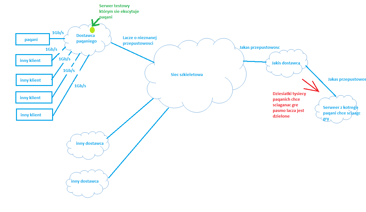

    Rather, the question is whether the operator provides you with all the speed that he declares to send, i.e. 1Gb / s / 1Gb / s. In my company, there is a custom that after installation, we show customers what speed is achieved on the link that has just been configured, if it is lower than what the customer ordered, we must ensure that it is appropriate (i.e. cleaning the connectors, welding from scratch, generally improving the attenuation parameters) , reflections, etc.). Did the technicians who assembled it prove at the end that you actually have this 1 per 1 Gb / s?

    1000 Mb / s at 1000 Mb / s there is no word "to" there. In addition, they said that people who have optical fibers from them have different speeds at one 900 Mb / s and the other 600/700 and the difference in speeds is also terrible. And now the question is why is this so? That some have 900 Mb / s and others 600 Mb / s with the same tariff. This is what the technicians who connected me to the internet told me.
    @Machetereal No, they didn't prove it, because I had a router with LAN support up to 100 Mb / s that day, so you know ... Now I think about it, it is strange that they could connect to the PC directly from the converter instead of through the router and check speed. But they didn't.

    Because the operator guarantees that the cable they have installed between their network and your home offers this speed. But the speeds in the rest of the Internet cannot be guaranteed by CI.
    You are absolutely right, hardly any testing server offers such speeds. Most websites in the world limit their speed to a single session. They are looking for websites that will send you data at this speed.

    For one thing, speedtest is no magic, there may not be active servers in your area that will handle such traffic, and if you aim at the "world", speedtest will kill you on bottlenecks, small operators.
    A good connection with CIR and, for example, direct access to AS5617, with a speed of 300/300 Mb / s, is about PLN 1,500 net per month.
    And this is quite a nice offer. Guarantee that 99.98% of the time is what is in the contract.
    Even so, sometimes there will be an outsource in the road and the speeds will be terrible for it.
    Now how to test the link more objectively? You install a torrent, SSD disk (we remember that we are testing ~ 111MB / s, so we go to thepiratebay, in the top 100 section, e.g. porn (well the world is the world, but we find the most seeds there). We set very large session limits in the torrent and download at once about 20-30 torrents, it will kill any link, no exception ^^
    Worse with uload.
