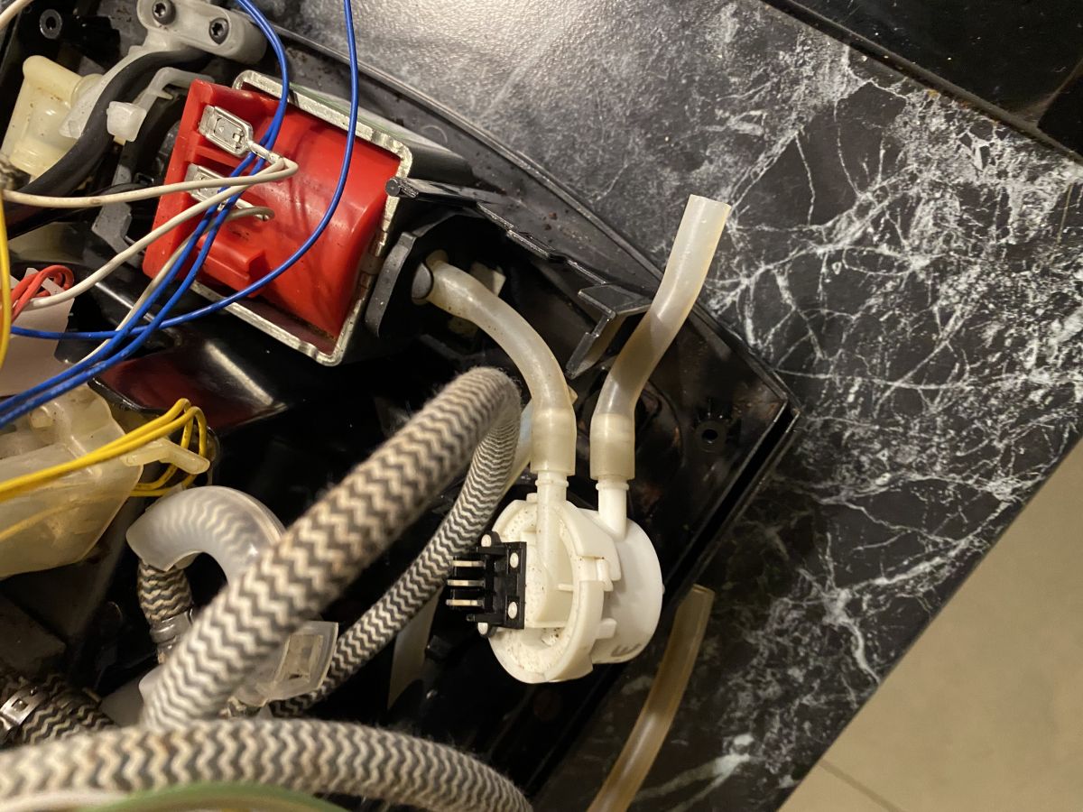

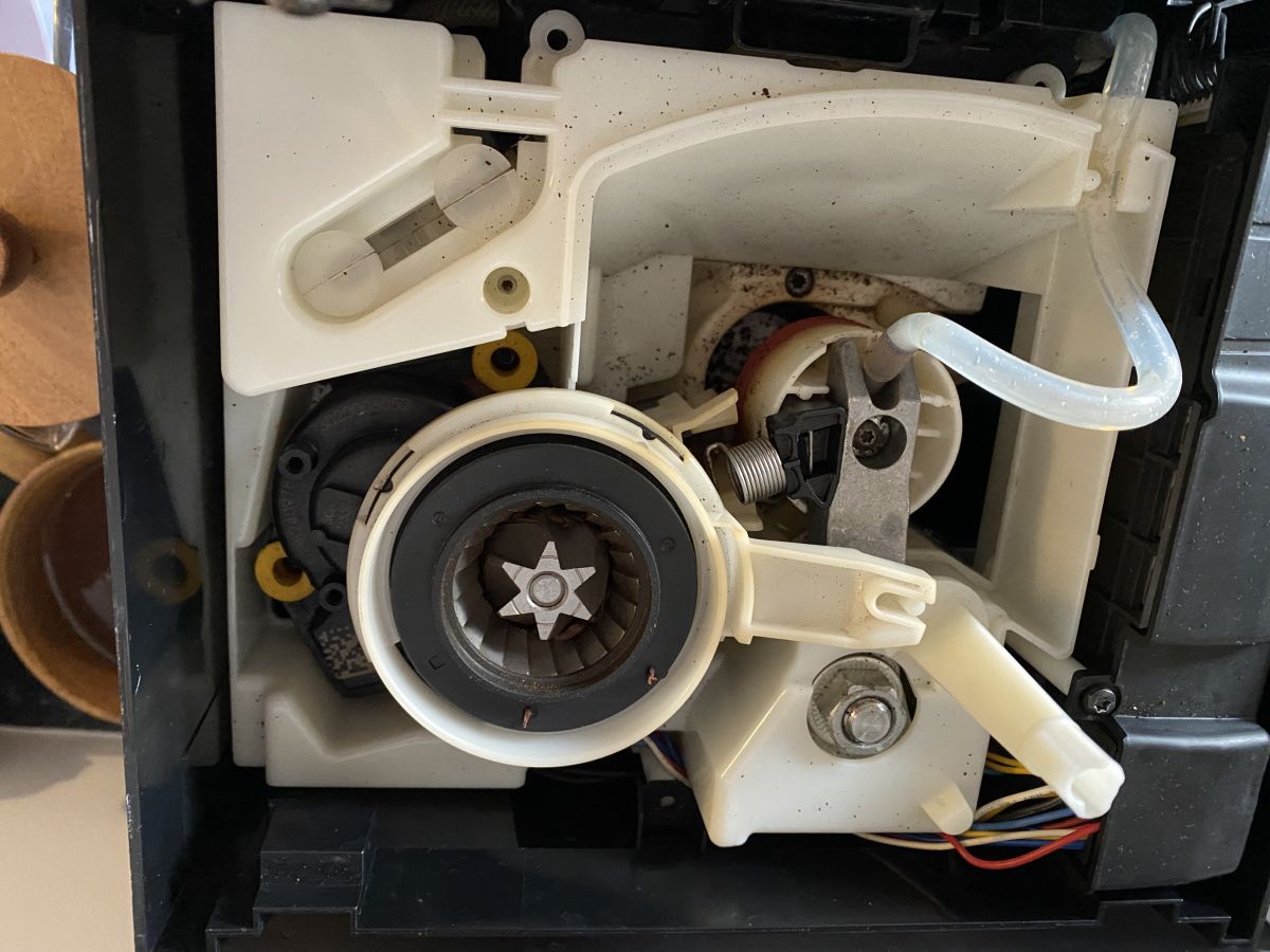

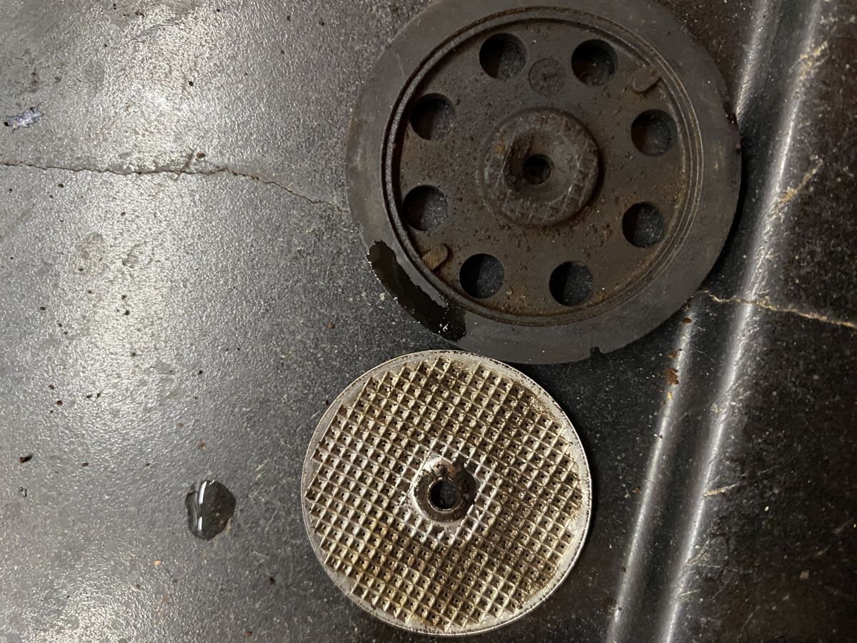

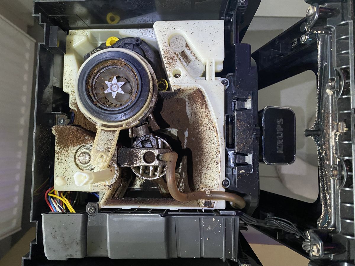

    Joining in. Krups gets dirty all the time from the first coffee. After 3 years it looked like the following. It was regularly washed, cleaned, descaled. I had to mechanically dismantle and clean each component and wash with baking soda and vinegar. After the first coffee, it was sprinkling sideways again, hehe.
    Life on the other hand was growing in the lower tube from the flow meter, brrr.
