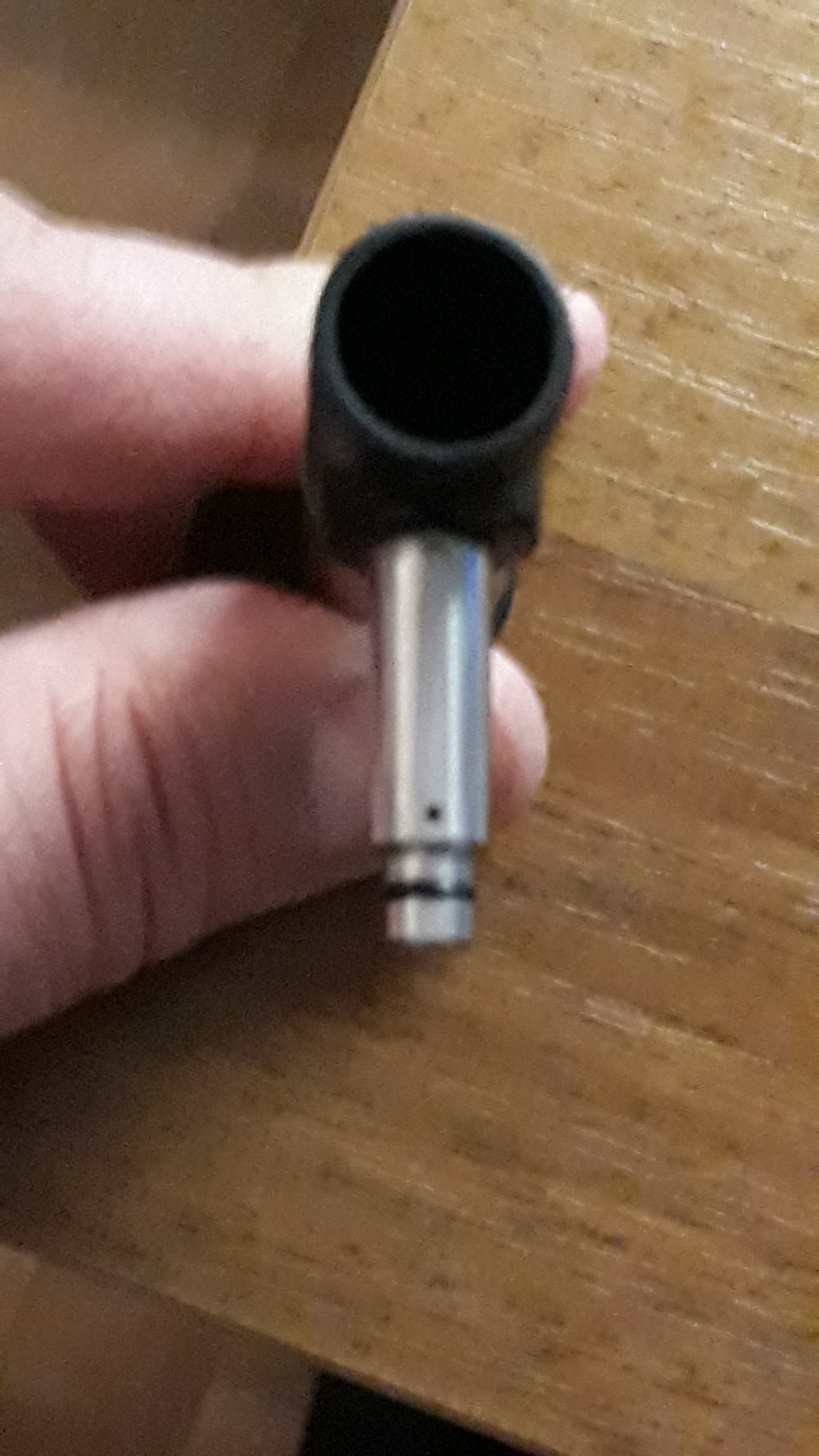

  • #7 16128353
    irekm69
    Rate: 12
    We take the lid of the foaming cup apart .. No screws, everything pulls out beautifully for cleaning ..
    We wash thoroughly under water and most importantly - There will be a metal "mushroom" with a tiny hole there - A real challenge here .. This hole will be blocked for sure and you need to unblock it ;) The problem will probably go away .. [/ quote]
    This mushroom consists of a rubber and a metal part. The rubber band has no problem with locating and cleaning the hole. Is it a metal part?

  • #9 16468327
    magdajanusz
    Rate: 14
    nioop wrote:
    AndrzejMT wrote:
    ... but the capucinno kit is not anymore, what can it be?
    We wash thoroughly under water and most importantly - There will be a metal "mushroom" with a tiny hole there - A real challenge here .. This hole will be blocked for sure and you need to unblock it ;) The problem will probably go away.
    Is it possible that the density of the froth is influenced by the milk itself? I have washed all these parts several times. Mushroom the same. The buttonhole is definitely not clogged. Low frothed milk. Full of resignation, I poured Łaciate 3.2 milk into a mug. Foam! I do not understand. I guess it didn't make any difference before.
    And one more question - doesn't it matter which way the hole in this mushroom is facing?

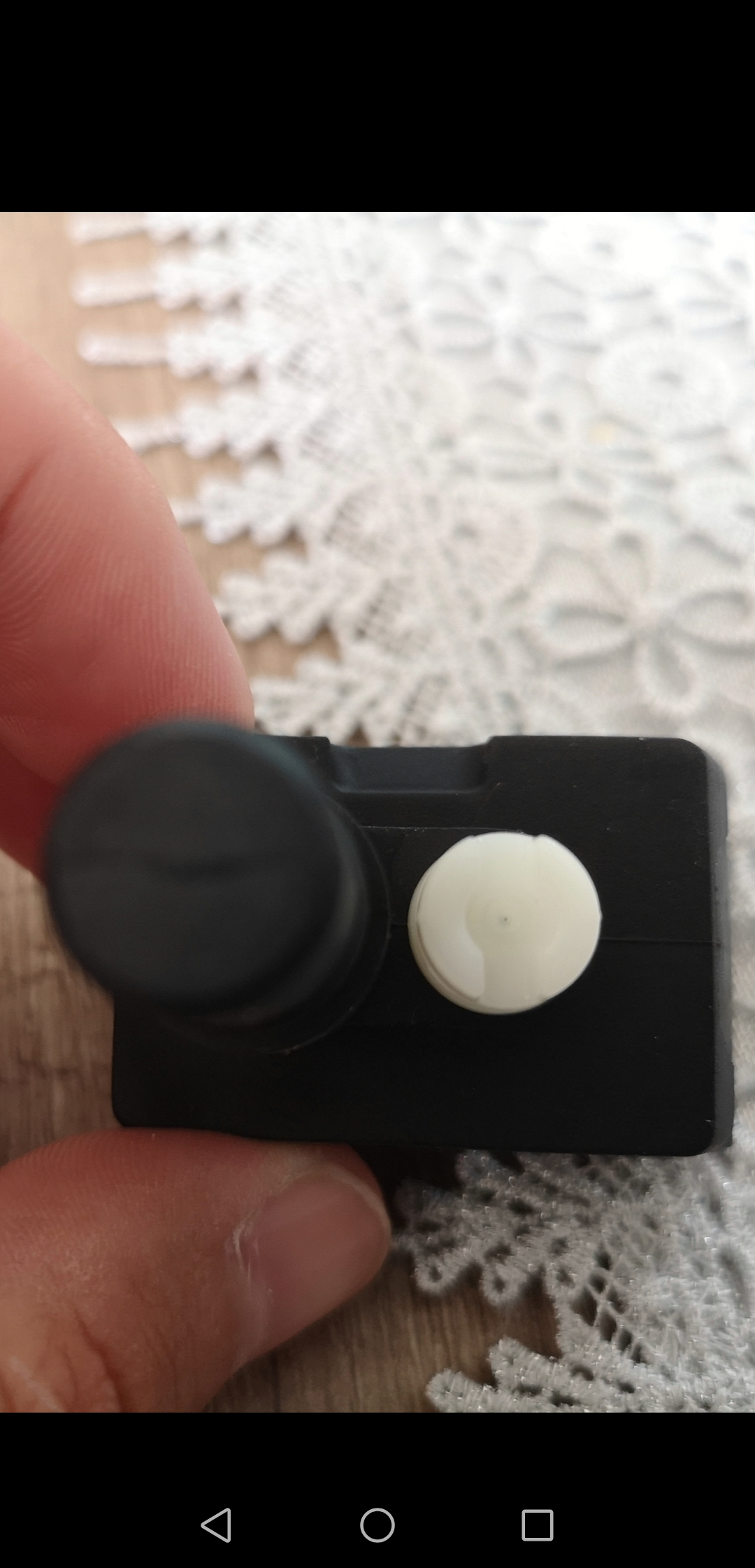

  • #16 17424827
    Farciu
    Model as in the subject. I did according to your advice. I found a metal mushroom and the needle pushed through the mini-hole, which was completely clogged, that it was completely invisible (the hole is inside such a cavity). I also took off the rubber cap and cleaned the mushroom inside. The machine is frothing the milk again. Thank you very much and regards.
  • #17 17564196

  • #19 17580241
    brzuch
    Posts: 13
    Rate: 8
    mirodo wrote:
    I would like to join the question, I have had the Krups EA8298 Maker for a few days, I have exactly the same symptom, The machine does not froth the milk, but "hisses" with steam. The symptoms are the same as in the video above. At first it seemed that we put something together incorrectly in the Capucino set, but unfortunately, after many attempts, nothing helped. The freshwater coffee machine has never been used, and the milk is poured only at the bottom of the glass. Everything washed many times, cleaned, disassembled and washed - no positive effect. Maybe someone will help?
    If it is not foaming, only steam hisses, you probably have the cappuccino-rinse switch slightly raised, I had it in the new one. After a year, I stopped foaming, and I have a Teflon mushroom, not a metal one, and I can't find a hole in it too much, the eraser has a hole for it.
    Added after 17 [hours] 26 [minutes]:
    Could you post a picture or drawing where is the hole? For me, the mushroom is Teflon, not metal, and I can't even see the magnifier. I found in the eraser but in the mushroom no gosh.
    It's OK now. I did not find the hole, so I did it myself, I blew and it is too big, aaaa but it foams :)

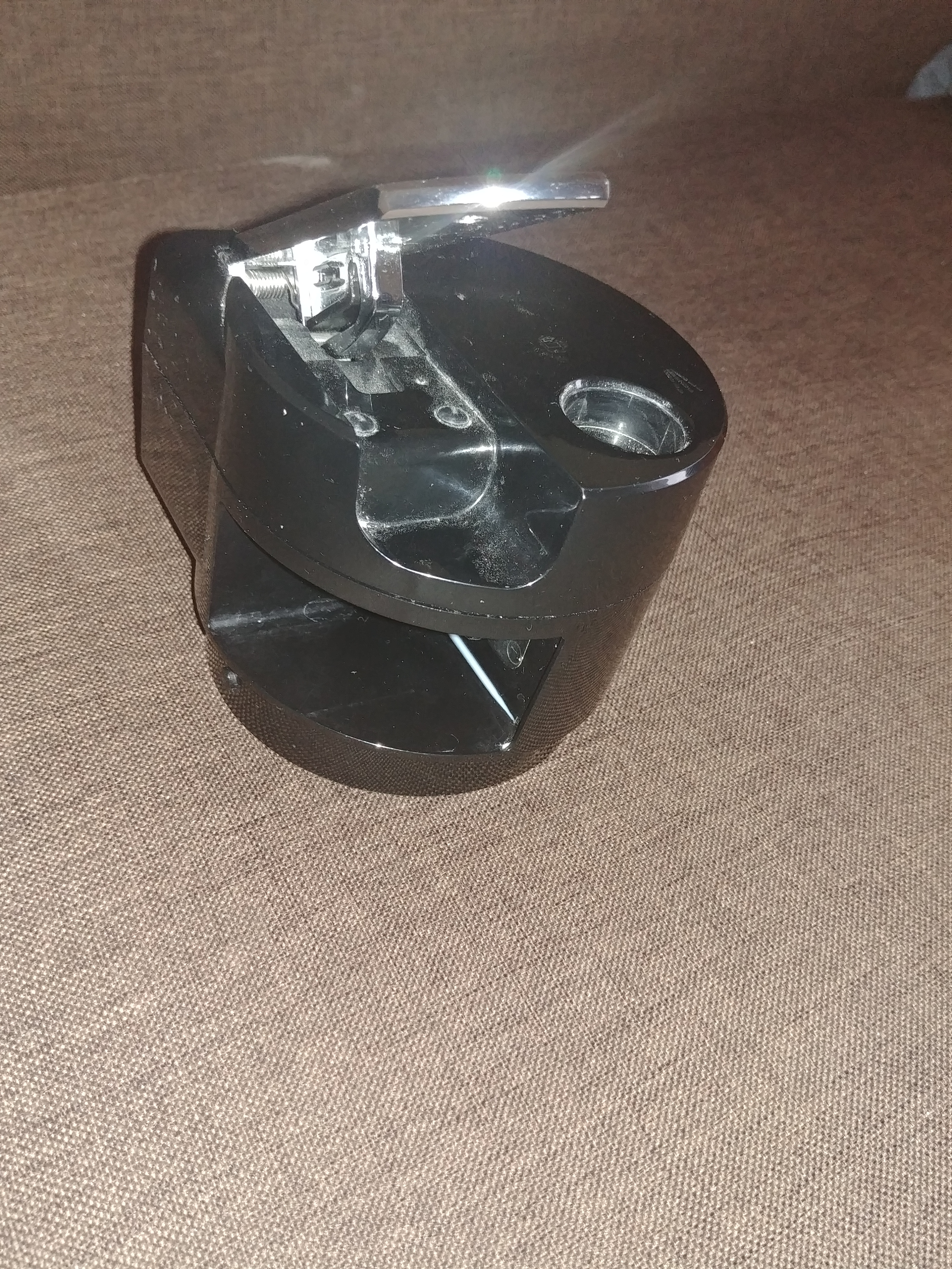

  • #24 17988788
    BetonIsLife
    The same model. So this clogging part is in this cup? If so, how to recreate it? Latches does it unscrew? Or is it the one of those (retractable) parts that are discussed in pictures 35-46 in the manual. How to recreate it? KRUPS EA8298 Cappuccino System: Milk Frothing Issue, Cleaning, Descaling & Service Options
  • #25 17989021
    brzuch
    Posts: 13
    Rate: 8
    This can not be opened anymore ... The only thing that is possible to unscrew the nozzles with a special key that is included in the set. The second important element is the part that you cannot see because it has been removed, you need to remove the rubber from the plastic and there is this tiny element in the form of a mushroom that is supposed to let the air flow in one direction.
