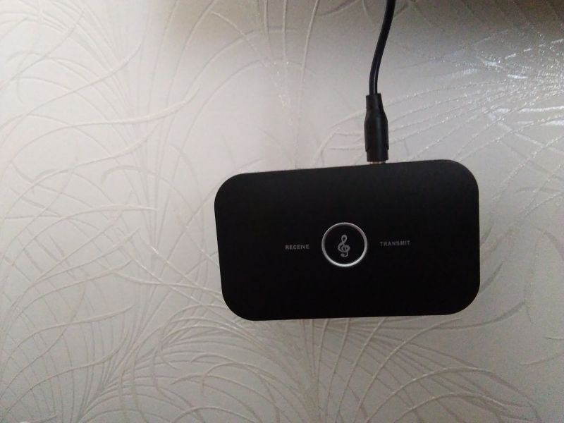

  • #12 17678452
    Nestorb
    Posts: 184
    Rate: 22
    I solved the problem by buying a contraption that I connected to the headphone output on the TV. It works flawlessly, but I'm 100% lighter :-)
  • #13 17679213
    Yoo!
    Posts: 316
    Rate: 117
    You can show what kind of device it is.
    #14 17679998
    Nestorb
    Posts: 184
    Rate: 22
    Philips 55pus6412 - Bt connection - pairs only with the selected ones
    Something like this. Works flawlessly.

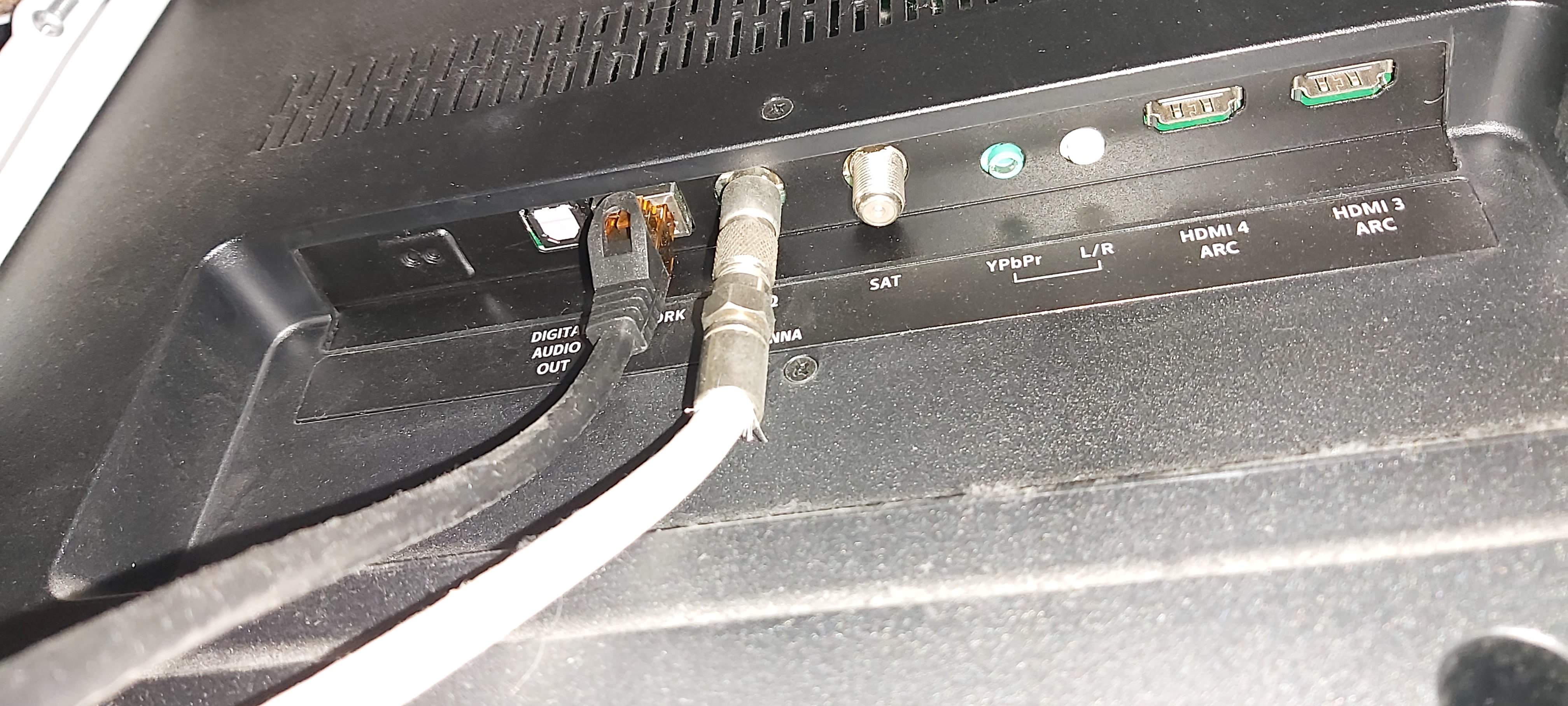

    #15 19018768
    Yoo!
    Posts: 316
    Rate: 117
    Or maybe someone advise me and tell me how to connect the following devices and whether someone used these specific models.
    https://allegro.pl/oferta/transmiter-bluetooth-5-0-odbiornik-nadkuje-2w1-9589744041
    https://allegro.pl/oferta/transmiter-adapter-bluetooth-odbiornik-nadkuje-7866052535
    https://allegro.pl/oferta/transmiter-bluetooth-adapter-odbiornik-nadkuje-7744028390
    I noticed that some transmitters are connected to the TV chinchas.
    For me, there are such exits on TV
