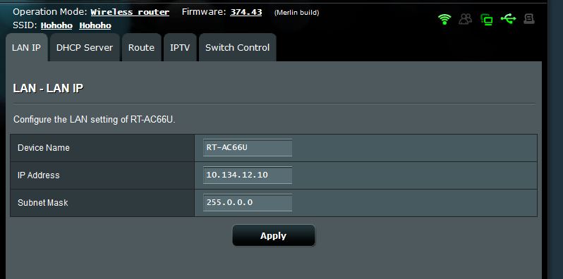

    As of July 1, my ISP changed my IP to the v6 protocol. Since then, I have lost outside connection to my network. Outside, I connect through the router with UPC. Besides, it has no task. Sometimes some WiFi devices are connected to it, and permanently, with a cable - an Asus router.
    Asus router is my center thanks to cool software. I have a Synology Disk Station, Laptop, Voip device, desktop computer, TV, AV-Receiver, Tablet, Phones connected to it.
    I connected to some of these devices from the outside by port forwarding. They all also worked in LAN.
    How can I access my computer from the outside? So far, if I wanted to, I knew that eg ftp - mojeip: 21; Photostation mojeip: 5001; DSwebinterface mojeip: 5002 etc.
    Now I have no idea what address to enter in the browser, or even what IP to enter if I wanted to ping computers on the internal network with each other.

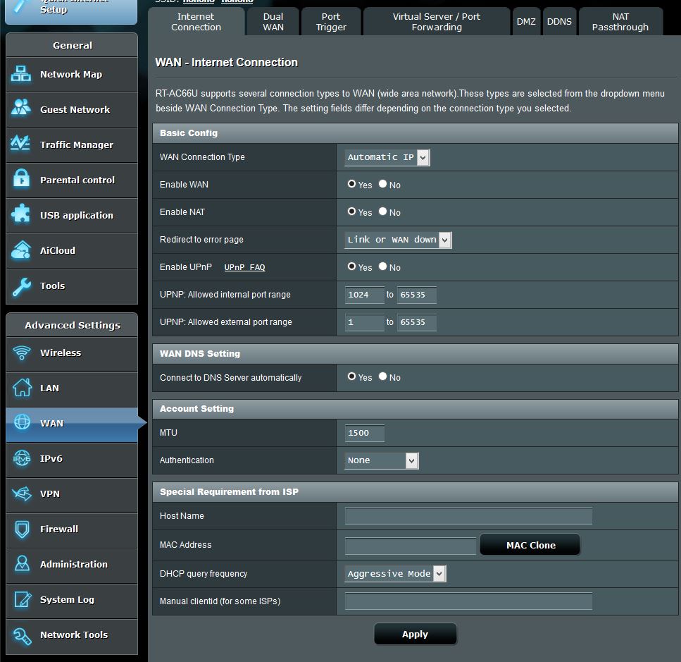

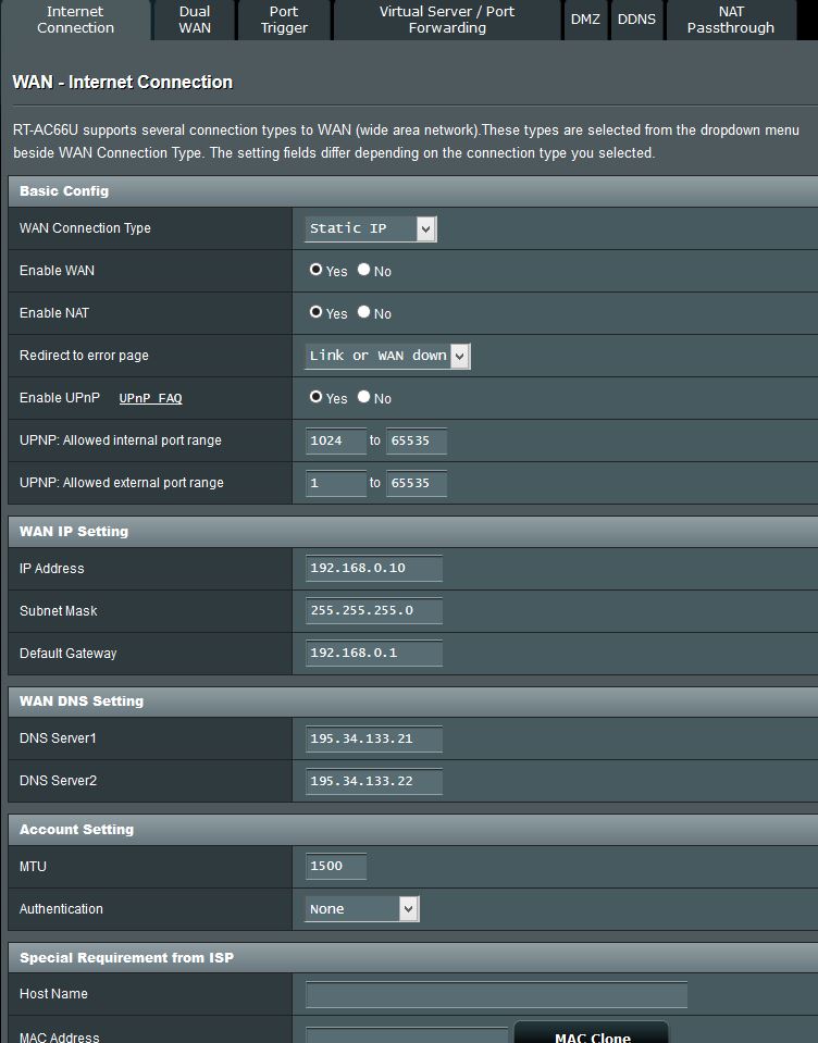

    Technicolor TC7200U with a cable for Asus AC66U and then with a cable and WiFi to other devices.
    The provider may have left IPv4 but the technical support said that port forwarding does not work anymore because I do not need it ...

    I have Technicolor from ISP and it has little functionality and I don't like it. It served me more as a modem, sometimes a WiFi router if it had a better signal. Asus, on the other hand, serves as a print server, for example, has the WoL function or Torrent download to a USB drive. And as a router :)

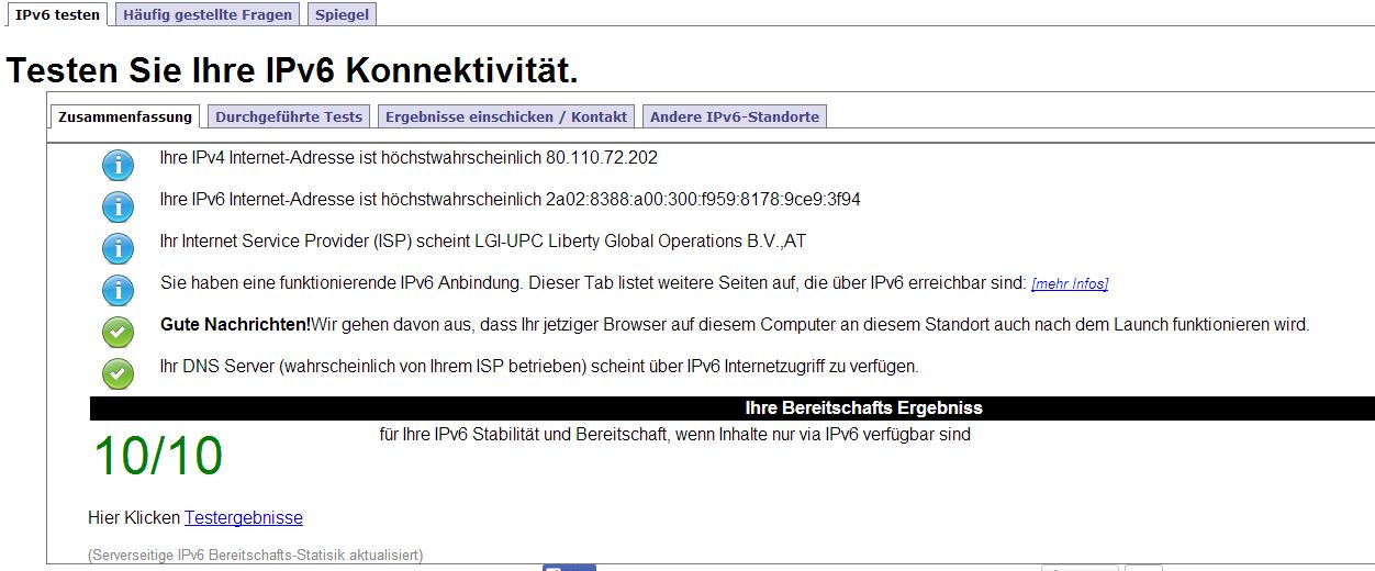

  • IPv6 connectivity confirmed with 10/10 readiness score
    #7 13802188
    neo_plonsk
    Posts: 393
    Help: 5
    Rate: 8
    Prosze bardzo:
    IPv6 Network Configuration: Access External Connections after ISP Switch & Asus Router Setup IPv6 Network Configuration: Access External Connections after ISP Switch & Asus Router Setup
    Spoiler:
    Your IPv4 Internet address is most likely 80.110.72.202
    Your IPv6 Internet address is most likely 2a02:8388:a00:300:f959:8178:9ce9:3f94
    Your Internet Service Provider (ISP) appears to be LGI-UPC Liberty Global Operations BV,AT
    You have a working IPv6 connection. This tab lists other pages that can be reached via IPv6: [more info]
    Good news! We trust that your current browser will continue to work on this computer in this location after the launch.
    Your DNS server (probably operated by your ISP) seems to have IPv6 Internet access.
    Your readiness result
    10/10 for your IPv6 stability and readiness when content is only available via IPv6

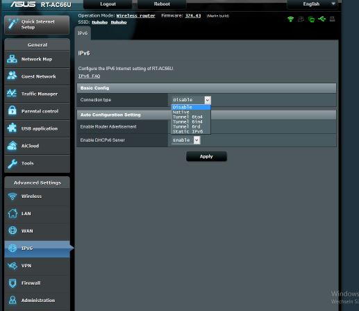

    I did, but what next? What address should I enter into the browser? How can I ping computers by IP in the LAN?
    Added after 6 [minutes]:
    Oh, I also found such a setting:
    What to choose there? Static or Native?
