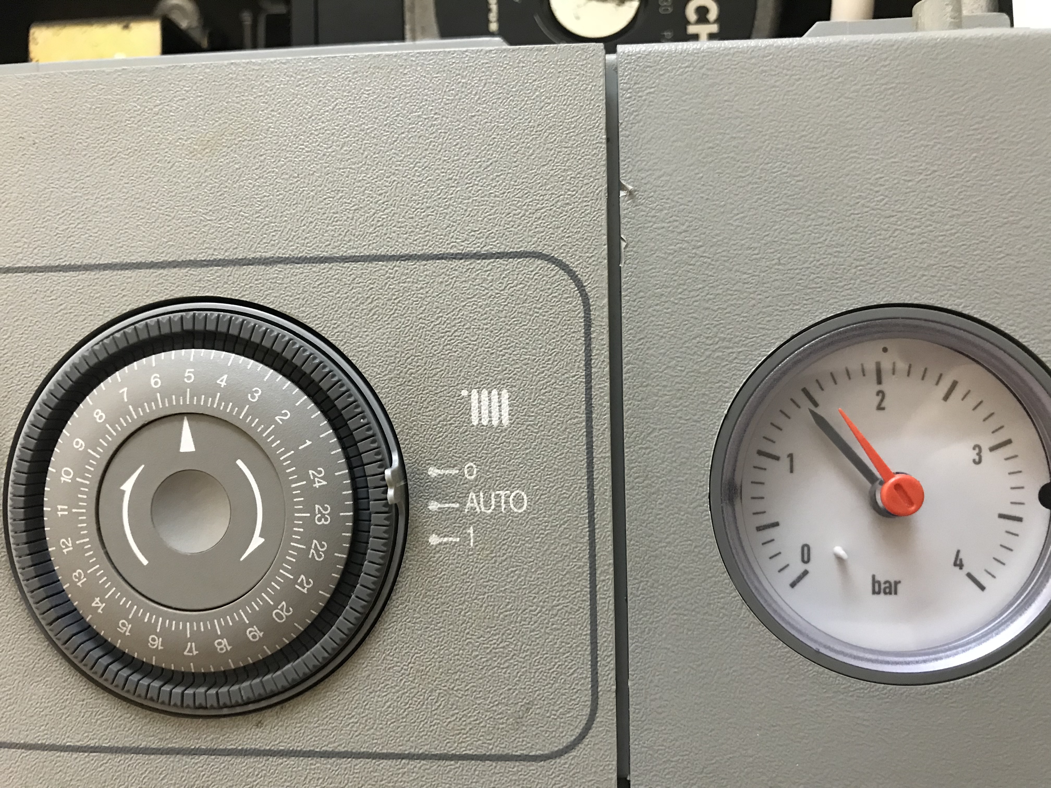

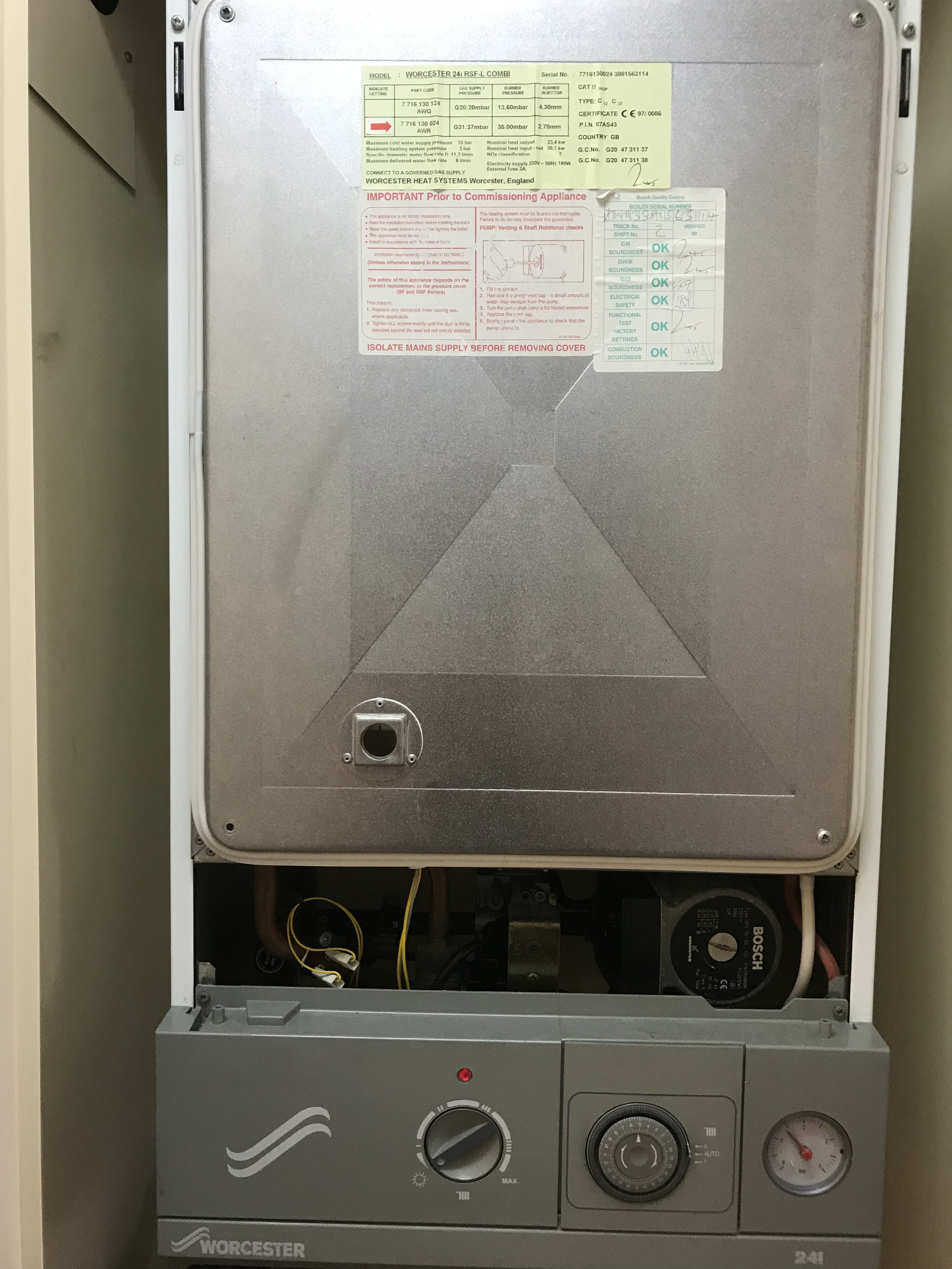

    I have a problem with my worcester stove. Sometimes the spark ignites, unfortunately sometimes it doesn't. The current is coming, but it works as I see it.
    What could it be, please help

    Yes, the fan is running, it turns on when the water is turned on. Moments after the water closes, it still spins. Sometimes the flame ignites and there is hot water, sometimes not and only cold. The chimney is rather unobtrusive. I don't know about filters
    Added after 4 [minutes]:
    There is no error (which as you can see in the pictures) there is no electronic display. It doesn't make any sounds or act differently. Only problem with igniting the flame. Sometimes it surprises and sometimes it doesn't

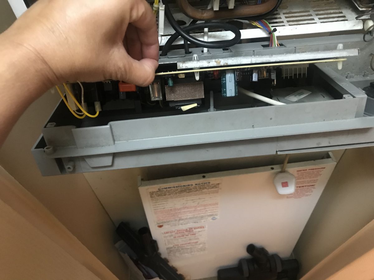

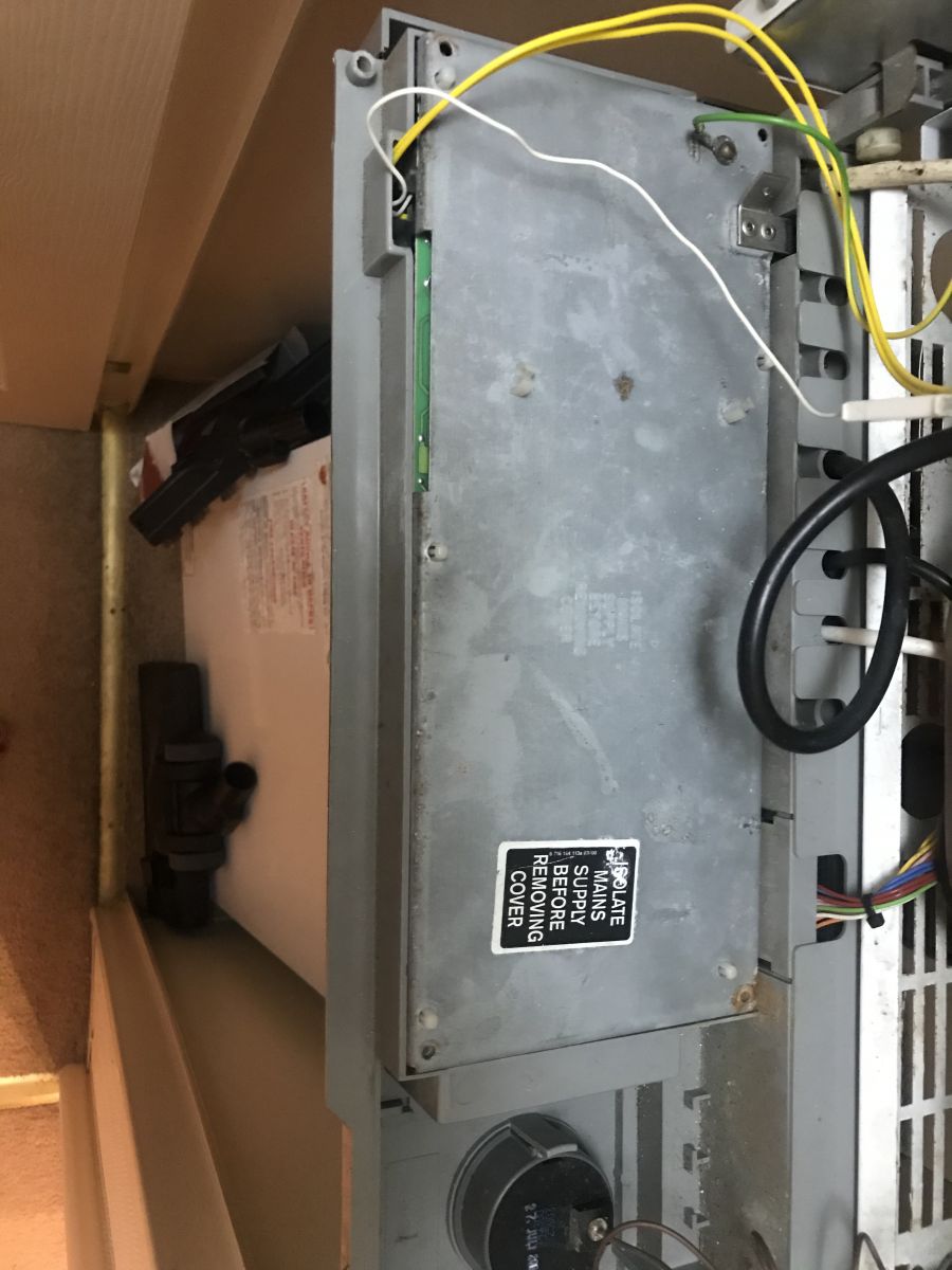

    You need to set the heating to III and to 1 not to auto. Must have heating power. For me, when I unscrew the settings panel (from the inside), sometimes when I move the cables, it works for some time. All the time the essence lies in the spark. Sometimes it will come on and light up, sometimes it won't. Last year I fixed the cables and it worked until the end of the season. After winter, for a few days the spark calmly ignited, and now the same thing again.
