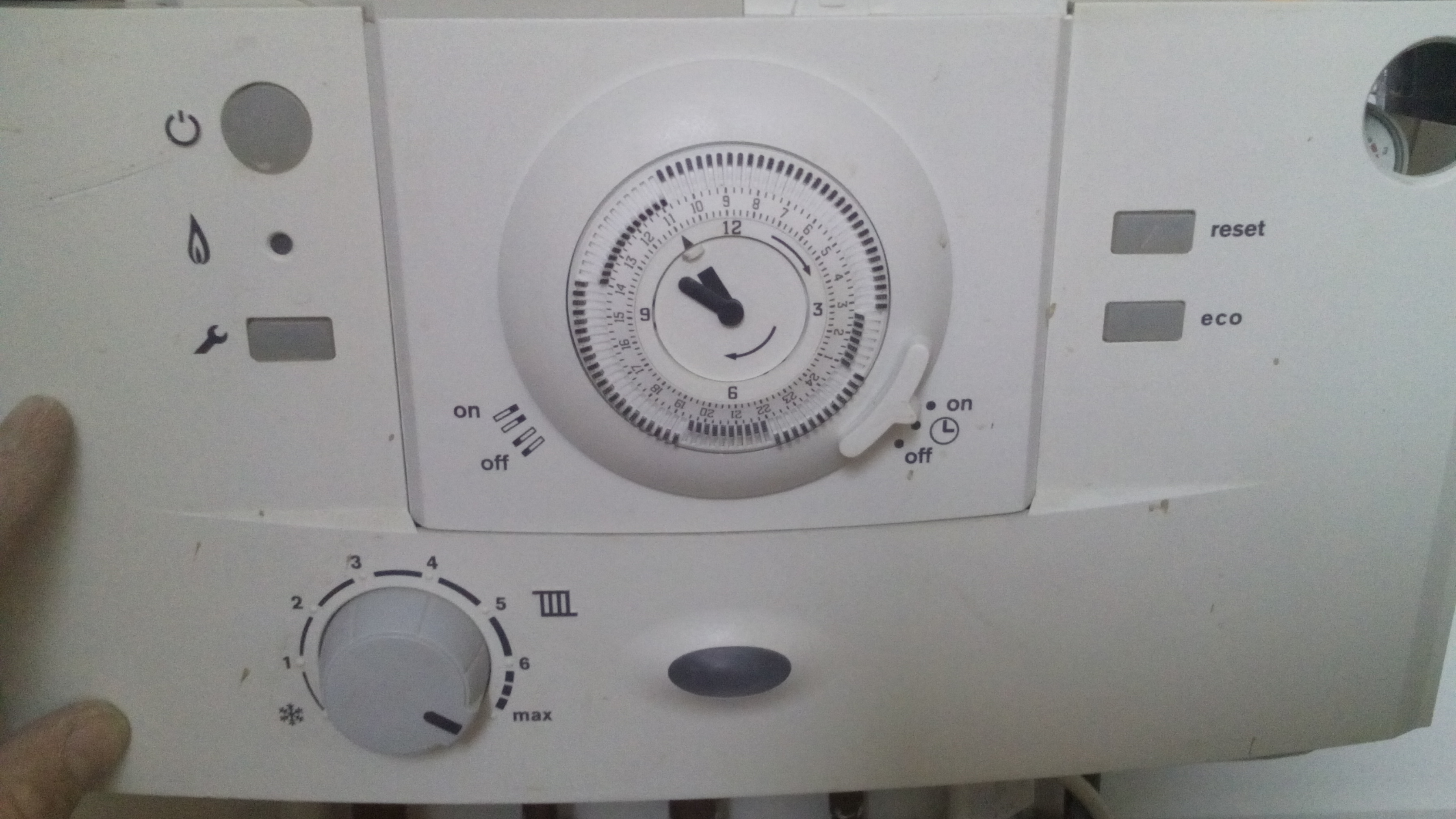

    Hello. Thanks for the response ;) Hydraulics approx 1.5 bar pressure. vented. the turbine does not rotate in the sense of a windmill. A blue light started flashing. Shit, I don't know what's going on ..

    Enter the fault code ... if you want to reset, press it to the horizontal lines or turn the device off-on.

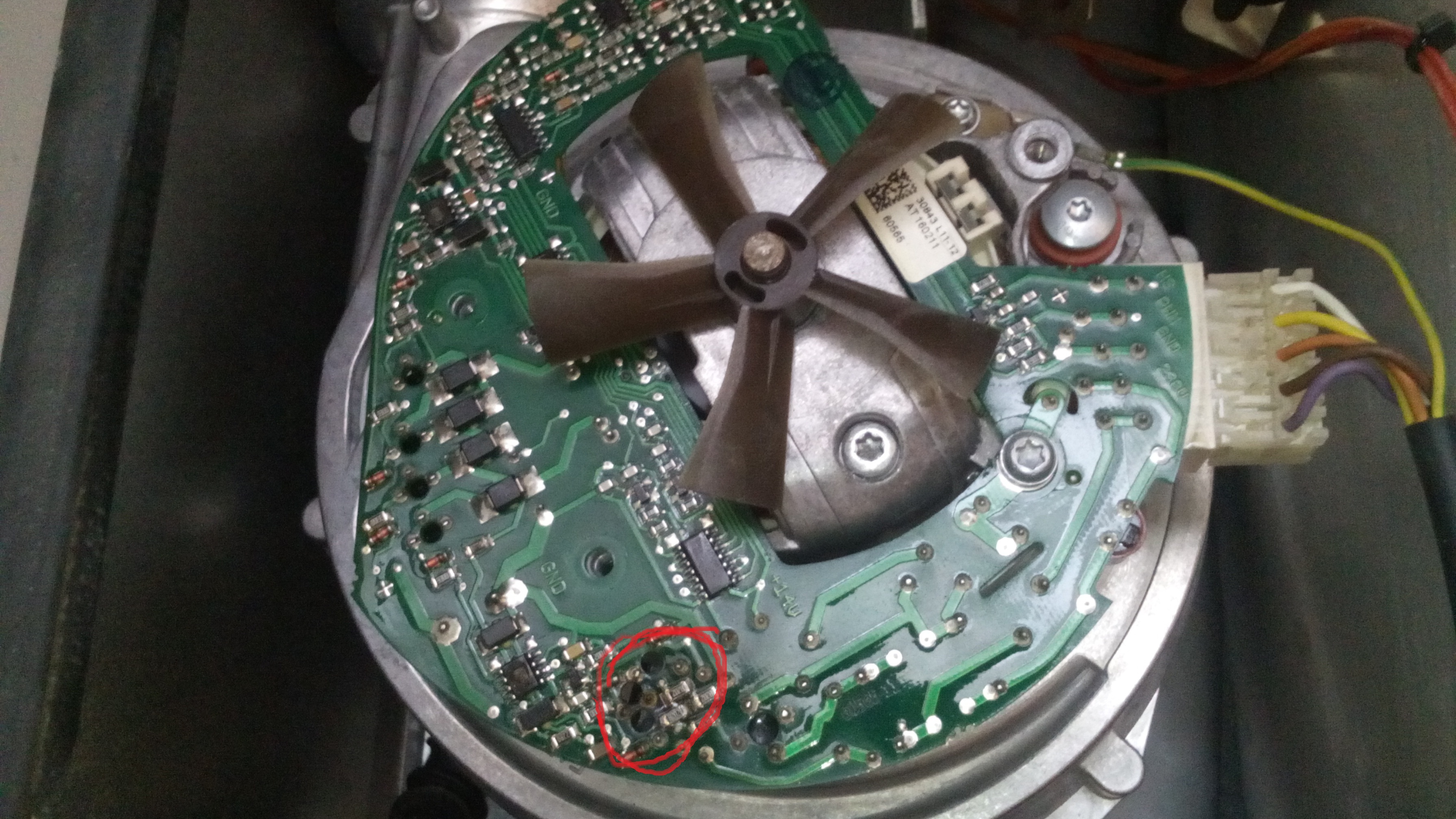

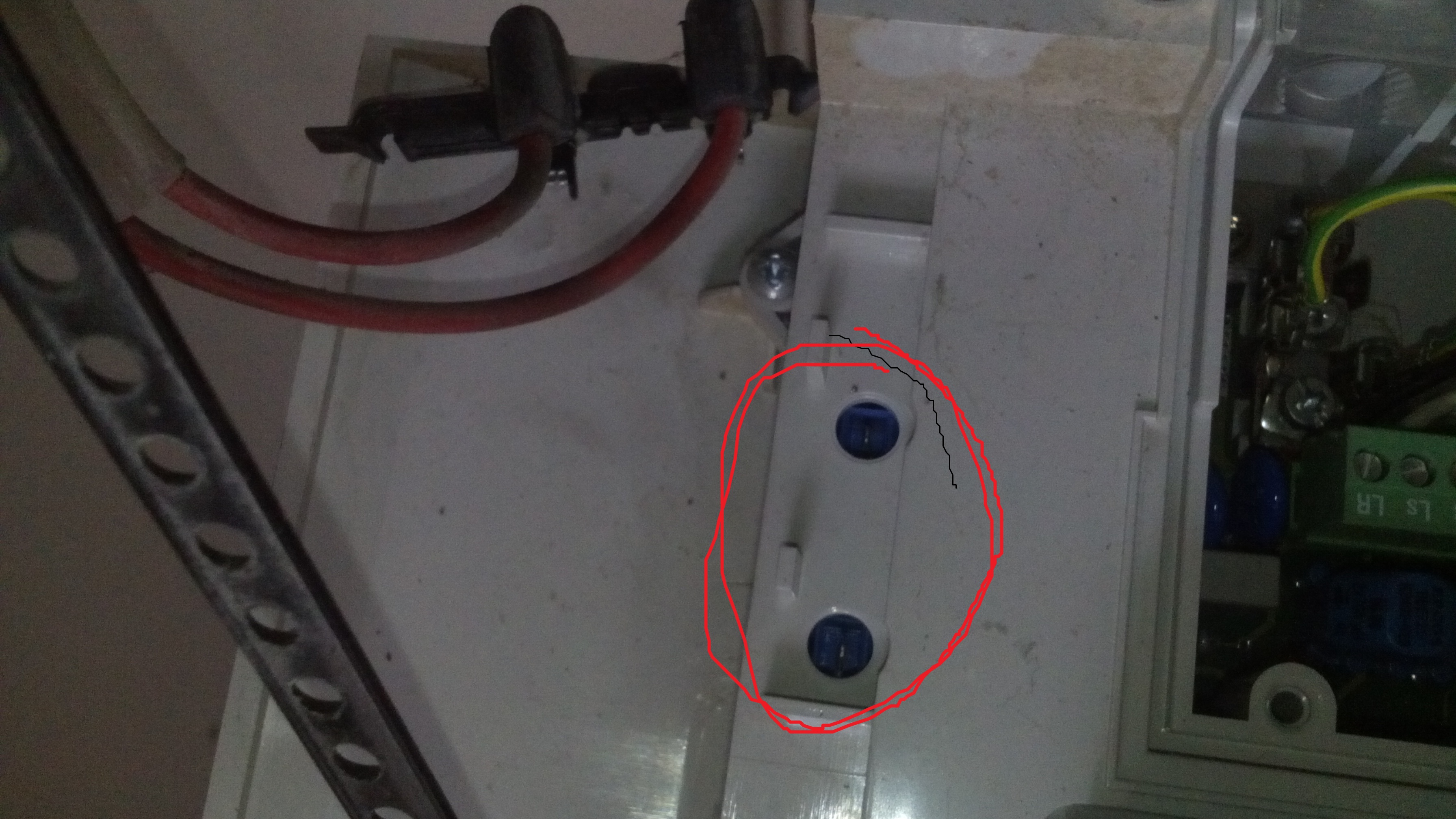

    I've tried everything. I am worried that the water is dripping slowly but it is dripping. The windmill does not run - the plate is as if burnt. There is voltage on every contact and resistor. There is no voltage at all on the cable that goes towards the fan. There is no list of faults here ;) Worcester Bosch Greenstar 24i Junior - Cold Water and Non-Functional Heating Post-Renovation Worcester Bosch Greenstar 24i Junior - Cold Water and Non-Functional Heating Post-Renovation Worcester Bosch Greenstar 24i Junior - Cold Water and Non-Functional Heating Post-Renovation Worcester Bosch Greenstar 24i Junior - Cold Water and Non-Functional Heating Post-Renovation

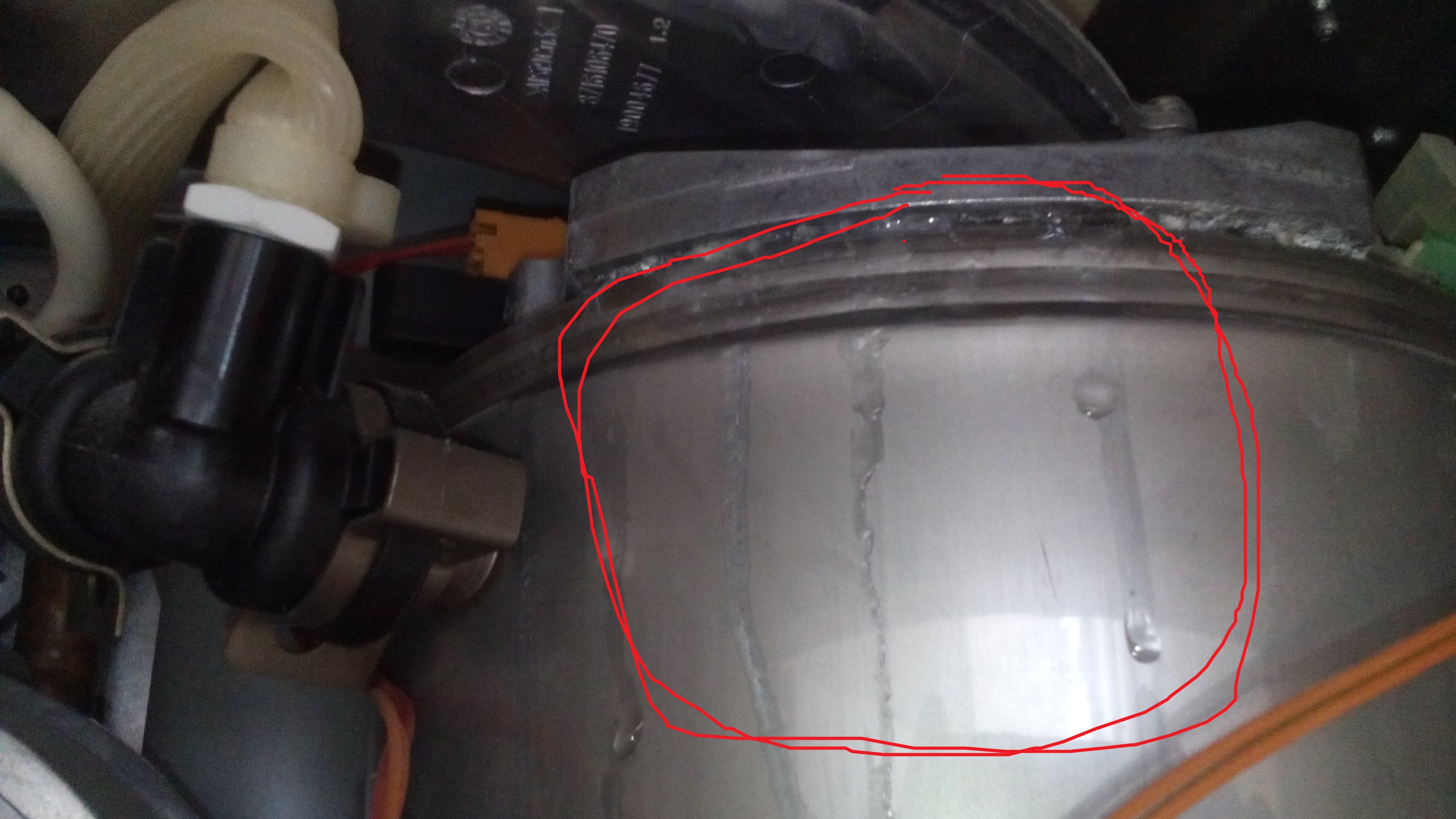

    First, you need to locate the source of the leak. Is it dripping from the chimney, the fan, and the heat block? Is it coming from inside the boiler? Is the boiler dead or is it showing a blockage? The leak could damage both the fan and the plate, translating into ours over PLN 2,000 ... but replacing parts without establishing the cause is pointless ... The reasons for the failure are the unfortunate air-flue gas system or a sewage failure.

    If after pressing "reset" the blinking disappears and after a few moments it reappears - there is a chance that it is only the fault of the fan. If it cannot be reset (it is blinking all the time) it is rather bad with the disc.
    As my predecessor wrote, it looks like a leak from the air-flue gas system (the gap above the fan) .. It can drip when it rains or when the boiler is working.
    But if it is not dripping there ... and, for example, from the month you have measured on the upper edge of the exchanger - then maybe from the exchanger itself ... (the pressure on the manometer should also drop)
