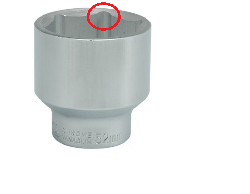

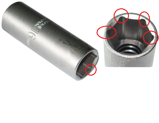

  • #34 17419851
    cynamonik
    Posts: 856
    Rate: 143
    Yato, Neo, King Tony and the "current Stanley" are basically one "shelf". With a downside for Stanley, because looking at the keys of this company, you have doubts ...
    Andrzej20001 put it well in the workshop:
    "Good key, as you assume, it enters quite tightly and is smooth inside, tightly on the bolt, nut"
    a lot also depends on the screws because, for example, in the automotive industry and in the case of good manufacturers, they keep the tolerance well ... but sometimes even a screw made according to the standard, after putting a key on it, shows a not too "tight" connection, which is a sign of trouble.
    There is also what others wrote that Yato has various designs, design and probably a lot of fakes, because olx has about 110 PLN 100 element boxes, and in the store the price is at least 2-3 times higher.
    I have noticed that more and more good quality wrenches in hexagonal sockets have rounded corners, which increases resistance to breakage, minimizes the resulting notch and improves cooperation. I enclose a photo ... such caps are not visible in large sets of PLN 100 :)
    Recommended Affordable Car Repair Tool Brands & Sets: Yato, Craftsman, KS Tools, Husky, & Lidl Recommended Affordable Car Repair Tool Brands & Sets: Yato, Craftsman, KS Tools, Husky, & Lidl
    it's probably the Yato caps ... the first thing Google showed :)

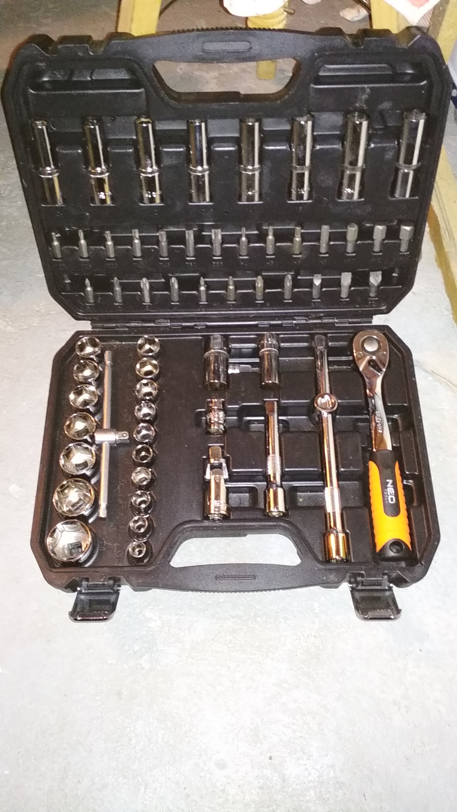

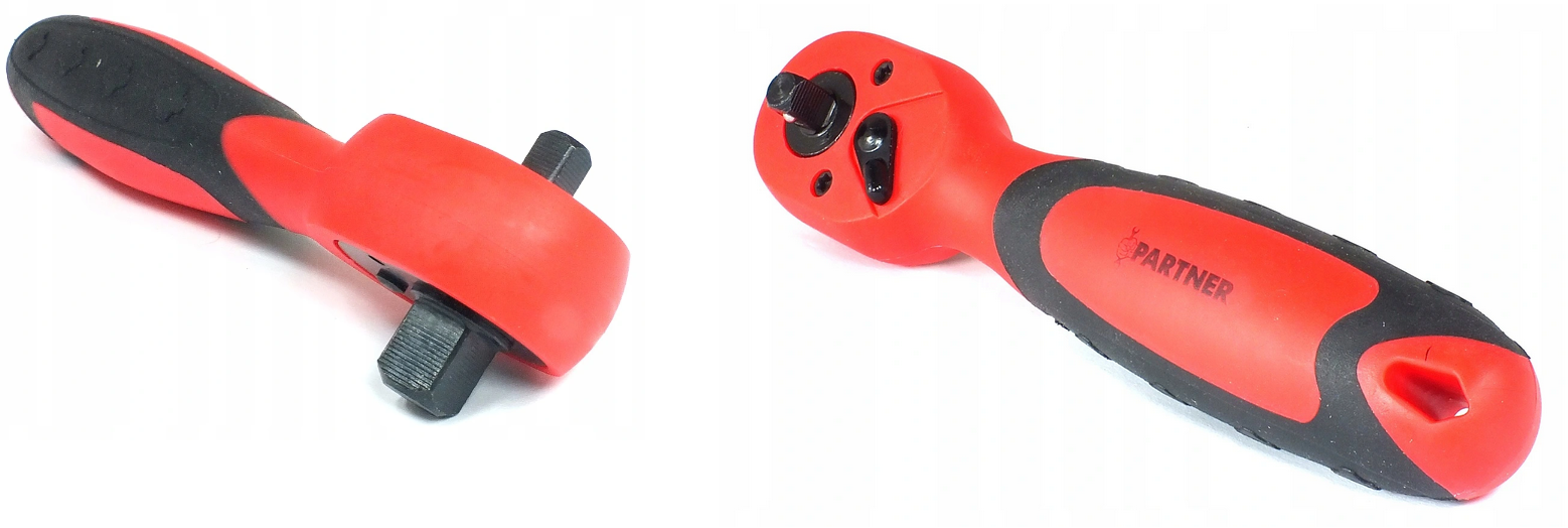

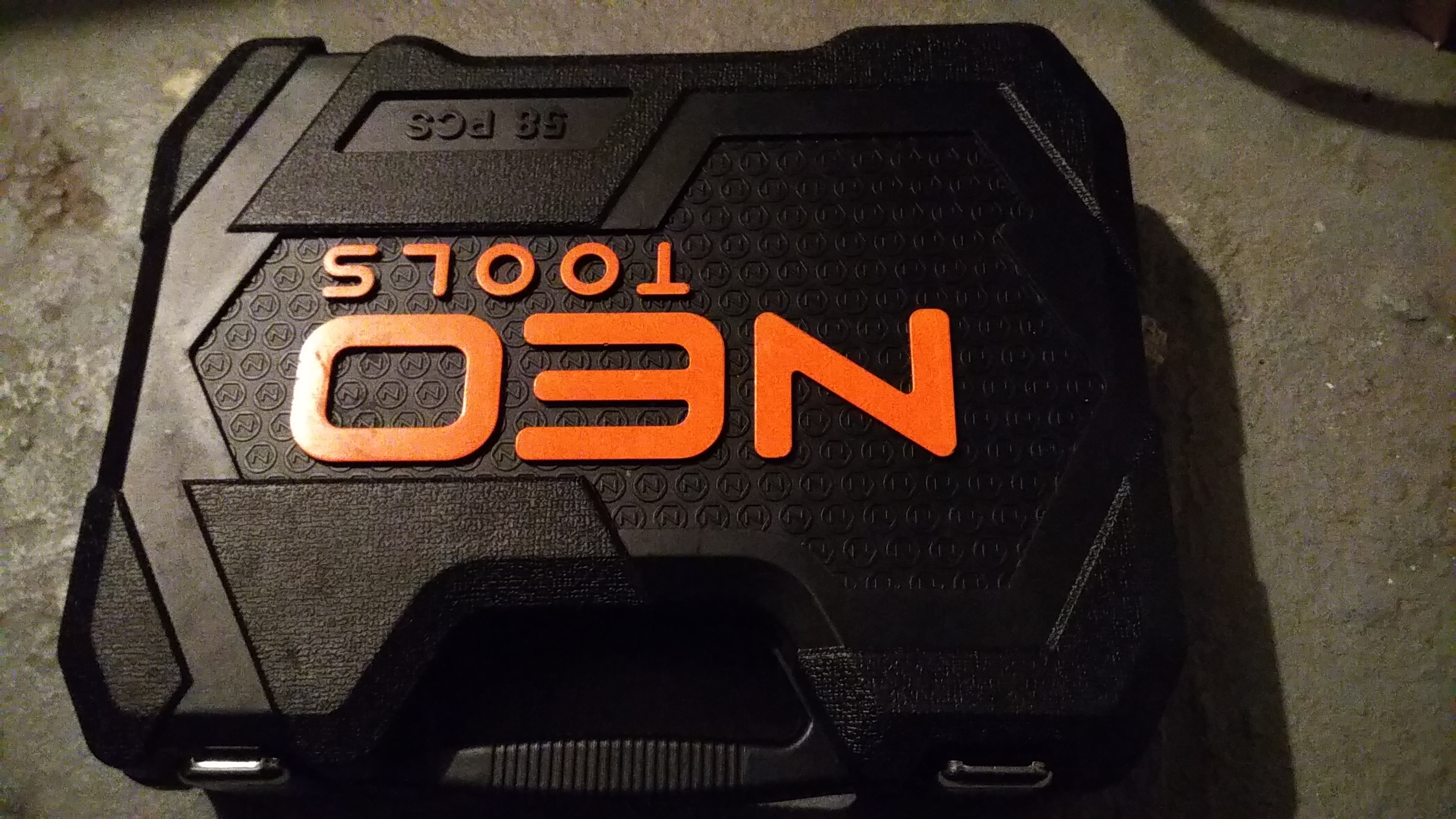

    #37 17422399
    cynamonik
    Posts: 856
    Rate: 143
    siewcu wrote:
    said a person from Neo the rattles are tested to just 720Nm
    As for me, it is not covered with reality, and even more so with the application - the so-called marketing gibberish that has nothing to do with the industry. Keys are not compared this way :)
    Tempted by the opinions about Neo, I invented some nice sets:
    http://neo-tools.com/catalog/product/view/id/4605/s/klucze-nasadowe/category/656/
    http://neo-tools.com/klucze-nasadowe-9339.html
    http://neo-tools.com/klucze-nasadowe-9332.html
    Most of the sets have three sizes of rattles, a bit more form than content. After all, two are enough. Out of curiosity, I checked the set of keys weighs about 10-11 kg! And take one with you on a bike or on vacation, anywhere ...
    In addition, for general cargo, a screwdriver-type knob is used anyway due to the small moments, not to mention the comfort :) ewnt mini rattles.
    I am enclosing a photo of my kit. Bought on olx, practically new - half price :)
    I added a 3/8 "LUX knob with Obi and a maximally ergonomic short two-sided 1/4 '' and 3/8 '' ratchet
    What do you pay attention to when buying keys?
