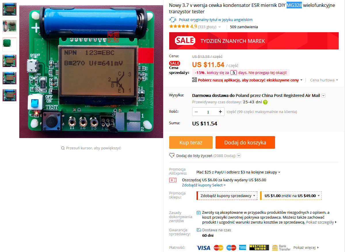

    Time to add some colour to the article... So you have a screenshot of the auction :D .
    Another component tester - MG328 - Test / Review / Opinion .
    As you can see, for eleven and a half dollars, which as of today translates into approximately 43 Polish zlotys, we can purchase the tester in question for ourselves from our Asian friends.

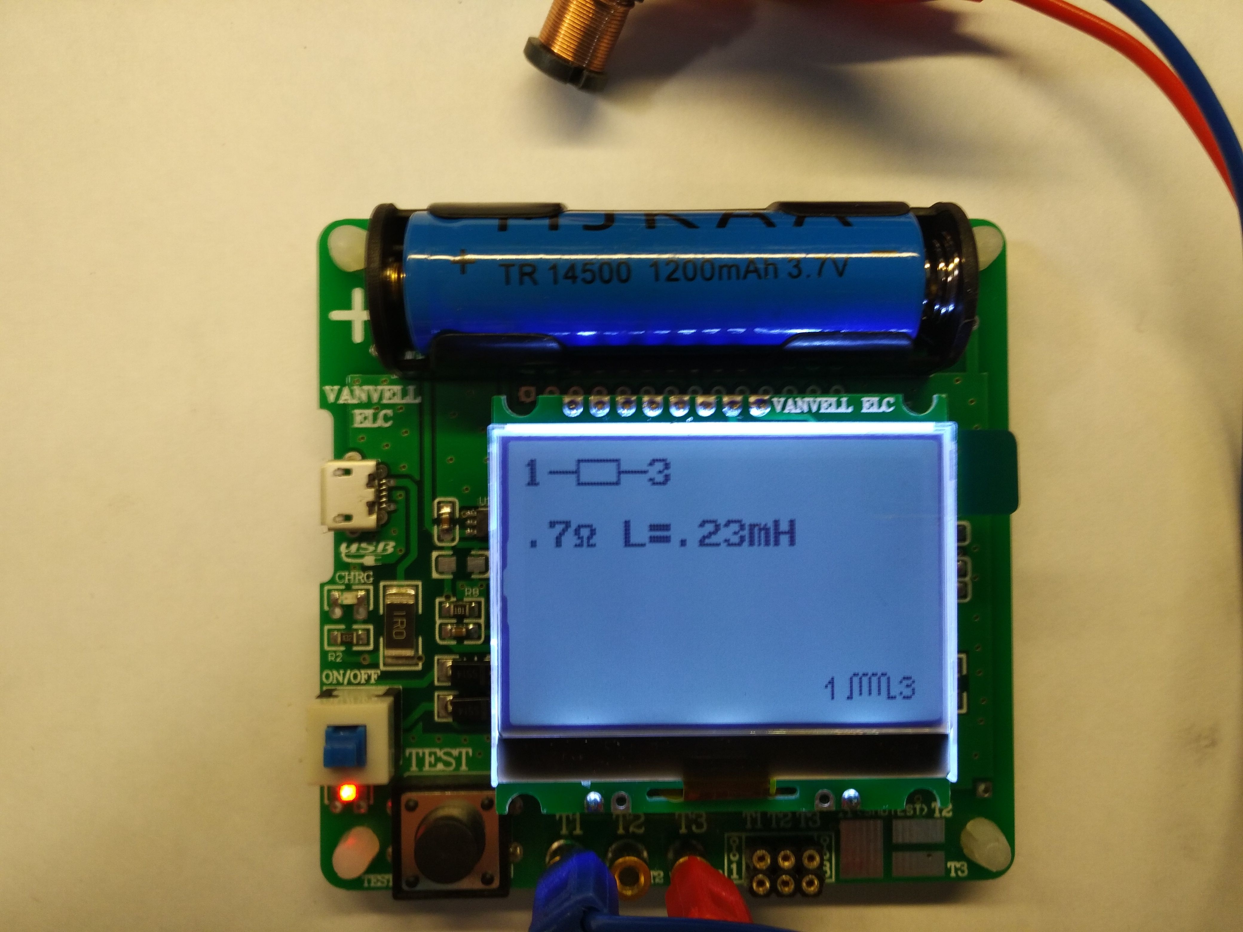

    As you can see, there is no problem with the inductance measurement either.

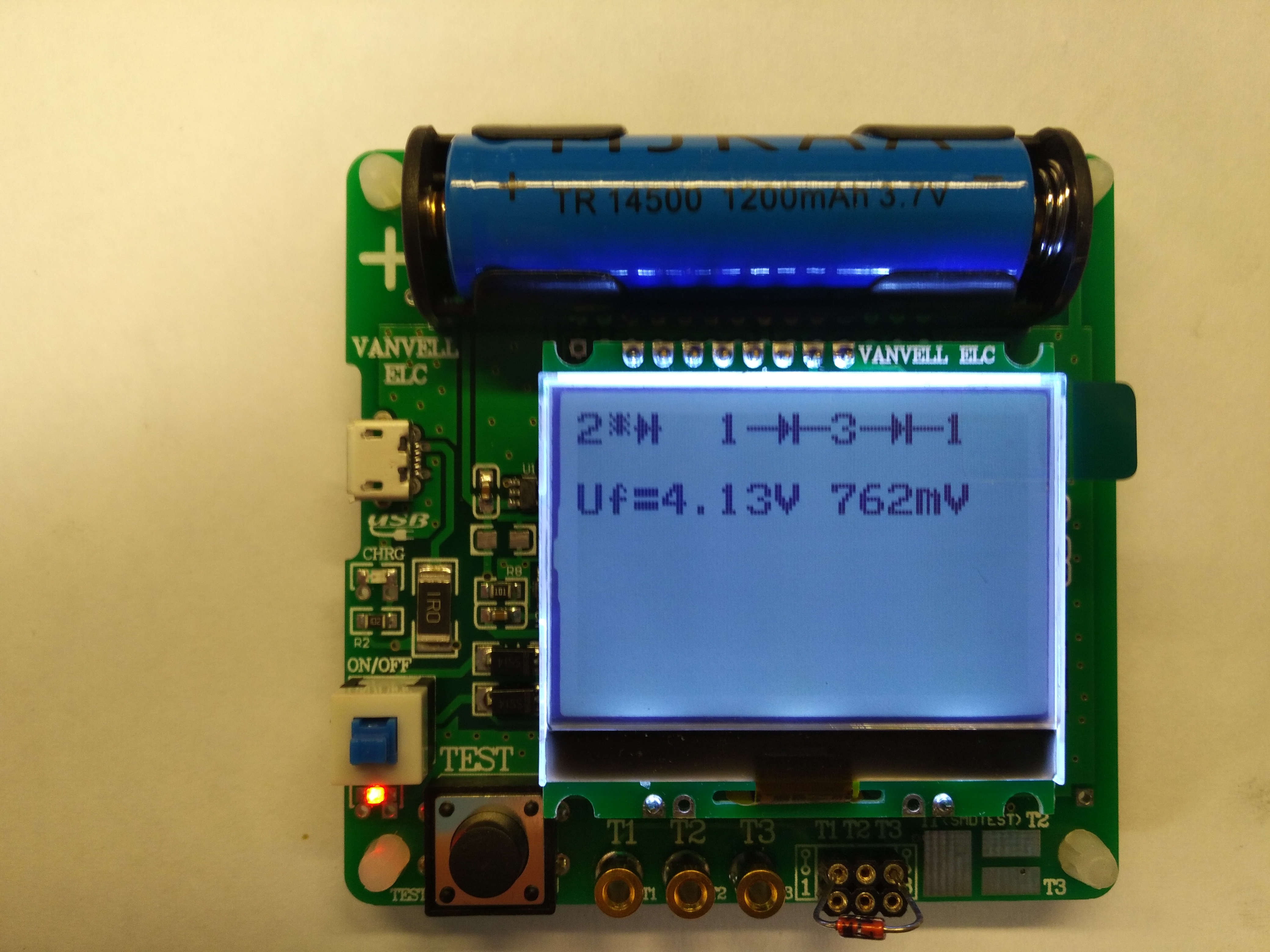

    Out of curiosity, I connected a 2.7V Zener diode to the diagnostic socket. I obtained the following result:
    This made me curious and I decided to check up to what voltage, Zener, the tester would recognise the diode as a "zener" and when it would stop. I should add that the previously presented testers (without modifications) did not support the Zener diode test at all .
    2V7 diode

    As you can see, the measurement is not very precise, or the diodes have a macabre tolerance. I will investigate this tomorrow, using a workshop power supply.
    Zener diodes at higher voltages are recognised as ordinary diodes.

    After reading the Chinese-Polish description of the auction, you can find out that actually, the tester supports Zener diodes up to 4V5
    Zenera diode 18 can be detected if the reverse breakdown voltage is less than 4.5 v. This will appear as two diodes, can only be determined by the voltages. The probe around the diode symbol is the same, in this case, you can 700mV voltage threshold close to the true recognition of the diode anode!
    In the case of Triacs, on the other hand, the tester gets lost in the same way as presented early on. With small triacs, there is a chance that it will show the correct measurement. I usually I use a BTA16 and in their case the measurement result looks like this:

    There is, however, a reasonable explanation for this phenomenon. Here I quote majfriend again:
    If the current test exceeds the current holding, thyristors and triac can be detected. But some current higher than the semiconductor SCR and triac tester can provide current triggering. Available current test is only about 6mA
    That is, it appears that the tester may simply "not have the power to make such a triac work".

    Inductance measurement range 0.01mh-20H, otherwise it will appear as a resistor, coil DC resistance is higher than if Europe 2100 will also be displayed as a resistor.
    This is what the description of "majfrjenda" says, unfortunately I do not have a drawer with coils with known parameters to compare.

    Hello, it would be appropriate to test whether the meter measures inductance. As many of us somehow deal with the measurement of C / ESR, my intuition tells me that a group of colleagues struggle with the measurement of L, in any case I would be most interested in this function of the meter.

    Sorry, my oversight. I was sure I included a picture of the coil measurement.
    I added in the first post.
