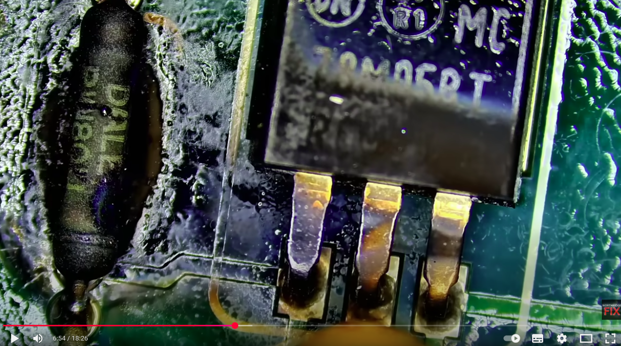

    This story is about the repair of a de-icing control module (De-Ice Circuit Board) from a $10 million Cessna Citation 560 aircraft. Alex received the board for repair with a faulty voltage regulator and a faulty resistor.
    These are a 78M05 linear stabiliser and a 20 ƒ DALE resistor.
    Close-up of damaged 78M05 voltage regulator and DALE 20Ω resistor on PCB
    In the absence of service diagrams, he had to work out the value of the burnt resistor by enlarging a photo of the same board, which someone was selling on eBay for $12,000.
    In the posted video, he demonstrated replacing the regulator and resistor, using a variety of professional techniques and tools for doing so.

    - He did not use an approved resistor and voltage regulator for the repair, which had undergone additional testing at the factory.
    - He did not use approved tools, i.e. certified soldering iron (temperature control), pliers (cutters), lead bending machine, which could have led to damage by stresses that could lead to future damage.
    - He did not use approved materials, i.e. certified tin, soldermask, certified flux, washing fluid approved for this type of repair, which in case of failure could lead to ignition and release of toxic substances.
    - It has not kept clean, i.e. it has contaminated the solder fields with low-melting alloy, so this gives rise to the risk of future joint failure.

    In my opinion, the repair was not done properly. The charred laminate between the resistor leads was just flooded with soldermask without cleaning.
    I know 20 ohms is a small resistance, but it shouldn't look like that. The charring extends to both leads of the resistor. Normally you should mechanically clean this area to a healthy laminate and pour epoxy resin over the cavity, then soldermask and mount the resistor on spacers plus bushings in the holes. Only such a thing would pass in consumer equipment not in aviation.
    What do you think?

    I agree. Charred laminate is often quite low impedance - it should be removed to a healthy, and sometimes even out and restored. But another issue - the lack of any analysis of why this happened. Measuring a few random discrete components with an ohmmeter because they happened to be readily available is embarrassing - that's how you can fix your aunt's radio. I don't know this author's channel, but he makes an impression of a dilettante, if only from lack of awareness of possible consequences. Without the possibility of later checking the operation of the board mounted in a working system, or at least simulating such conditions, no responsible electronics engineer would undertake such a repair. The potential consequence could be the death of people.
