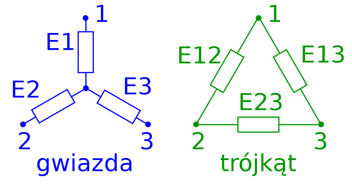

    Okay, I think I'm starting to understand about 1-phase receivers in a 3-phase network (let's assume symmetrical) P=√3 Uf*If
    And if not, we add both phases
    But I still have a question about the voltage distribution and the current in the triangle and in the star because it is a bit strange in my opinion, e.g. phase-to-phase voltage in the star or current in the star
    Understanding Power Formulas in Three-Phase Motors: P= √3 Uf*If vs P= Uf*If
    Let's say they are dynamos and they create electricity
    So when the star does it, the current goes through E1 and we have Current and Voltage Drop also phase-to-phase, why do we use phase-to-phase?
    And the right question is probably more why we measure both circuits, since if the current has no way to return, e.g. the motor goes such a current and it reaches the resistor, then if there is no 0, e.g. in a triangle, it goes back from phase 1 to phase 2? and in the star that when the current separates, it also returns to the phase? and this voltage drop in the star that phase eg 230 and between 400? then the same current from E1 goes through e.g. E2?

    In the triangle, when the current enters node 2, it spreads evenly to the receivers e12 e23.
    So the current entering node 2 is higher than the current flowing through these 2 receivers together by √3.

    Yes, but where does it return to its "-" because the current goes conventionally from + to -
    There is no permanent downside here. Minus constantly changes depending on the moment of time. And it depends on the other 2 phases.
    There is no - or + constant in three-phase current.

    Yes, but so that - in the phase where the current flows?

    There is no permanent minus, but there must be a closed circuit, so where is this lower potential where the current flows for a short while?
    In the video, I noticed that if the phase, say, F1 (red) is at its peak, the temporary minus is the phase F2 (yellow syringe) and F3 (blue syringe). I do not know how to put it in words so as not to offend anyone from the professionals here, but I will say that F2 consumes less power and F3 a little more and F1 only supplies current. Phase-to-phase and phase-to-phase voltages can be calculated.
    Am I a bit right here?

    Think of the receiver as a "black" box (symmetric, you don't know how it is paired, whether Δ or γ ;) . The general formula is 3x UfIf . If the receiver is Δ, so Uf = Up and the current Ip is greater than If by √3. If the load is γ then Uf is √3 smaller than Up and the line current is equal to the phase current.
    Therefore, the general formula for active power (for R) P = √3UpIp, and therefore general because it is easiest to implement, just measure Up and Ip of one phase and you have the total load power.
    Practice a bit on resistors (symmetric receiver) and you will see that no matter how you calculate the total power will always be the same.
